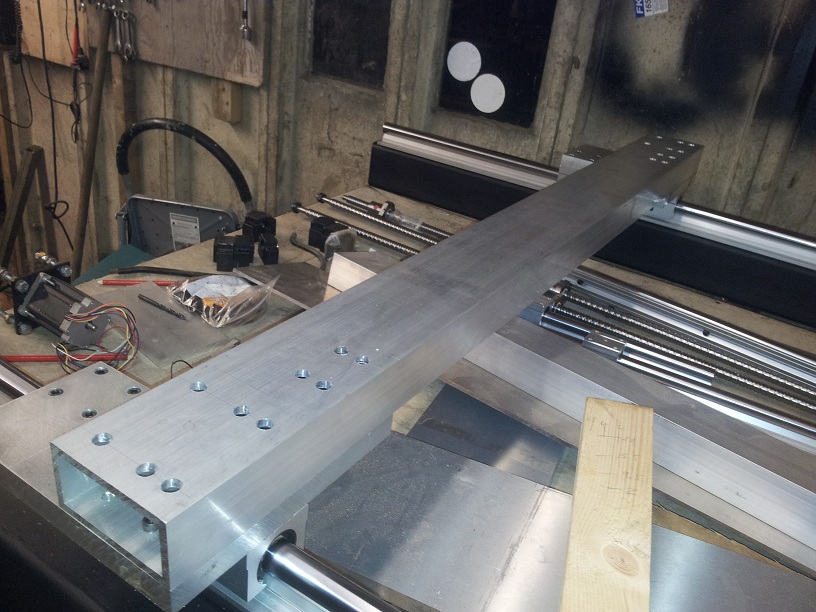

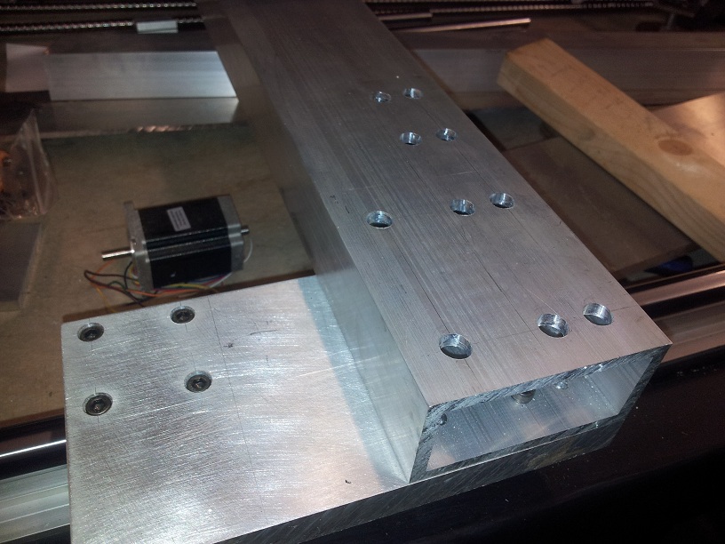

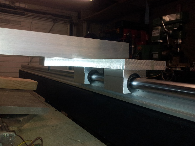

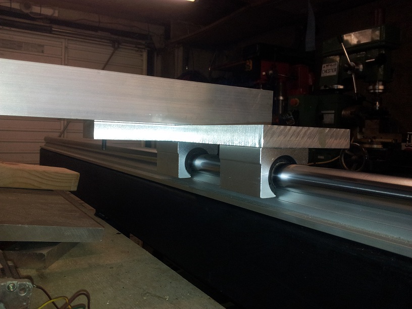

    happy new year all.
    back at work today. what a blur the past week has been.
    Didnt get as much done on this project as Id hoped. Spare time at christmas isnt what it used to be since we've had our first child. (18 months ago)
    But did get some done.

  4. #74
    Looking good! You've done more than me over the period, I was away all over Christmas so nothings happened :( Still best pull my finger out as only got 2 weekends free this month to work on my one.
    Neil...
    Build log...here
  5. #75

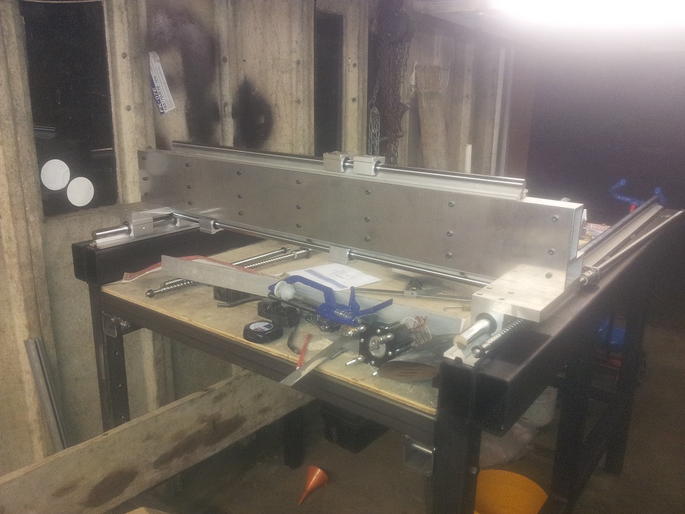

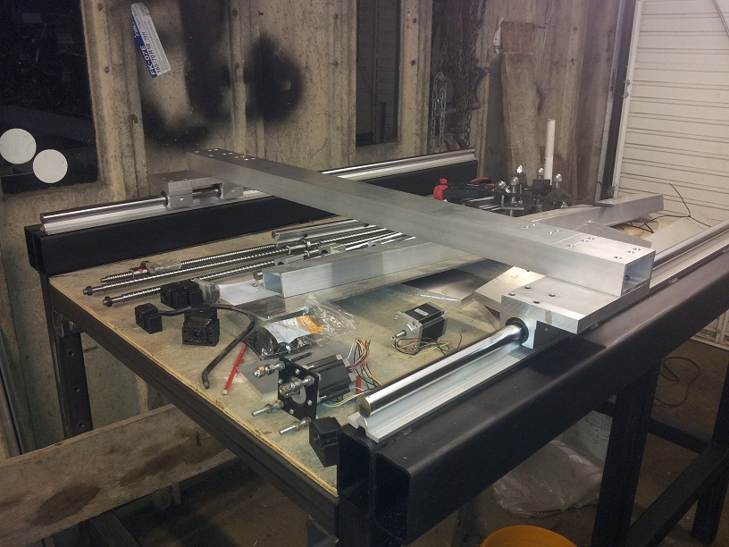

    bit more done... just taking my time... checking and checking again before drilling. and LOADS of tapping (thinking about training misses to do it)
    the gantry is now made; the bottom rail is only loosly bolted (need some shorter bolts)
    its only sat on the slider plates, as to bolt it to them it needs to be assembled in place..
    top rail just sat on top loosly

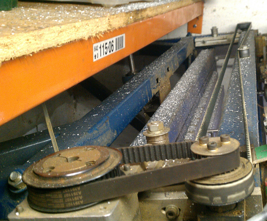

    Within JoeHarris's build log, JazzCNC points out that its not possible to get long belts in 15mm HTD flavour.(I also noticed this) His solution was to span the long length with a different flavour belt.
    (to be fair, probably the best solution). My plan was a little more un-thought out... My vision was to have dual steppers.. I had read in other build logs regarding the issue of missed steps but I hadnt really realised what this means... and disregarded it with a 'il worry about that later' attitude. The other reasoning behind this question is I ultimately would like to go down the spinning ballnut route ala Jonathons build. As Ive had the fear of god put through me regarding whip of the screws.
    However ive just read your post on JoeHarris's build thread the following
    No it doesn't go away but if the digital drive has a feature to monitor stall detection and send an alarm signal like the AM882 drive do then it's possible to use this to informthe control software to stop the machine and therefore the other motor before any damage is done.!! . . . . You'll still have lost steps and run out of position slightly but no damage is done.
    I have bought these motor controllers
    Cheap CNC! Wantai 4 PCS Stepper Motor Driver DQ860MA 80V 7.8A 256micro CNC Router Mill Cut Engraving Grind Foam Embroidery-in Motor Driver from Industry & Business on Aliexpress.com
    (4) of them
    Although I have a bob, it was one that come free with the above, I intend to buy another one when I have time to research the best one
    Its mentioned above, the problem over missed steps is less significant if you have stall detection.. but I bet the above (cheap) drivers dont have this... ive looked but dont really understand what im looking at. What would you do?
    1.)scrap idea of two steppers, and have an arrangement similar to that of the grand master above.. (im favouring)
    2.)keep the dual motors (as I have all the gear to hand) where there is one stepper for each of the two screws (the gantry is quite heavy!) but I guess this may entail buying the motor controllers to replace the above?
    I genuinly hope this isnt a stupid question.

    You can get open ended belt in any width up 30mm in HTD flavour. I used 5M HTD15 on my build of the reinforced polymer type. This works great but out of choice doing it again would stick with screws.
  10. #79
    I would keep the two steppers with the drivers you already have. I don't consider one stepper stalling and twisting the gantry to be an issue, since once you've set up the motors properly they will not stall. If they do stall then clearly having the stall detection feature is excellent, since it can prevent any damage, but the motors have no reason to stall so to me it's protecting against something that wont happen anyway. You also have more input power, since there are two motors, unless you use a reasonable size Nema 34 motor if just using one. With either system you always set the motors up such that they will never stall in normal operation, so you don't have to run it slower with two motors to play safe since if either configuration stalls it's set up wrong. Since you already have the drivers and motors(?) it doesn't really cost much to try it and plenty of people use either system. I don't have problems caused by having two motors.
    Jazz will now vote for option 1.
