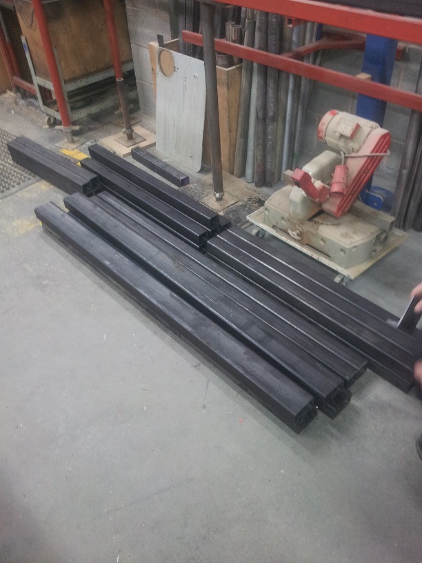

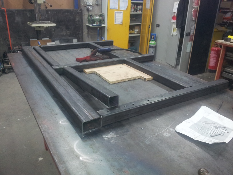

    Right then gents
    a productive day... Good friend of mine lent me the use of his unit... which was invaluable square warm space with all the kit to hand to make the job of making the frame easier.
    Not to mention a fork-lift to load it onto the trailer to bring it home!. My god its heavy.
    60x60x4 box & 60x100x5 box
    Very pleased with my welding.. Proud enough to upload a piccy. Got so used to welding on crappy tin underneath cars welding nice clean think steel was a dream!

    Looking good Julian, looks like your mates unit is the business!
    Welding up cars made of tin....I hear that, how comes you dubbled up on the top rails ?
    EDIT: Scrap that question just went back to post #31 for a recap !

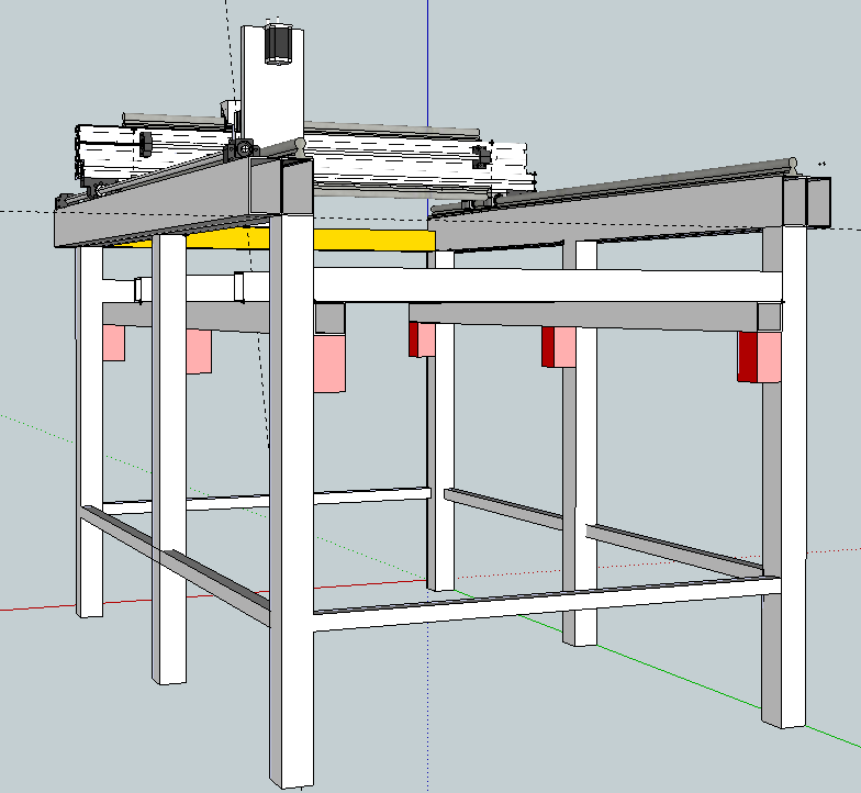

    ok taking on board jonathons comments; ive redesigned Y gantry to bring Z closer. feelings on this?
    ive also taken the sound advice of a very nice chap; who pointed out I should add some extra bracing at the top to reduce resonance; At present I can only guarentee space for the yellow peace... I need to think of a cunning place to put one at the other end. the obvious place would be between the two 60x100's however that is going to be RIGHT in the way
    Ive also added the red-blocks... the idea of this is to support the bed bolts further. Its suspected the bolts will move and the bed will constantly go out of true. Therefore the idea of these is to re-inforce.

    however, ive since had a brain wave.. stand back. the idea of the multiple holes on each leg is so the bed can be lifted and dropped. well... how about instead of the small red peaces; I have 6 metal peaces pre-cut same length per height adjustment... so imagine the red bit going all the way down to the horizontal cross bracing.. only drawback to this idea is that I need 6 bits per desired hieght; but the advatage is the plunge force onto the bed is directed down onto the horizontal beams (which in the drawing are represented as 30x30; when infact they are 60x60x4's
    eagle eyes amongst you will also notice ive switched the Z screws round (so the belt and stepper is at the other end).
