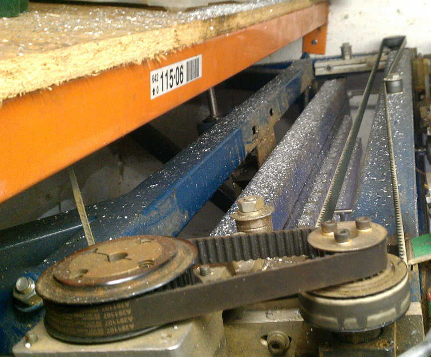

    Within JoeHarris's build log, JazzCNC points out that its not possible to get long belts in 15mm HTD flavour.(I also noticed this) His solution was to span the long length with a different flavour belt.

    (to be fair, probably the best solution). My plan was a little more un-thought out... My vision was to have dual steppers.. I had read in other build logs regarding the issue of missed steps but I hadnt really realised what this means... and disregarded it with a 'il worry about that later' attitude. The other reasoning behind this question is I ultimately would like to go down the spinning ballnut route ala Jonathons build. As Ive had the fear of god put through me regarding whip of the screws.

    Its mentioned above, the problem over missed steps is less significant if you have stall detection.. but I bet the above (cheap) drivers dont have this... ive looked but dont really understand what im looking at. What would you do?
    1.)scrap idea of two steppers, and have an arrangement similar to that of the grand master above.. (im favouring)
    2.)keep the dual motors (as I have all the gear to hand) where there is one stepper for each of the two screws (the gantry is quite heavy!) but I guess this may entail buying the motor controllers to replace the above?
    I genuinly hope this isnt a stupid question.

    I would keep the two steppers with the drivers you already have. I don't consider one stepper stalling and twisting the gantry to be an issue, since once you've set up the motors properly they will not stall. If they do stall then clearly having the stall detection feature is excellent, since it can prevent any damage, but the motors have no reason to stall so to me it's protecting against something that wont happen anyway. You also have more input power, since there are two motors, unless you use a reasonable size Nema 34 motor if just using one. With either system you always set the motors up such that they will never stall in normal operation, so you don't have to run it slower with two motors to play safe since if either configuration stalls it's set up wrong. Since you already have the drivers and motors(?) it doesn't really cost much to try it and plenty of people use either system. I don't have problems caused by having two motors.

    Won't go there regards stalling/racking has it's all been said.!! But there is more to this than just Stalling motors racking gantry's.?
    The Main reason why I like it is Synchronization.?
    My machine never loses position and the two ball-screws are synchronized exactly the same today has they were when first installed.
    I don't have to worry that on long Jobs the machine will lose sync has the slaved steppers drop the odd step here or there running out of sync with each other slowly racking the gantry.
    Don't have to worry that after 10-12 hours cutting I'm going to find that holes aren't where there supposed to be.!! Or the part isn't actually square after cutting profile out because the gantry slowly racked fraction of degree.!
    The only way to ensure slaved steppers stay in sync is to either have very accurate Home switches or Home to hard stop and do it often. Certainly after every Job to be safe.
    Even then if motors are tuned anywhere near close to the edge, esp regards Acceleration, they can easily lose steps without realising on jobs just a few hours long.
    On Jobs that run non stop for 10-12 plus hours like litho-pains this could and has been for some slaved stepper users disastrous often resulting in not just in in-accurate work but stalls thru accumulative error over hours.!
    Both work and won't argue that fact but I know which works best.!!

    I have never seen any evidence of stepper motors on any of my machines loosing 'the odd step'. If it did they would be practically useless - it's either stall and loose lots of step or run perfectly.
    If a motor does stall (which it wont if set properly) then it will only start moving when the step frequency has dropped to a low frequency, so it is possible to loose maybe a few steps (or tens of microsteps) if the motion is very small movements which constantly accelerate each motor, but that's still likely to damage the part whether it's one motor or two. Again, if the motors are tuned properly then, just like on Jazz's machine, you wont loose position so it doesn't matter if it's one motor or two. The only difference worth discussing is the input power considered with the whole system - if the basic calculations show that the motor and driver you can afford to use if just using one will perform better than the same calculation with two motors then go for it. If not it's illogical to use one.

    I must say however, I think wilfy's comment summerises my present thought chain. and as I have genuinely lost, Yes Lost. one of my 3 steppers it was a case of buying two more for the X axis anyway. So simplifying the bits you cant bite (ie the electronics) and only having to buy one (bigger) stepper & a longer belt & some pulleys seems to me a favourable way forward.
