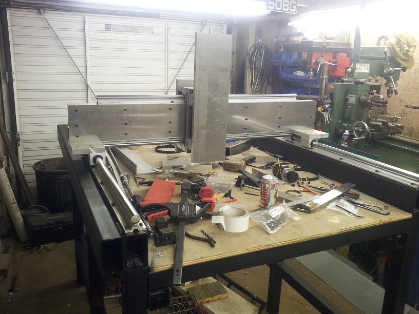

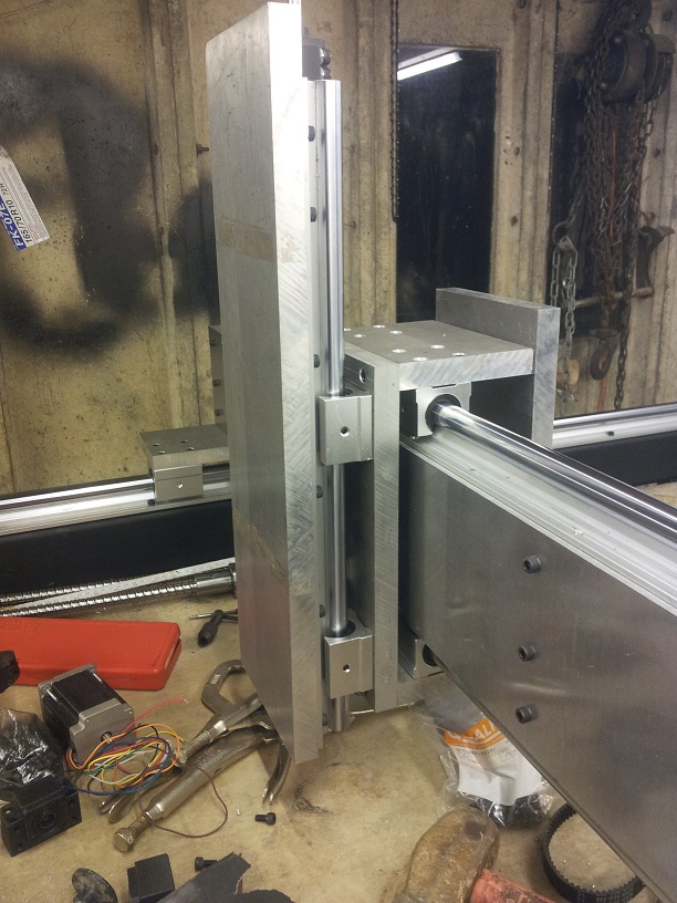

    Can anybody recommend anything else im going to need.... or wish I had?
    Looking good mate, I'm currently in a mexican standoff over clearing the garage out. :(
    You don't seem to have listed a spindle, bucket, water pump, hoses & clamps for water pump, limit switches, homing switches, cable for the switches, PC, software or any end mills?
    PS on the pics of your z-axis at the rear you have a few cm sticking up at the top. If you stick a couple of bits of aly in there bolted to either side it will add rigidity.
