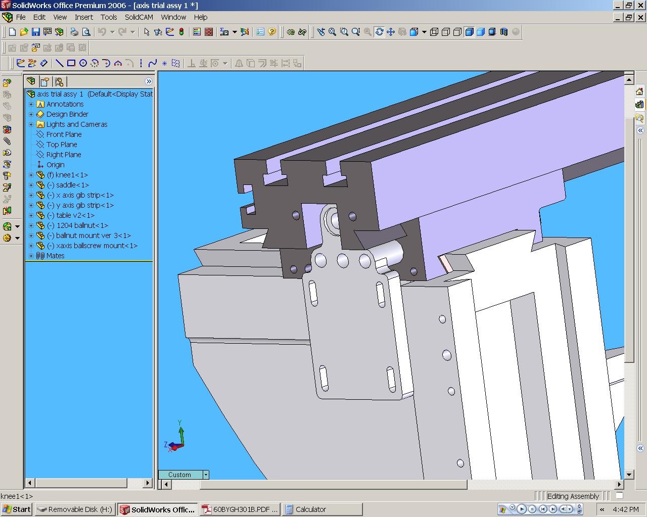

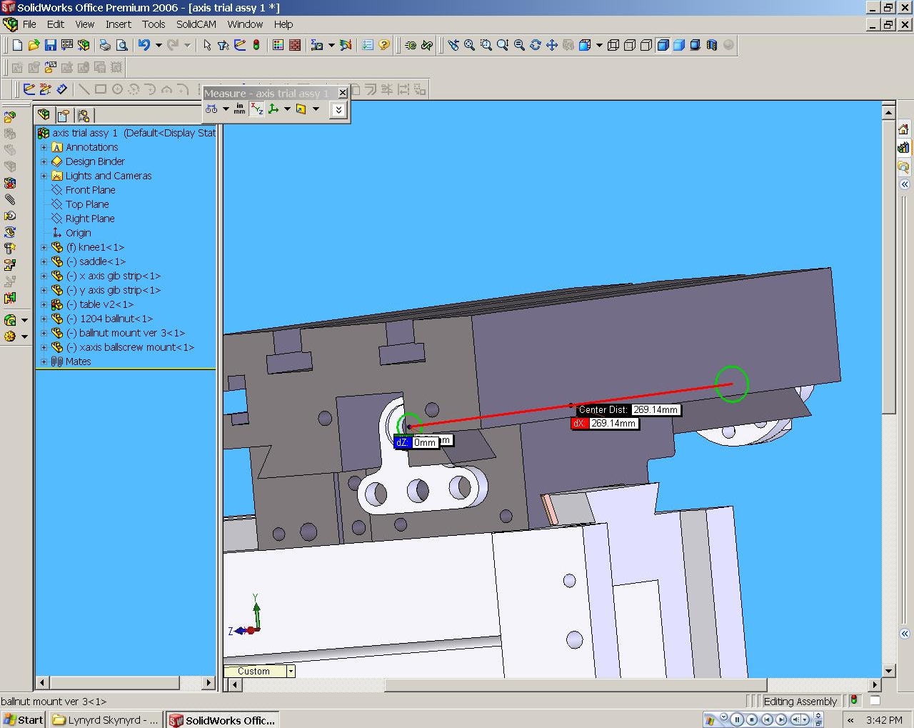

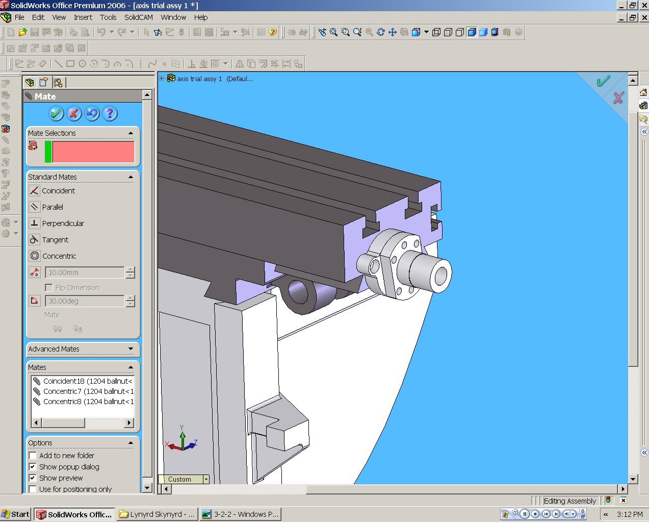

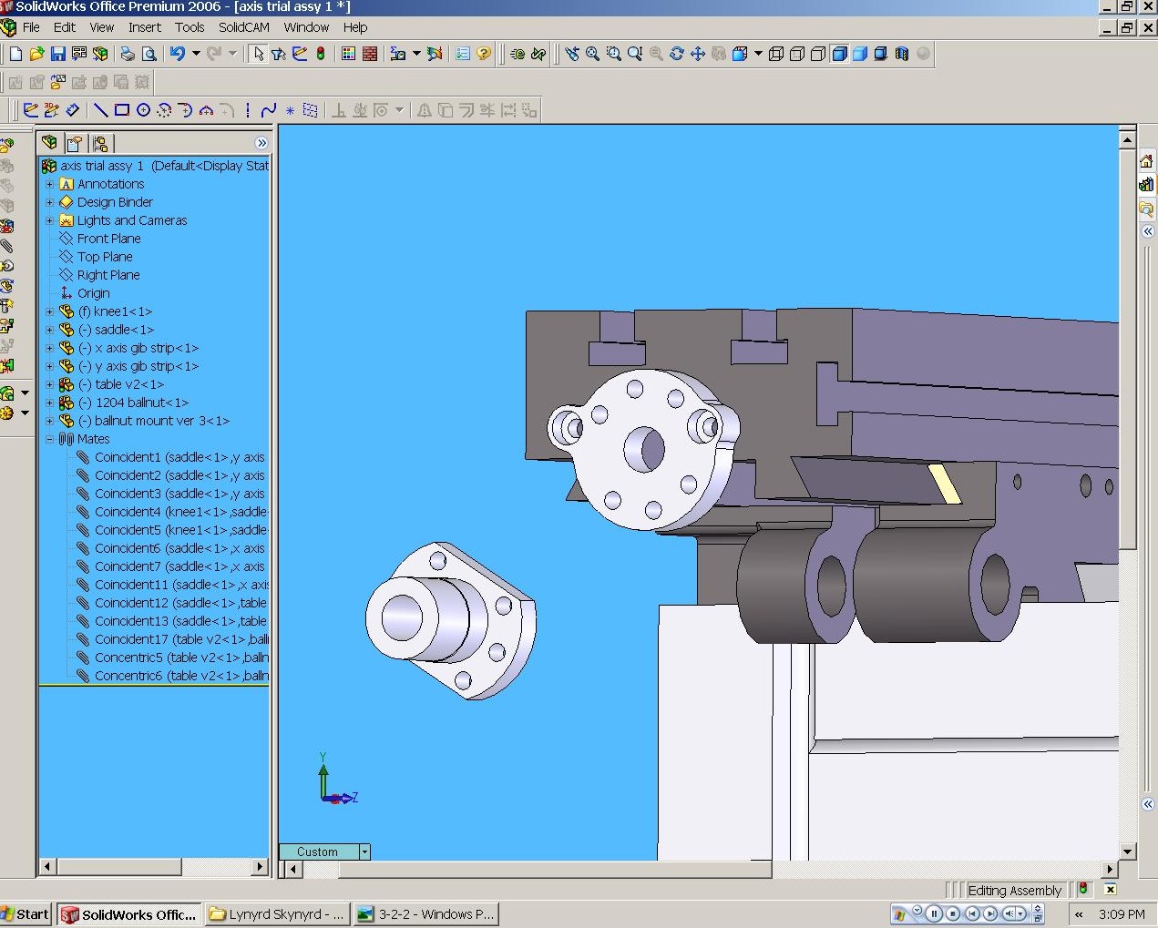

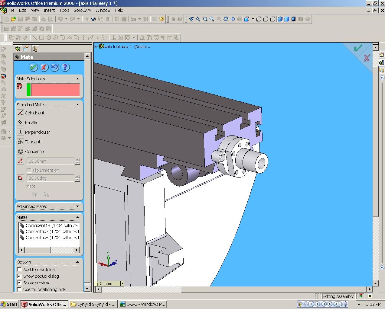

    i did a few drawings of my concept (has anyone seen this done before?)
    the first 2 show the ball nut and a mount i designed to utilize the original leadscrew mount holes
ID:	7068Click image for larger version.

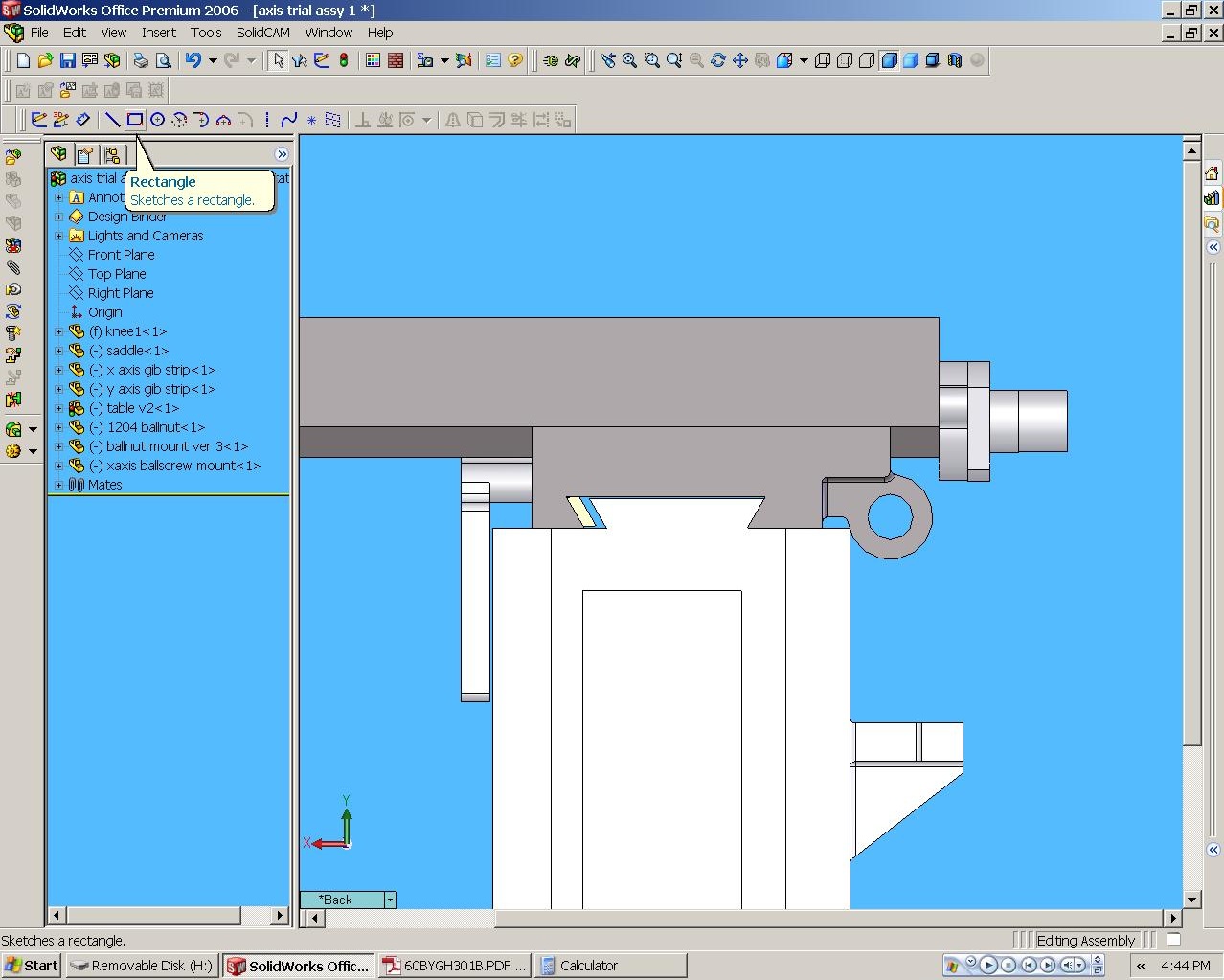

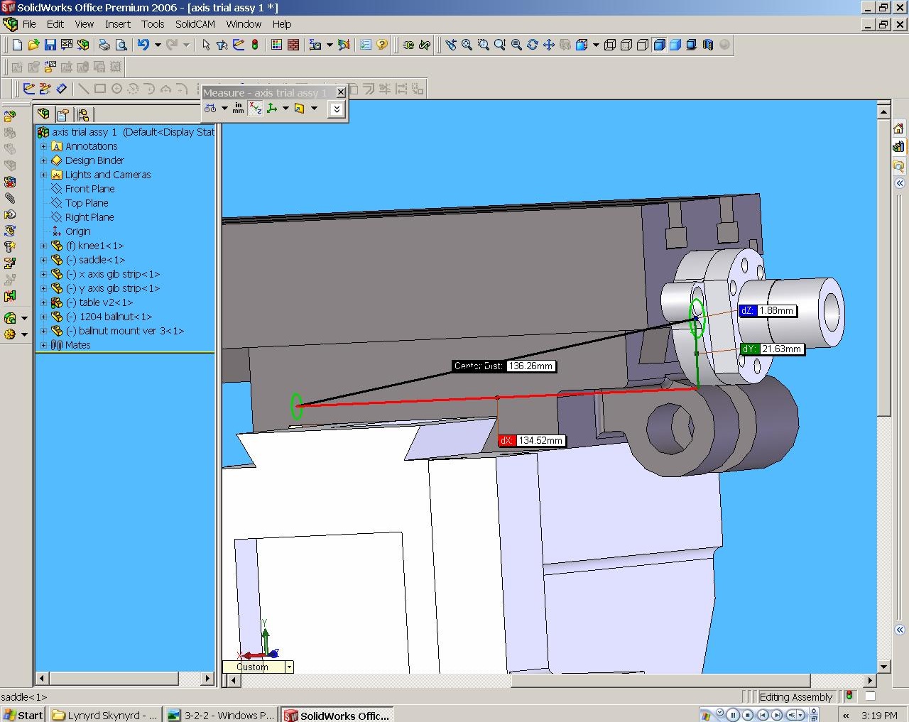

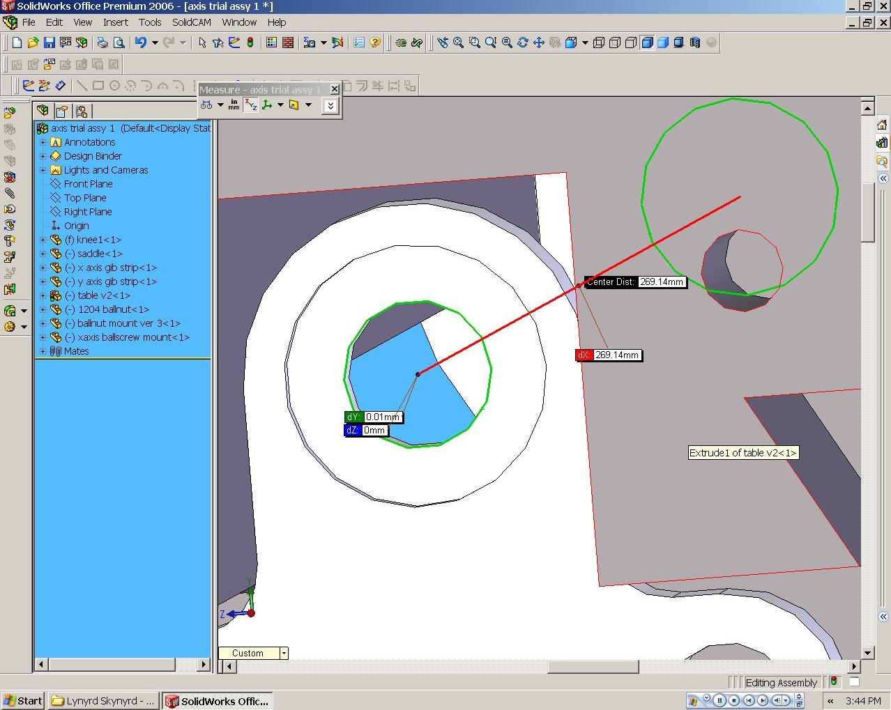

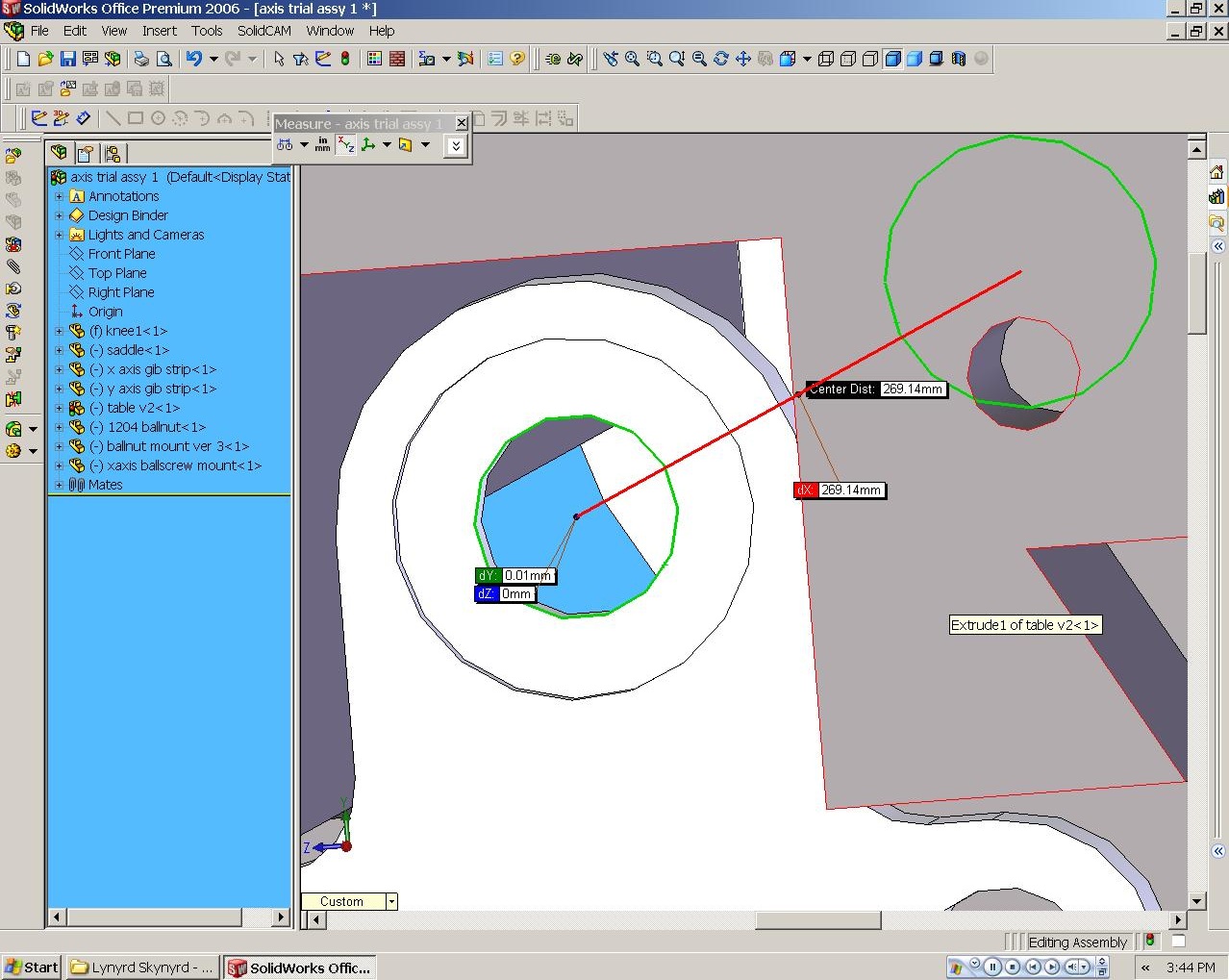

    i then proceeded to modify the old ballnut mount i designed into a ballscrew mount. notice how the new mounts are 0.01mm off concentric which i feel is negligible and with adjustment can be completely overcome

    the screw mount was then further modified to allow attachment of a stepper via pulleys. it was also extended to clear the lip at the back of the knee (see second pic below)
ID:	7073Click image for larger version.

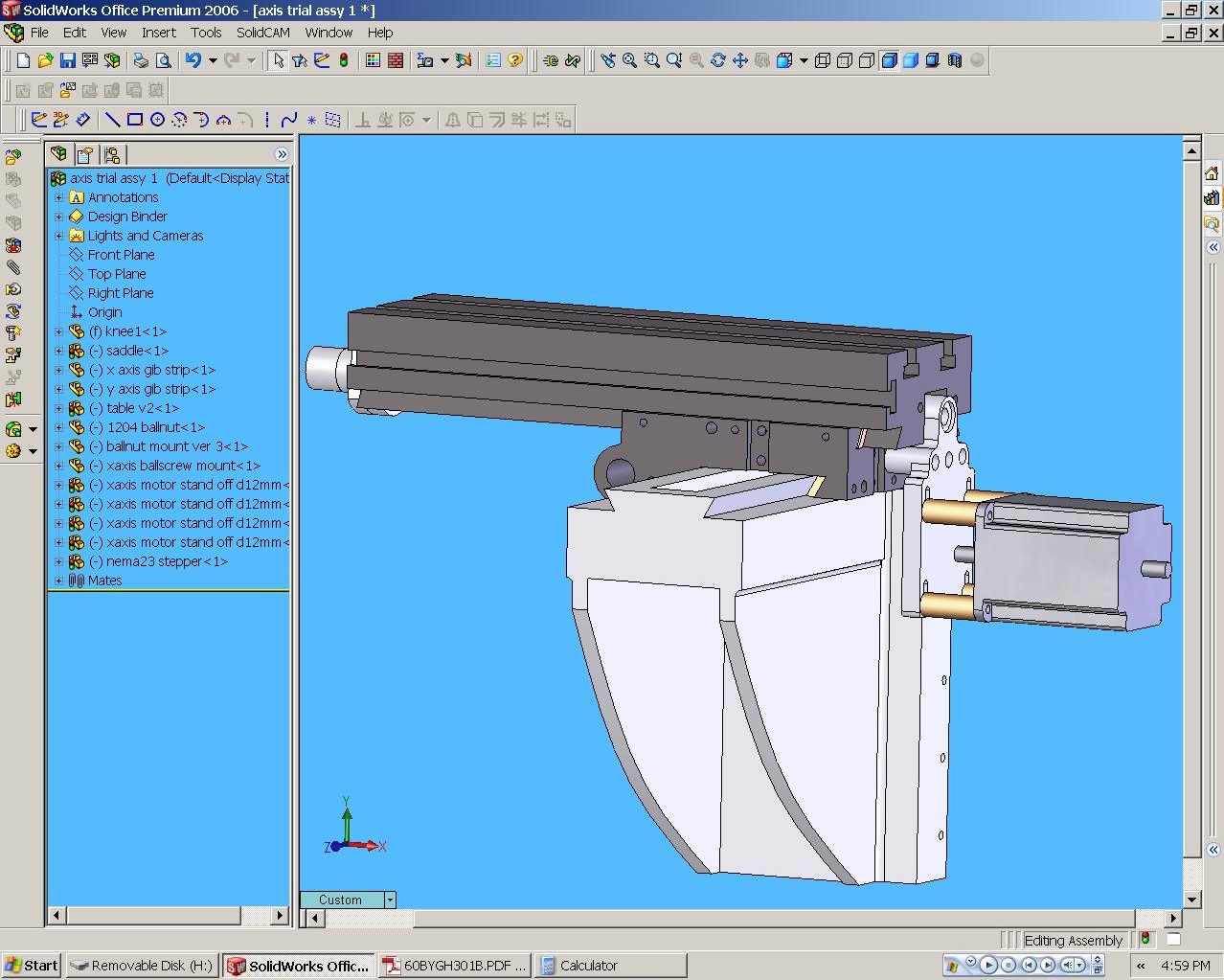

    and finally with a nema 23 added for good measure
    still have to draw some pulleys, a ballscrew and a few other components. more to come soon
    so...
    any critical thoughts on this design?
  10. #20
    I would mount the stepper motor to a block of aluminium since the posts are not particularly strong, wont conduct much heat from the motor and also look like a grandfather clock. Also you might have difficulty fitting the belt/pulley between two posts? It would certainly limit your choice of ratios.
    Probably negligent, but instead of making the ballnut mount match the circular profile of the nut, I'd make the mount closer to a rectangle so it fixes to a greater area of the bed since that should be stronger.
