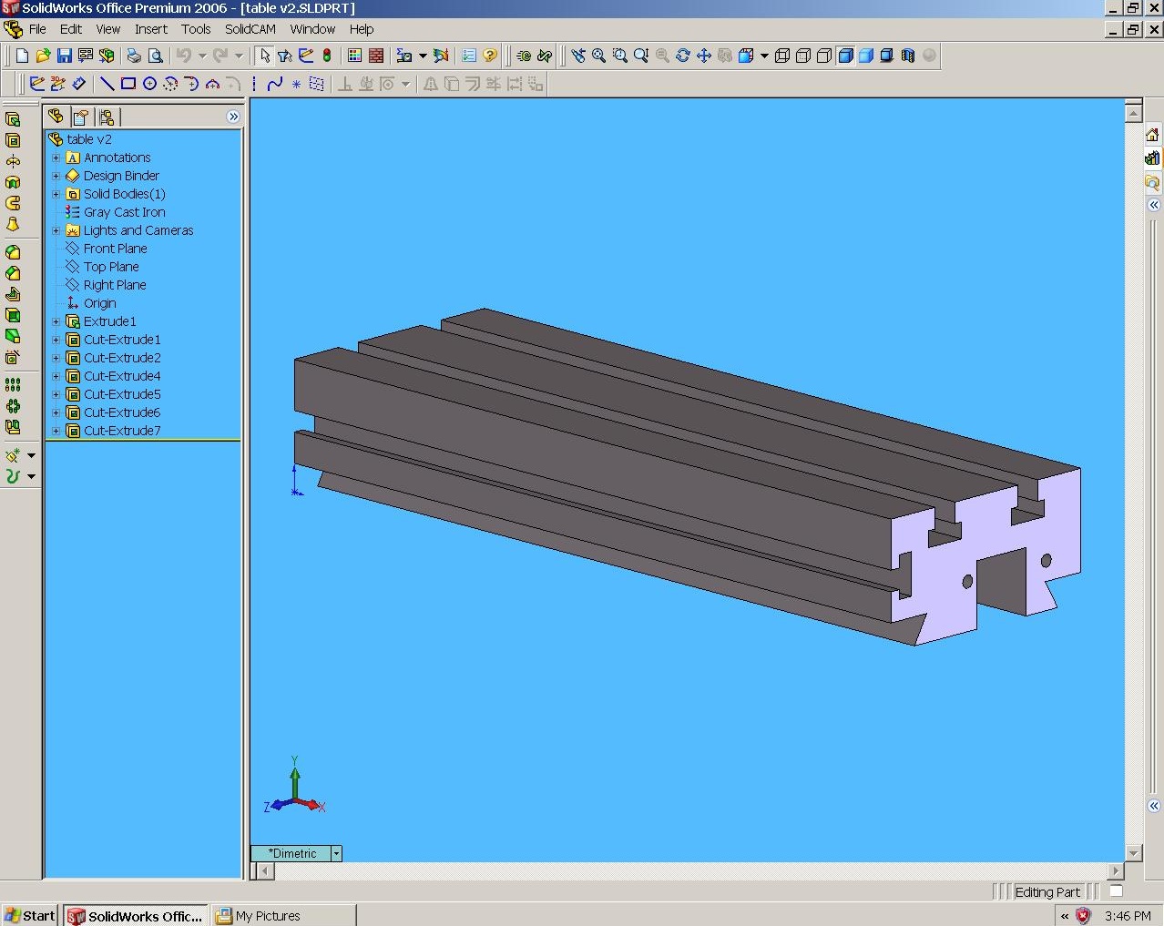

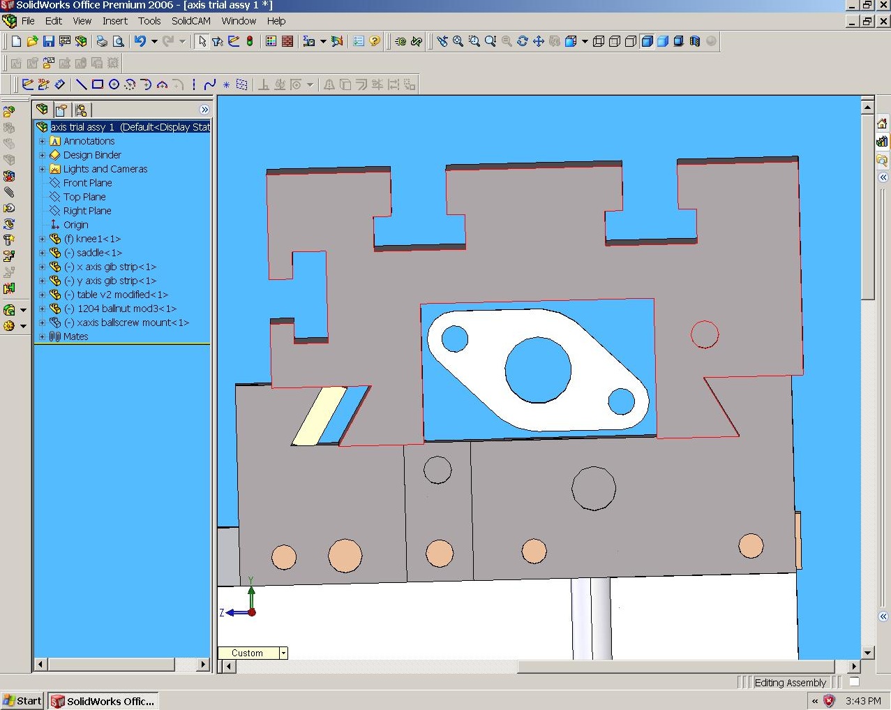

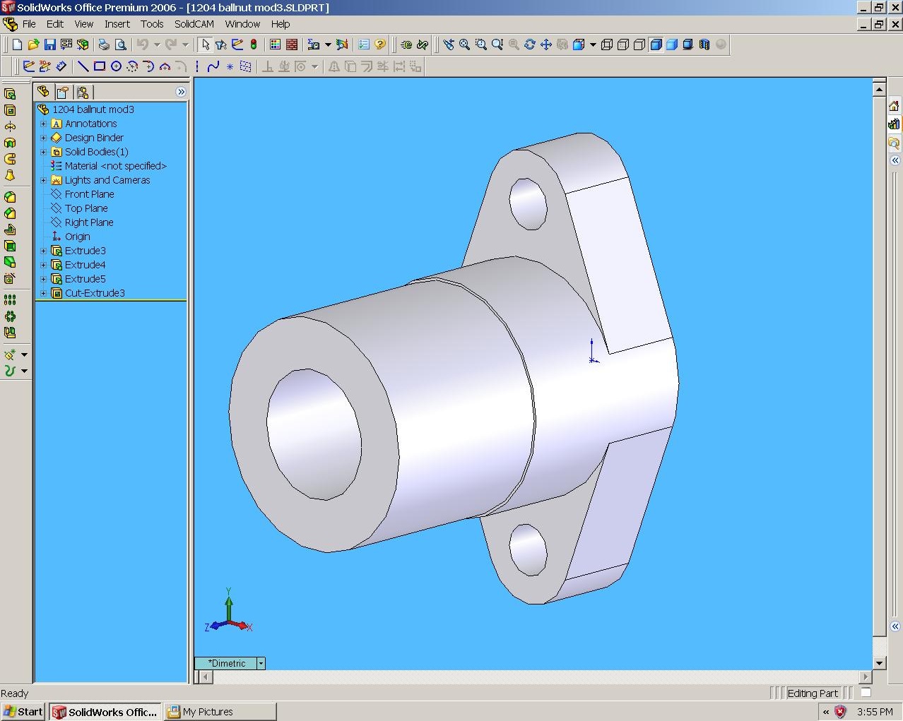

    im currently still at the planning stage for converting my centec 2 to cnc
    one major issue with converting this machine is the sheer lack of space under the table and to even squeeze a flange 1204 ballnut through requires major metal removal to both the table and ballnut
    since im not particularly happy about the amount of butchery necessary does anyone have any ideas on where to find smaller ballnuts for 8mm or 10mm screws that arn't twice the price of a 1605
    failing that, any other ideas?

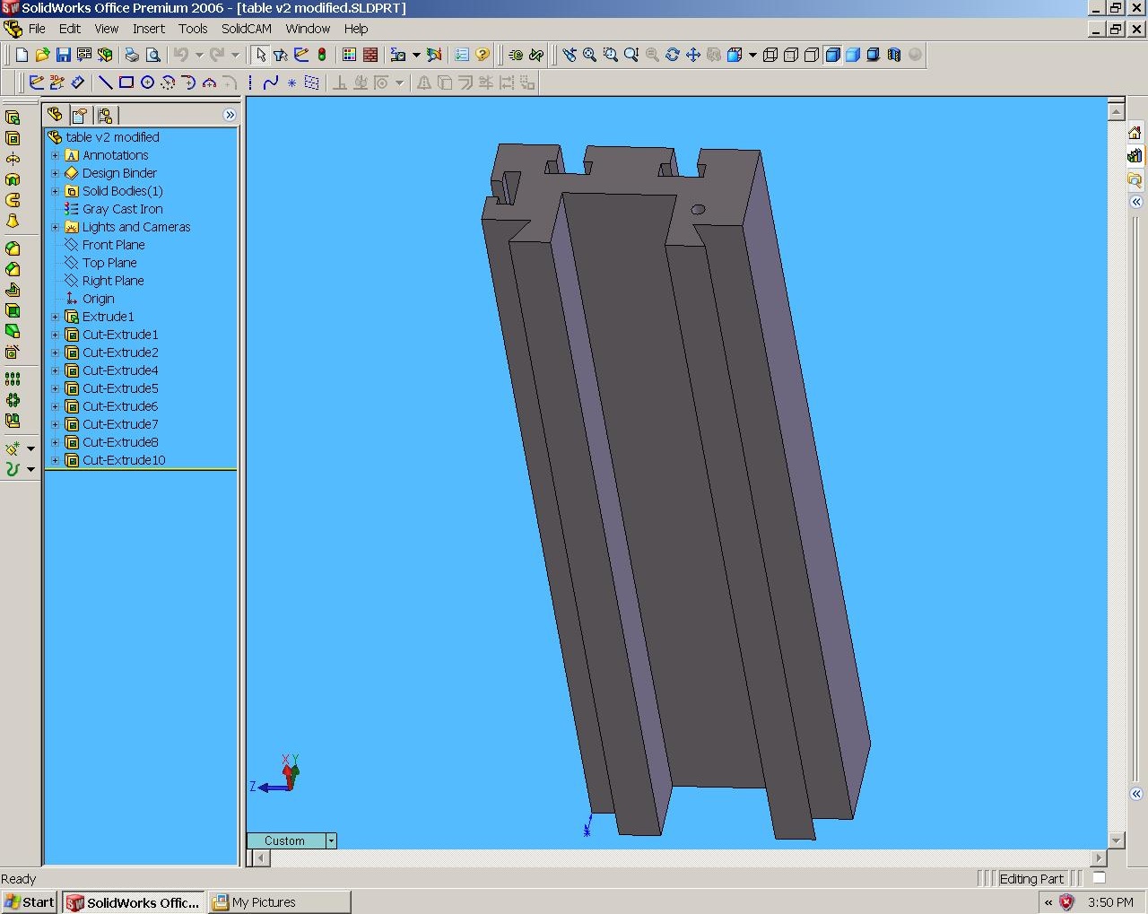

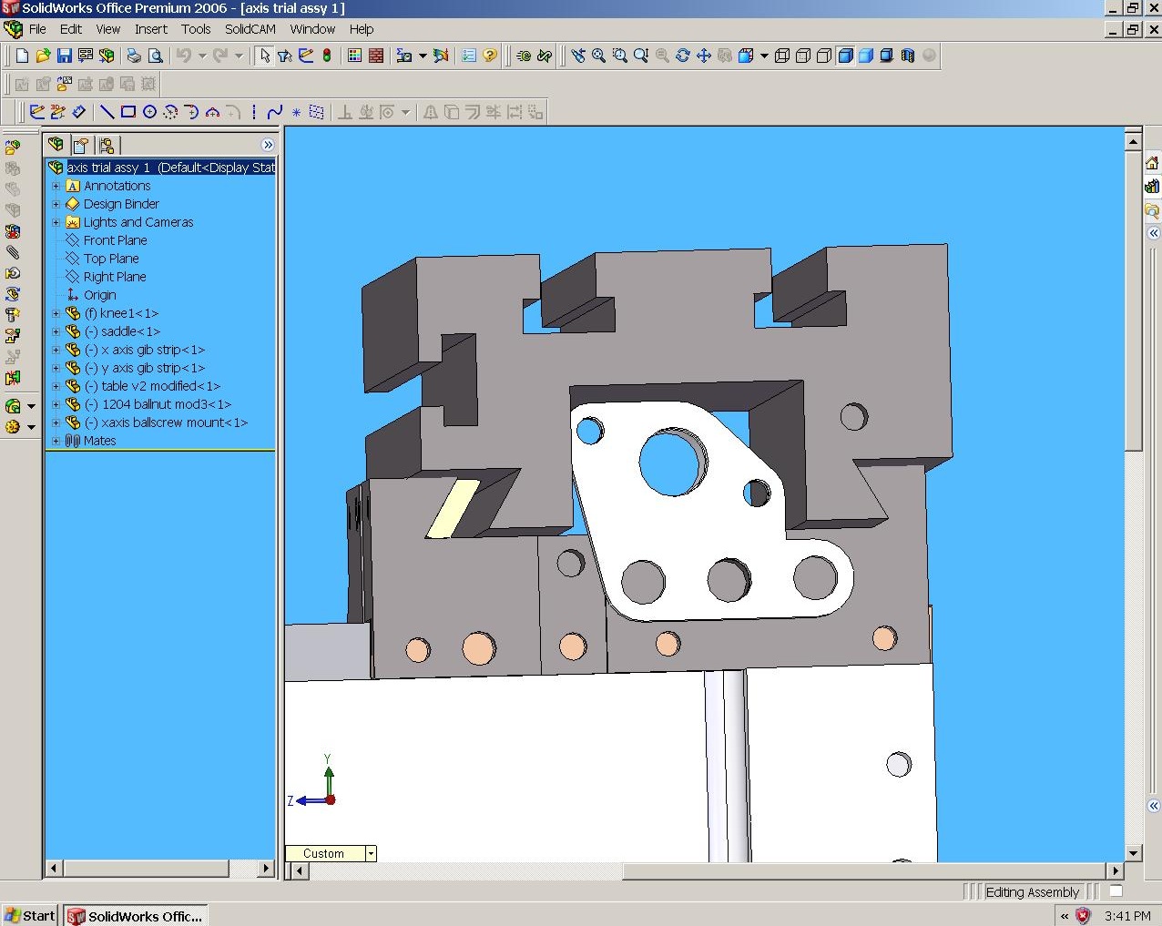

    i thought i would post some solidworks screen prints to better describe my predicament (i know you guys love a little bit of imagery )
    the first two is the standard table and the third shows how much material would need to be removed just to fit a chopped up 1204 nut in

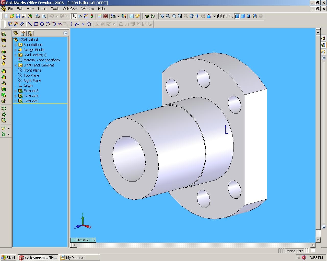

    here we have a 1204 nut before and after 'modification'

    just to show you the clearances involved

    The ballnuts from China are made from a fairly hard grade of steel. However I did check a RM1204 ballnut from Chai and I could file it, so you should be able to machine them.

    Could you not mount the ballscrew somewhere else, for instance to the front of the table perhaps using the convenient T-slot? It's clearly not as nice as having it under the table, since the force will be off centre and you'll need to protect it from swarf, but I don't think either of these are a big deal compared to what might happen if you mill that much out of the table. It wouldn't require modification to the machine in addition to being a lot cheaper.
