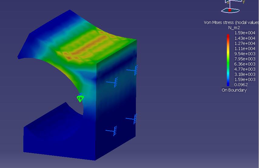

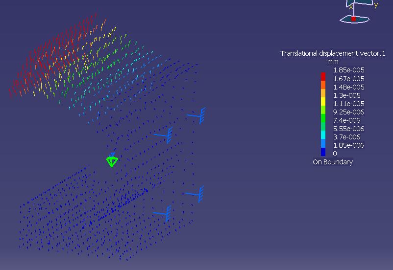

    I've answered previous posts on sideways mounted open bearings by pointing out that they will open up a bit with load in that direction. This time however I decided to carry out some stress analysis on a simplified part. The results were quite interesting.
    For a 16mm open bearing:
    1N load was applied vertically to inner bearing whilst restraining the outer face (the area you would clamp your gantry to).
    Displacement is 1.85e-5 mm, therefore 1.85e-5 mm/N.
    So for a 30kg gantry spread over 4 bearings thats 73 N per bearing, which is about 0.00136 mm or 1.36 microns.
    Initially that seemed pretty small so either there was an error in the calcs or I was worrying over nothing - but then realised that I should really model the supported rail and include that since I think it would be quite significant. Will have to wait for another night . . .
    Here are the pretty pictures for the open bearing under 1N vertical load. Stress on the left in N/m2 and deflection on the right in mm.
    Attachment 6986Attachment 6987

    The software is called Catia V5 made by Dassault. It is a very powerful piece of software designed for high end use, and very expensive. FEA is just one small part of the software.
    I'm sure there are cheaper packages out there which will do the FEA part of the job - on simple parts at least.
    It will also do modal analysis although I've not used it for that.
