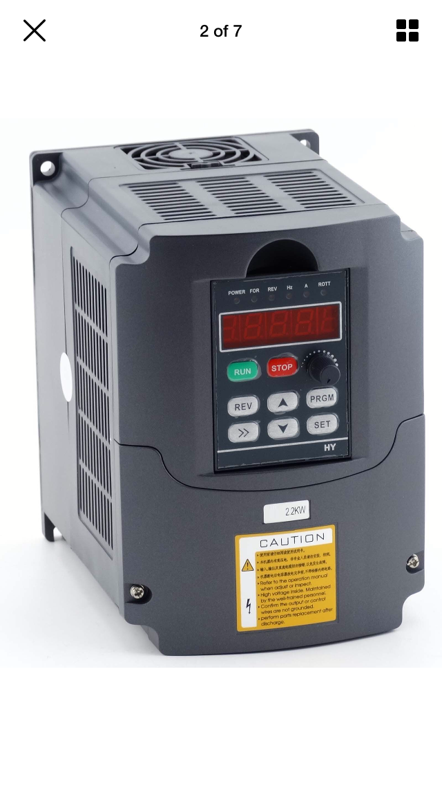

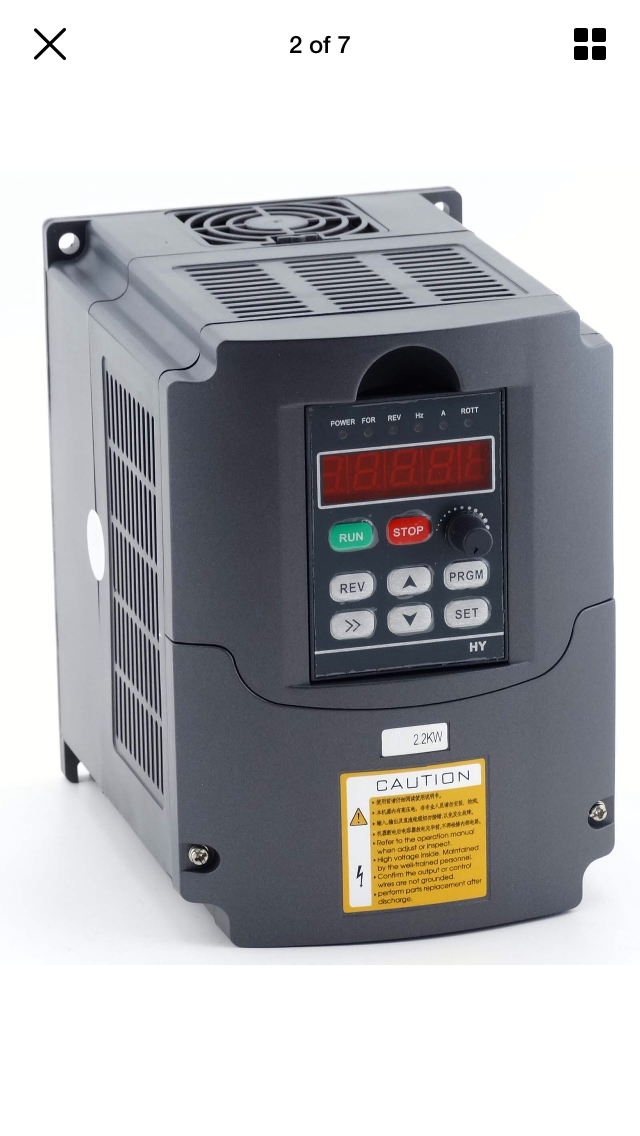

    Hi, does anyone know how to wire Huanyang HY02D223B?
    I've bought this and 67 manual fail to provide simple information where to connect L -( live) N - ( neutral) and earth.
    My house is supplied with 230V 50-60Hz and has Brown wire as L live , Blue as N neutral and Yellow/ green as Earth.
    Many thanks. Stan

    Near the start of the manual is a page with the description of the terminals. This tells you how to connect the input supply for three phase and single phase. The input supply for single and three phase is connected to the R S T terminals.

    Hi, thanks for replying,
    Yes you are correct what comes to manual and wiring there.
    But real life is different.
    I can connect L to any Of R or S or T.
    earth goes obviously to E(9)
    But where goes N ( neutral)
    I can't connect it to R S or T, those are phases only.
    It tripped my fuse, twice.
    Thanks for replying .

    Stan I think your just getting mixed up with the terminology and the wording in the manual. The VFD will work on single phase, phase and neutral supply, or three phase, three single phases without neutral.
    For your single phase supply to work you need to connect your Live and Neutral connections to two of the three connections R,S,T. Also connect the earth to the correct terminal.
