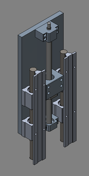

    Well I've managed to restructure my Z Axis. I've had to compromise on the travel to space out the linear bearings a bit more. But hopefully it should now be a bit more rigid. I've also swapped the bearings onto the stationary back plate and moved the rails onto the moving part. I've also been able to shave about 20mm off the width too. It's now approx 160mm wide by 330mm high with 150mm of travel. I don't really want to go less than 150mm of travel. I suppose the I could always add longer rails at a later stage if I ever really need that extra travel, and could also then move the bearings even further apart. Lesson number one learnt, design the bloody thing before you order the parts!
    Now to start looking at connecting it to the Y axis. Thanks all for clearing that one up.

    No easy way to say this but your Z axis looks particularly -er- "unlikely". I think you may be just about to make a big mistake.
    Basically, the fixed part of the Z above the bed should be at max material thickness + a tadge for clearance.
    The Z axis travel should be max material thickness + max tool length + a tadge for clearance.
    Do not over-estimate these maximums because you think it will limit the machine. Over-estimation leads to overhangs that will weaken it so much it may not want to cut anything harder than cheese.
    OTOH I haven't read the whole of this thread. If you are planning on cutting foam patterns with a 6" tool it looks fine and dandy apart from the minimal vertical separation on the Z blocks.

    Picking my design up again as I have a bit more spare time on my hands. How do I work out my maximum tool length? Would this be the amount of end mill sticking out of the spindle? I'm hoping to get 150mm material thickness, is this wishful thinking? Going from what Robin suggests I take it therefore that I'll need 150mm from bottom of fixed z axis plate + tadge (say 5mm) assuming endmill protrudes 50mm out of spindle does this mean I'll need 205mm of travel?
