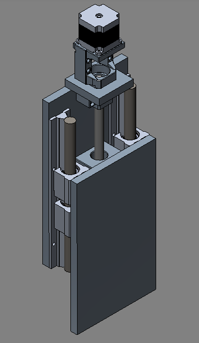

    I've finished an initial design of my Z axis which seems to look ok to me, but being new to this thought I'd best load it up and let you guys have a look. Please offer up any improvements that you think I need to do.
    Oh and if anyone needs any easy to use design software and uses a mac, I recommend Inventor Fusion which is what I created this in and it's free! Last week I had no experience of CAD packages and I've already managed to create something useful, and it animates! Now if I can figure out how to upload it....

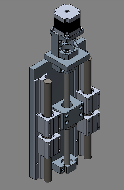

    I've managed to figure out how to create a picture from my CAD package, so here it is. Z axis version 1! To be honest I'm not 100% happy with it, mainly due to the width of the plate that the spindle will attach to, I'll have a re-think, but I think I have good base to work from.

  7. Usual comment. Mount the bearing blocks as far apart as possible on the fixed part and the (longer) rails on the moving bit. Gives more rigidity as the bearing blocks can be further apart for the same amount of travel and relatively small increase in cost.
    Was just about to order some aluminium plate to start building my z axis. Had a bit of a panic. Is 15mm thick enough or would I be better off using 20mm for the sliding part and the back plate?
    Quote Originally Posted by hoppo View Post
    Do you know if that applies to the sides too?
    It would certainly help, but even better would be to lower the gantry as much as you can and have the tool operating below the level of the X-rails.
    15mm is OK, but most use 20mm as you don't gain much by going above 20mm. In the whole scheme of things it's not going to cost too much for the extra 5mm...
    In answer to an earlier question - standard 6082 is fine for supported rails. Tooling plate is only really worthwhile for proper linear guides.
