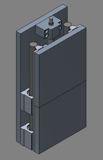

    I've finished an initial design of my Z axis which seems to look ok to me, but being new to this thought I'd best load it up and let you guys have a look. Please offer up any improvements that you think I need to do.
    Oh and if anyone needs any easy to use design software and uses a mac, I recommend Inventor Fusion which is what I created this in and it's free! Last week I had no experience of CAD packages and I've already managed to create something useful, and it animates! Now if I can figure out how to upload it....

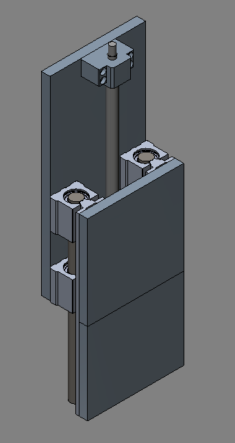

    I've managed to figure out how to create a picture from my CAD package, so here it is. Z axis version 1! To be honest I'm not 100% happy with it, mainly due to the width of the plate that the spindle will attach to, I'll have a re-think, but I think I have good base to work from.

  7. Usual comment. Mount the bearing blocks as far apart as possible on the fixed part and the (longer) rails on the moving bit. Gives more rigidity as the bearing blocks can be further apart for the same amount of travel and relatively small increase in cost.

    Well I've managed to restructure my Z Axis. I've had to compromise on the travel to space out the linear bearings a bit more. But hopefully it should now be a bit more rigid. I've also swapped the bearings onto the stationary back plate and moved the rails onto the moving part. I've also been able to shave about 20mm off the width too. It's now approx 160mm wide by 330mm high with 150mm of travel. I don't really want to go less than 150mm of travel. I suppose the I could always add longer rails at a later stage if I ever really need that extra travel, and could also then move the bearings even further apart. Lesson number one learnt, design the bloody thing before you order the parts!
    Now to start looking at connecting it to the Y axis. Thanks all for clearing that one up.
