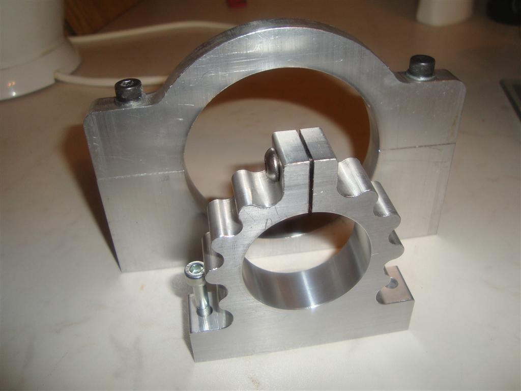

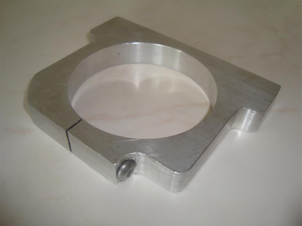

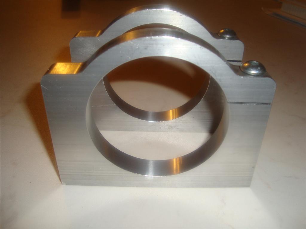

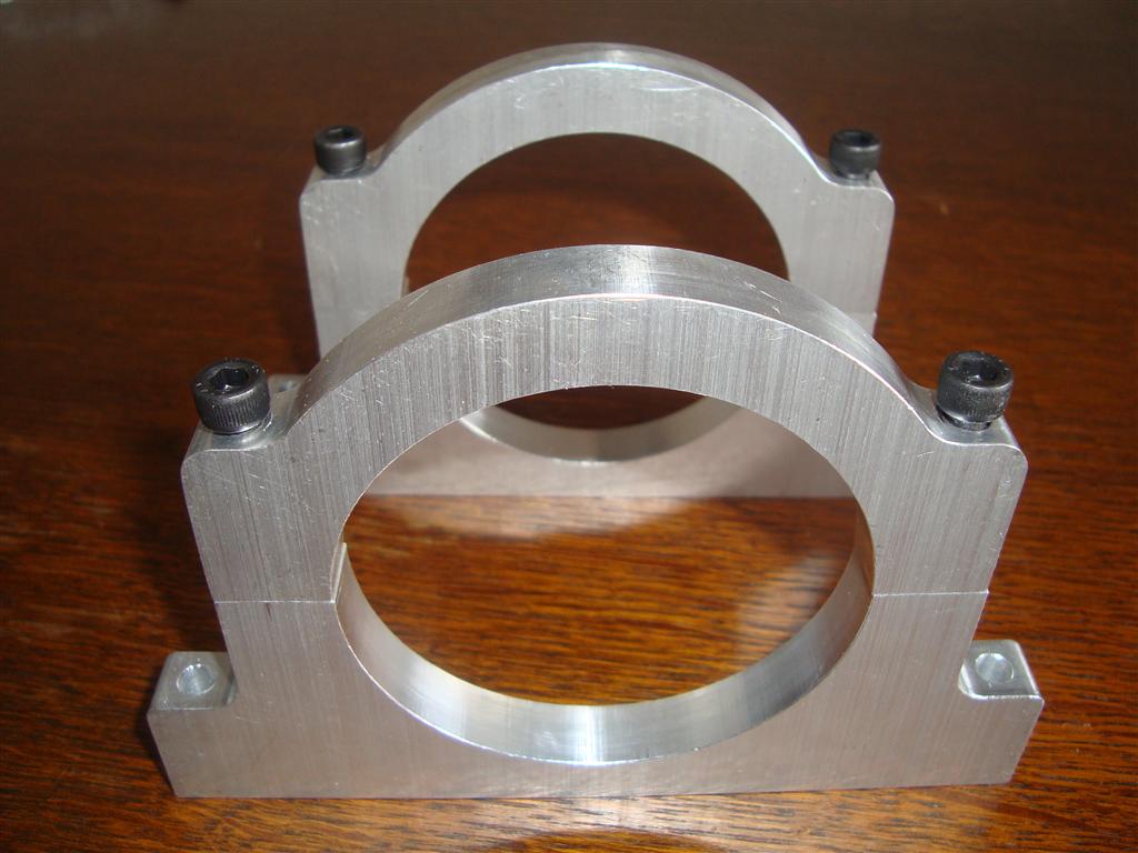

    Are they from chai jonathan? As when I asked him last week if he could supply he said no :(
    Sees spindle/motor mounts and wants ;-)

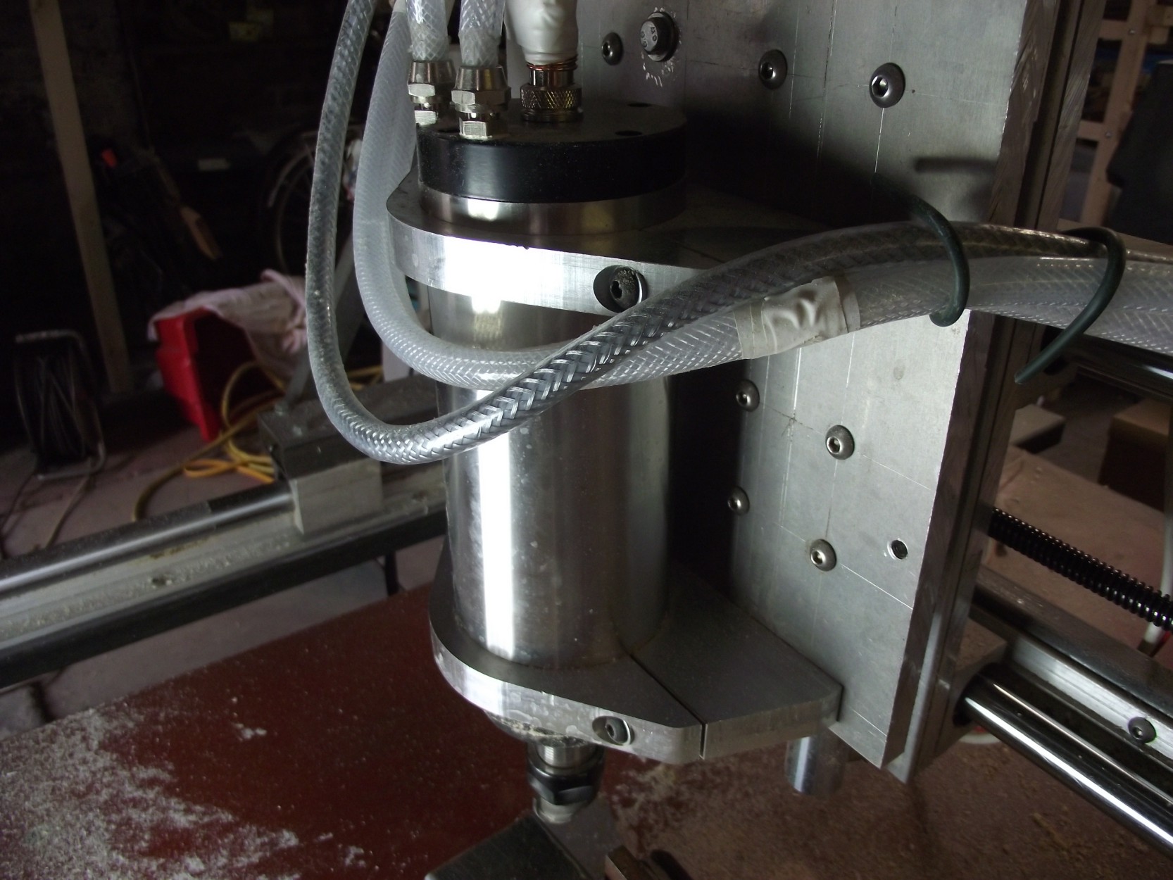

    If you're selling those Jonathan and can take paypal, don't be shy and send me a PM (2.2Kw water cooled spindle 80mm dia attaching to a 160mm wide Z plate BTW) :-)
    I'm guessing thise mounts are from Jonathan DC
    Yes they're all ones I've made. I need to make one for someone else on the forum asap, but I'm very short for time currently since I'm at university and have another project that needs finishing. However if I can make a few to the same design that would be pretty efficient...the one in the second photo from the left is easiest if made from 1/2" thick aluminium, to this drawing (can change the hole spacing if required):
