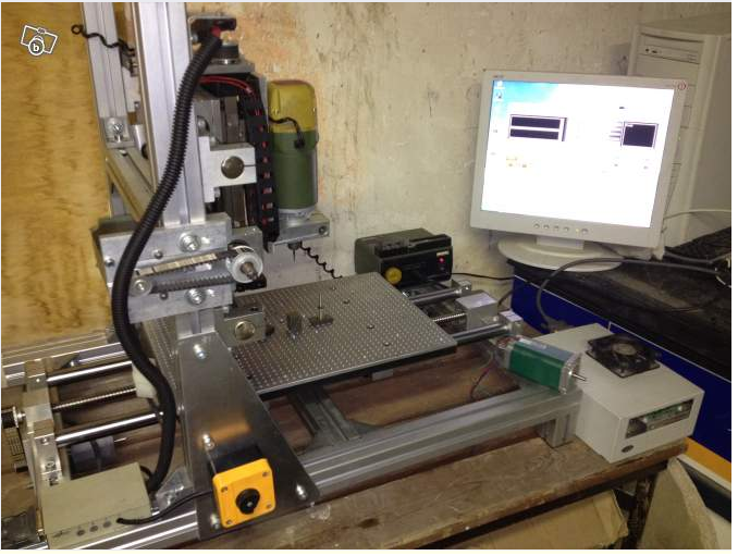

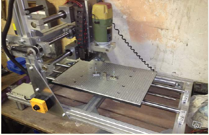

    That gives me some hope. I have managed to get the price down to 1400 euros now. (considering it going to cost him 200 euros to send it to me) . I am still considering the Chinese 6040 with 2.2kw wc Spindle. But I just don't like the idea of that. Everything I have ever bought from China needs bits replacing every other month.
    By looking at the Picture I have posted earlier in this thread, would you say changing those rails is possible without major work or fabrication (it is just bolt on parts) ? What sort of money are we talking of here ?

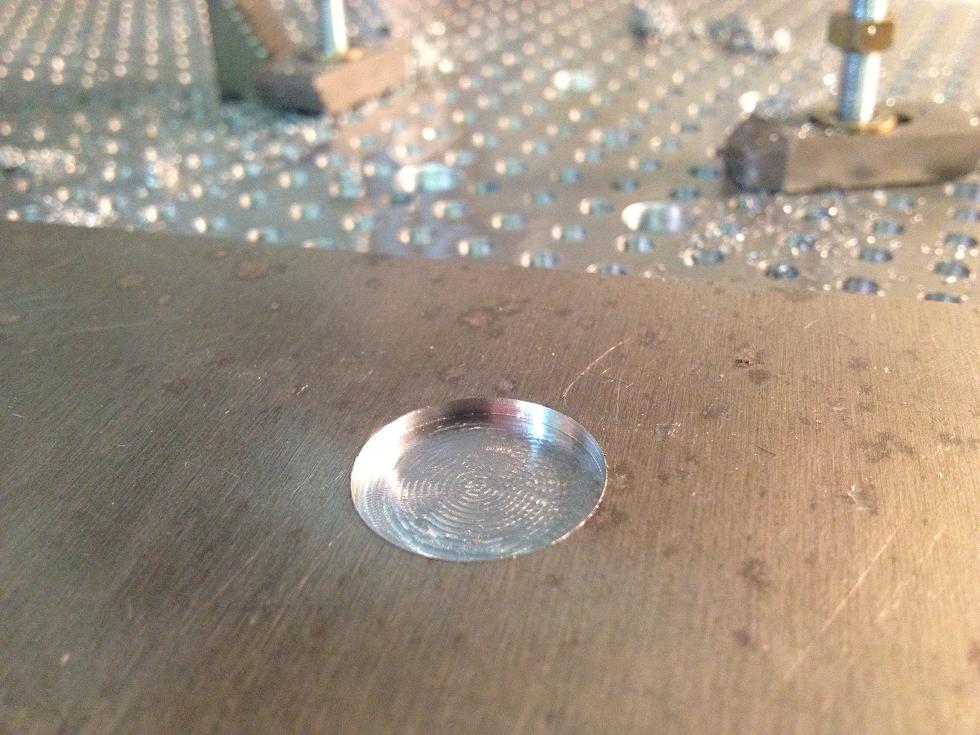

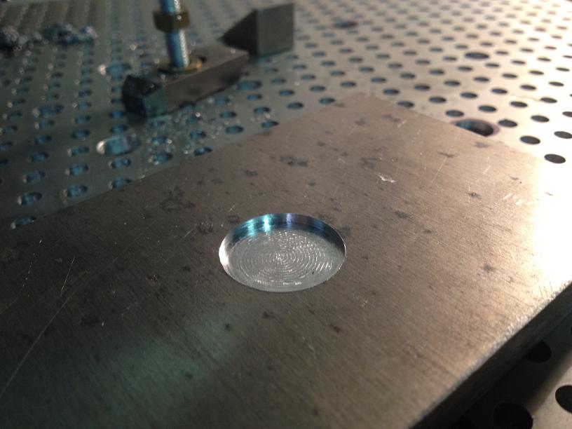

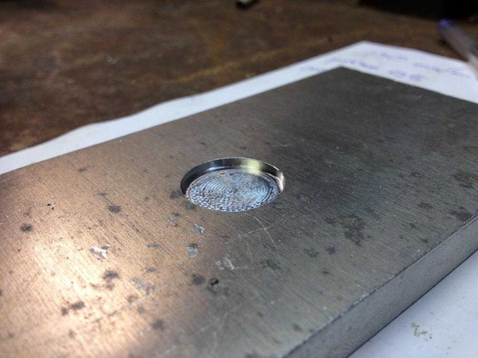

    Ok, he has sent me a photo of ali he has machined today. Youtube video later today I'm told. I might then get to see some of what this machine is capable of.
  7. Hard to tell from the resolution of the picture but seems to me the finish is useable but not great. Would be interesting to see the video and get some idea of the machining time and the tooling used.

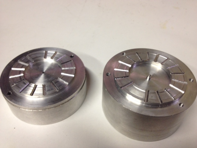

ID:	7281Click image for larger version.
ID:	7282Click image for larger version.

    I have chosen to buy this machine. I know it would have been better to build one for the amount of money spent, but I wanted a working machine that I could improve as I go. I understand it is never going to be a high performer.
    My question is please.....do I buy a Kress 1050 FME to replace the very underpowered 250w spindle that exists on the machine, or do I change the Z plate and buy a Chinese water cooled 2.2kw spindle ?
    Is there anyone online who fabricates and sells the Z plates/clamps to make the Chinese spindle fit my machine ?
