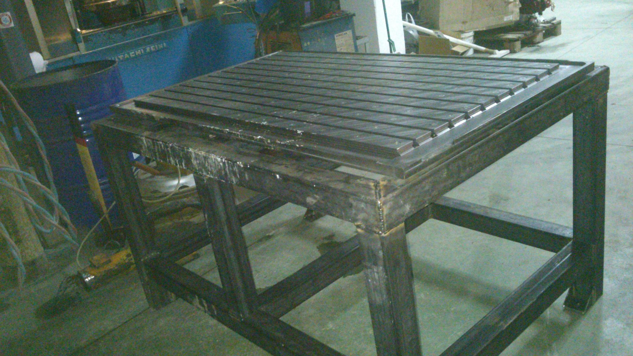

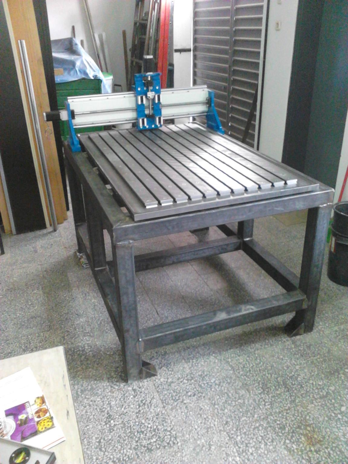

    I have made a big progress with my CNC.
    The worktable is finished and the construction is welded. It is night so I couldn't make better picture, but in few days I'll post more work progress. Everything is made of steal. Tubes are 80mm x 80mm x 4mm. The worktable is machined from steal.
    Overall weight ~ 500KG

    That is one hell of a substantial frame and bed, I can see why it weighs 500Kg, great job , pity the pigeon's have shit all down it though
  8. #38
    ahahahahahah it is not from pigeon. It rolled over on the concrete while we tried to turn it up side down :D

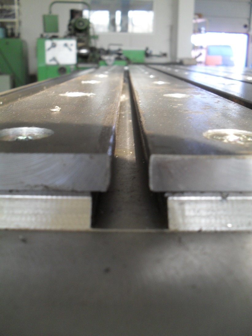

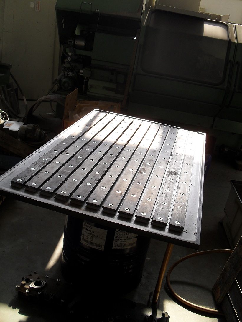

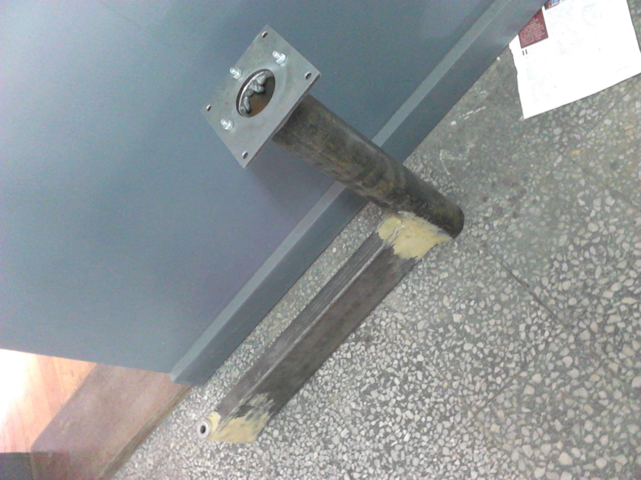

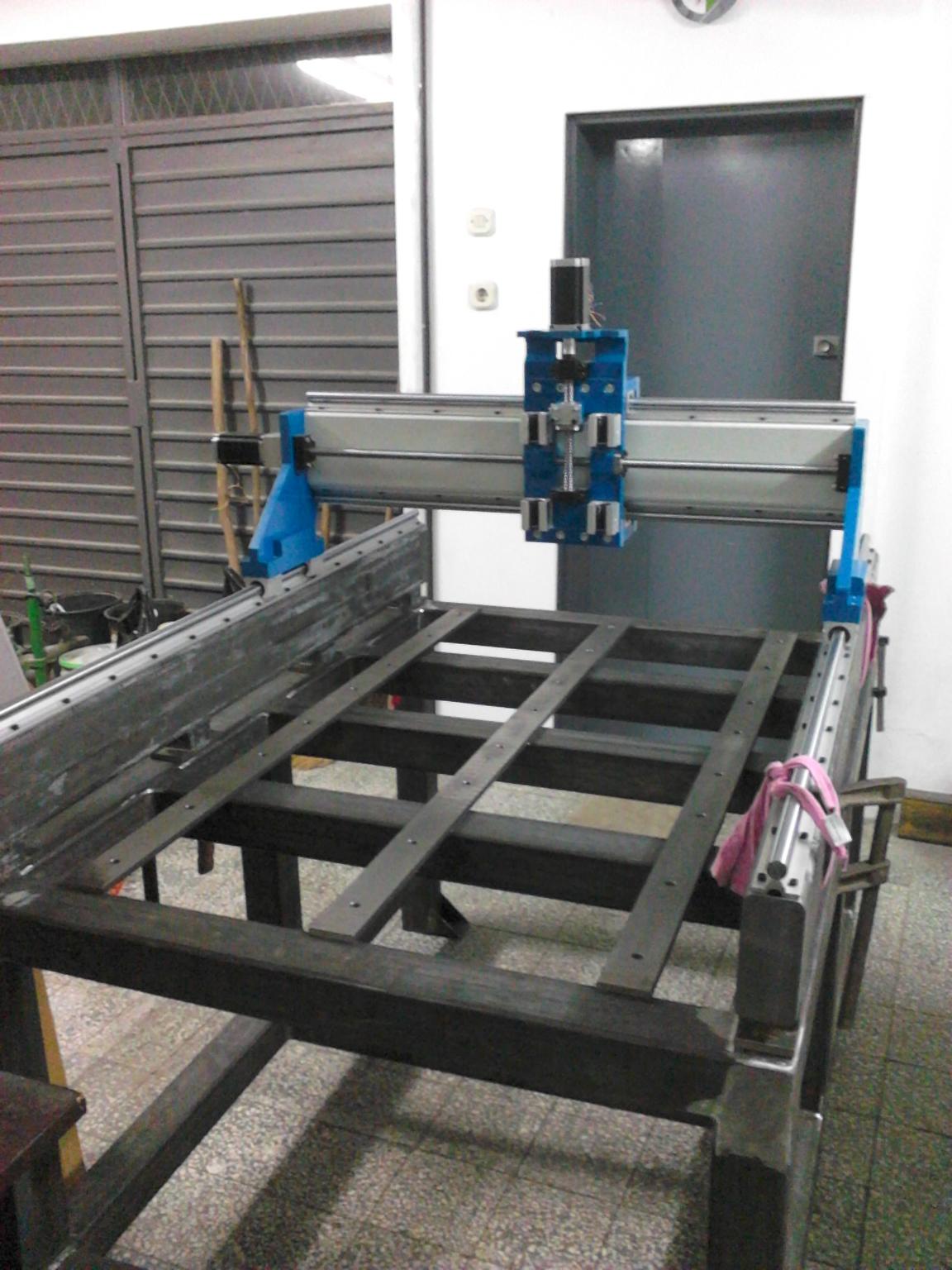

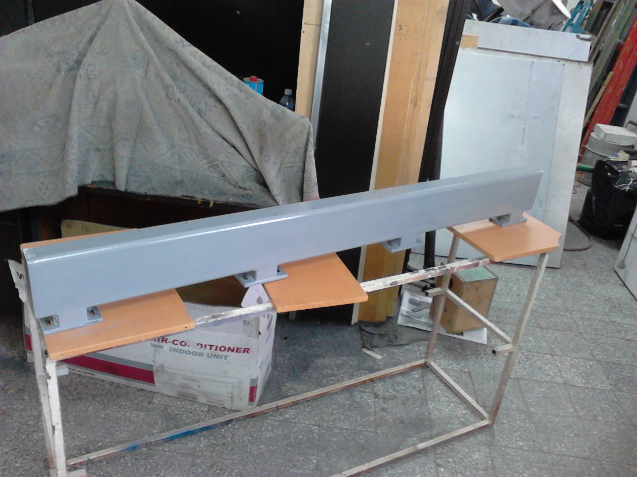

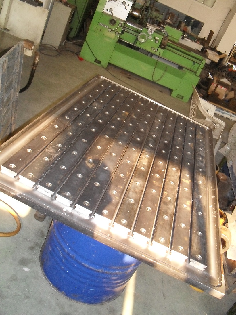

    I made a lot of progress.
    Here are some pictures, I hope you like it.

  10. #40
    Tidy job but the gantry and supported rails seem quite a bit less substantial than the base and bed, that's not to say it won't perform well.
    Next you will have to skim the bed to make sure it's flat.
