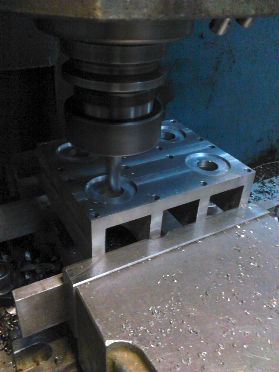

    Very nice looking machine. Tell us more about the machine bed. How much did it cost?
    The bed is made of 30 mm thick steel plate with dimensions 1500mm x 950mm. I payed 300 euros for it (weight around 370Kg). Then It was flattened on both sides using big Siemens CNC.
    Then we made ribs inside the plate and on top we put wider metal ribs bolted with m10 bolts. This metal ribs are 10mm thick. At the end, it was flattened again on the both sides.
    On the picture you can see the monster CNC Siemens. We've done a lot of parts for my cnc on it.
    It has travel of 1500mm x 1300mm x 950mm

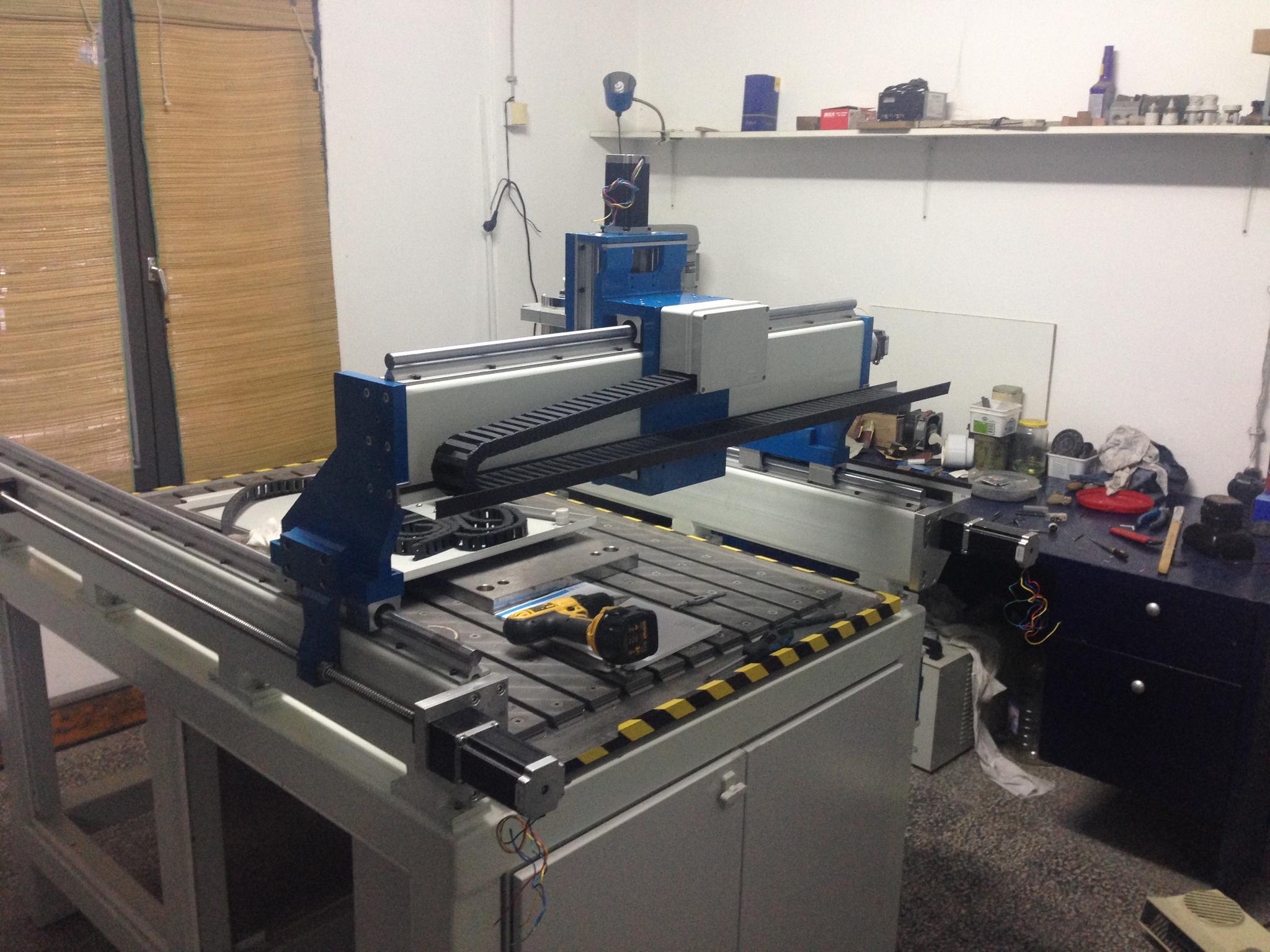

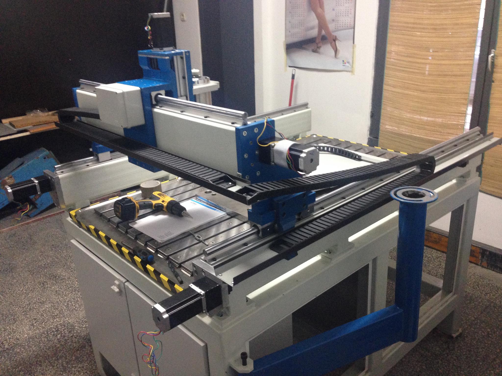

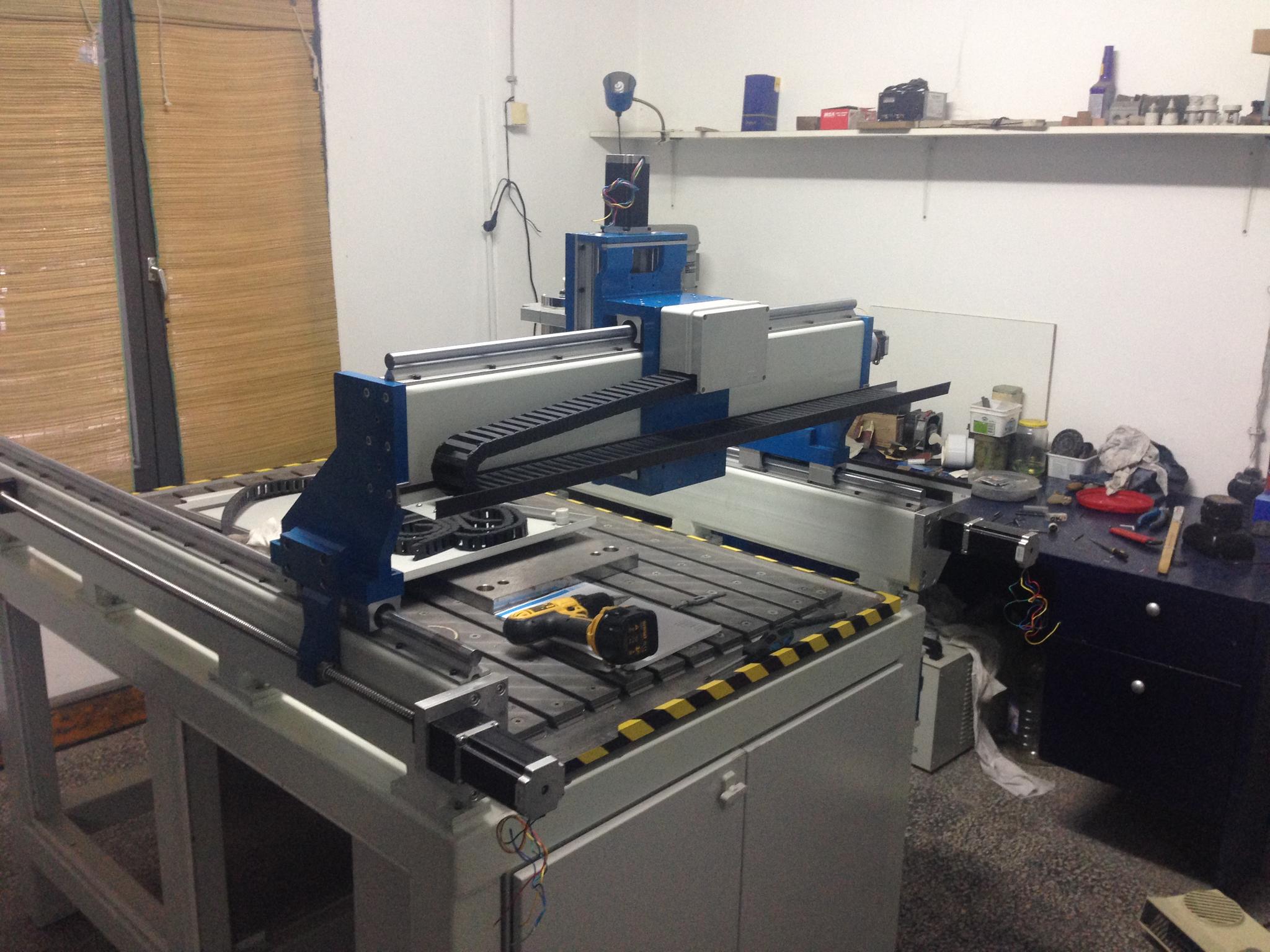

    Long time no update. Here are few new pictures of my build.

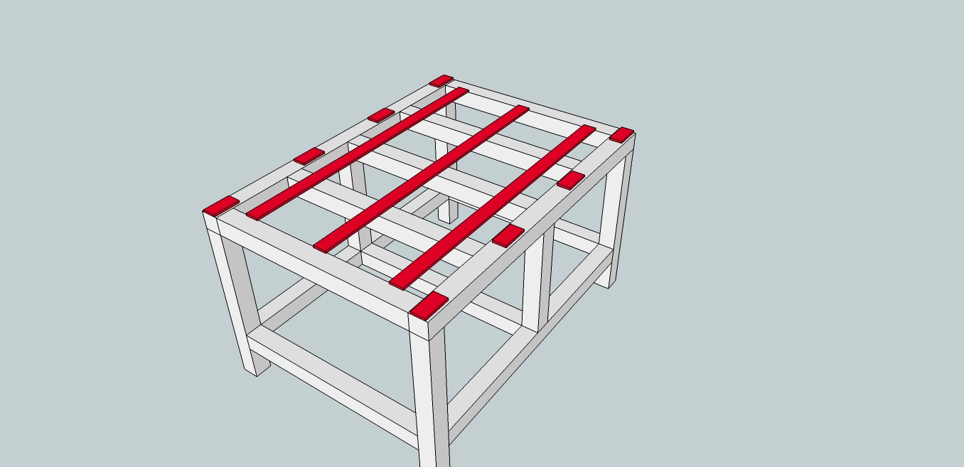

    Here is comparison, Design vs Real

    Nice work digisoft, should work well
    Any photos of the 'front' of the machine showing the spindle / Z axis?
  10. #60
    Yep, I'll make new photos today with better camera.
