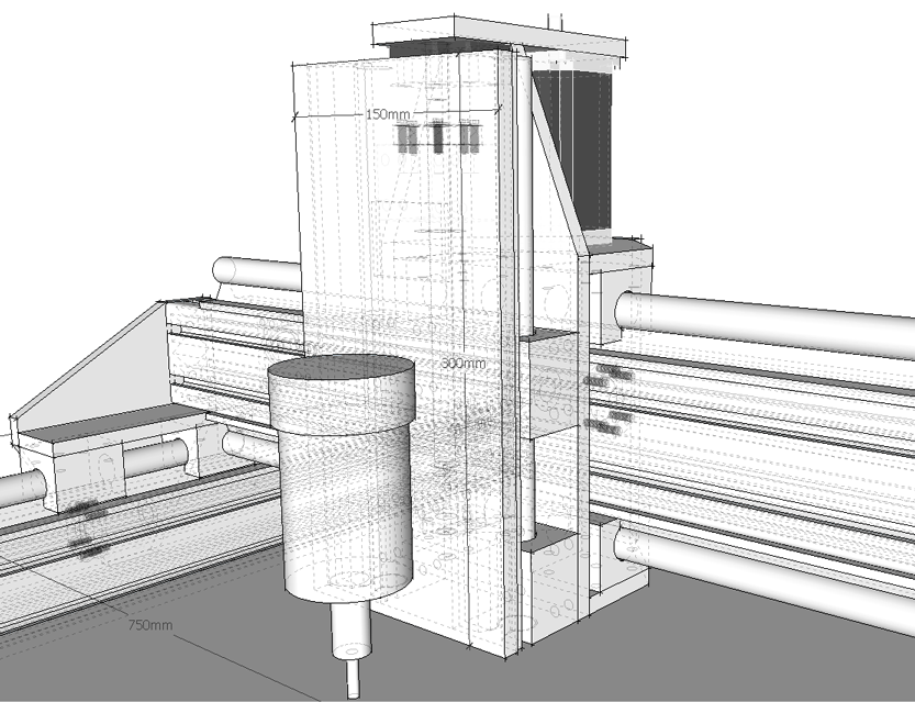

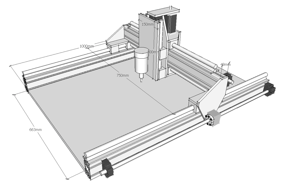

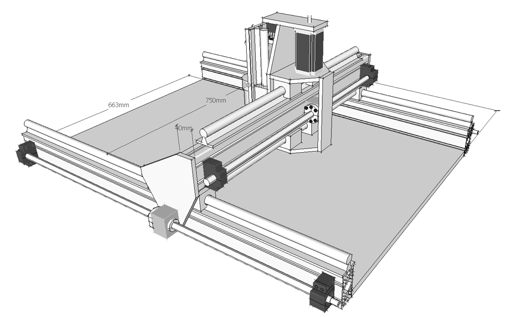

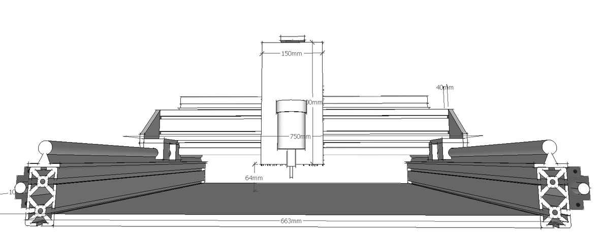

    Eventually starting to CNC build process... MKI
    I've done a LOT of reading, and calculations from several members (too many to mention)
    Machine Aim:
    • To mostly cut 6mm MDF, plywood etc.
    • Also to cut 20-25mm woods (mixing from soft to hardish(oak))
    • Aluminium cutting (3mm) - maybe somewhere down the line...
    I want to have the ability to cut A2 size (i.e. 420mm x 594mm ) - So with cut size, clamps etc:
    Cutting size: 480 mm x 640 mm
    Hardware etc:
    For hardware I was thinking:
    Nema 23 (3.1Nm) - Drivers [ Was thinking some 50v Drivers from CNC4You - powered by 36v ? ]
    SBS20 rails + Support blocks
    RM1605 Ball Screws and nut (Above 2 items from Chai - I've made contact and he said he is still shipping to UK and ready to take my order)
    Aluminium Profiles (40x80 heavy duty, Ix: 26.87cm4, Iy: 101.19cm4) - The Support Rails will be bolted on top of them, so extra stability...
    Router/Spindle: Looking at the Makita RT0700CX for now.
    The Z Axis has the ability to move 140mm, but will initially only us ~40-60 of that - unless I drop the table/raise the machine.
    The entire machine will be bolted down on a bakelite(?) top (super flat strong surface) with steel support under the top.
    (Will see if I need to weld a movable table one day...)
    Software, I've played around with bCNC and got a Arduino with grbl running on two Nem17's with a CNC Shield (Drivers DRV8825 - Will not use these on final machine)
    Below is my design so far: [Version 4 mind you, but at a stage where I feel confident to post to ask for further assistance and advice from experienced people ;) ]
    (Some final adaptions from JoeHarris, but really, the credit goes to the entire MyCNCUK Forum member builds!)

    Your input and thoughts on the design would be most helpful!
    HI Jacques Welcome to the forum. CNC4you do some very good 3.1Nm motors and are a good buy but you are limiting yourself with the drives AM882 or EM806 are much better and can be run them at a higher voltage 68V would be about OK. If you are mainly cutting MDF etc then 10mm screws for X and Y and 5mm on the Z.
    Think about the router as the Chinese 1.5kw or 2.2kw water cooled with VFD are a much better bet.
    Don't be temped to buy a kit of electronics as they are never matched as you will know if you have been reading the forum for the past 4 years.
    Start a build log so all the questions etc will be in one place.. Good luck with the build

    Hi Jaques,
    Clives suggestion to use 10mm screws is correct and it mostly do everything you want, even small stuff. But if you really want flexabilty then connect motors to screws using Timing belt and pulleys with 1:1 ratio then you have option to change up or down if required. Also and much better reason to use Timing belts considering the drives your thinking to use is to lessen resonance which affects motor performance/smoothness.
    I'd also urge you to use Profiled linear rails rather than cheap Round rail Chai sells. While Round rail does work ok the slight extra cost of profiled rails makes huge difference to machine stiffness and reliabilty. It will also increase sellabilty and value much more than the extra cost difference.
    Also with Motors you'll notice No Difference between 3.1Nm and 4Nm motors. The important thing to look for is inductance you want Lowest inductance possible. This will allow higher RPM and more torque for same voltage compared to High inductance motor.
    Again Clives advice of AM/EM drives and 60-70Vdc is sound advice you'd do well to take up. Esp when using Slaved motors.!
    For Components contact Fred Lee here and get a quote. He's good to deal with and his stuff tends to be slightly better quality than Chai's. Esp the End bearings for the screws.
    http://www.aliexpress.com/store/314742
