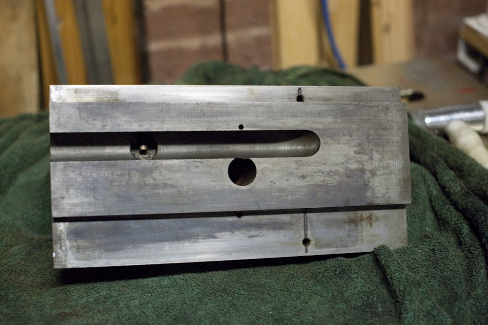

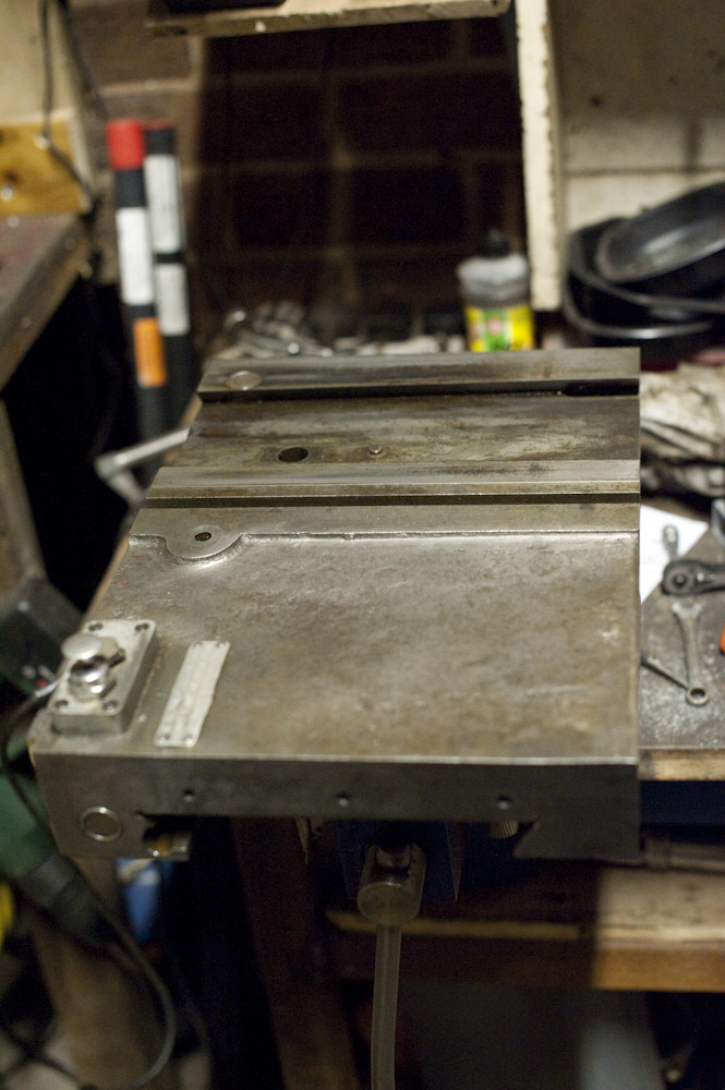

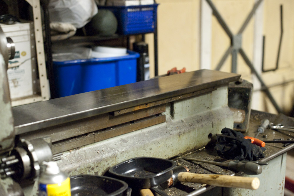

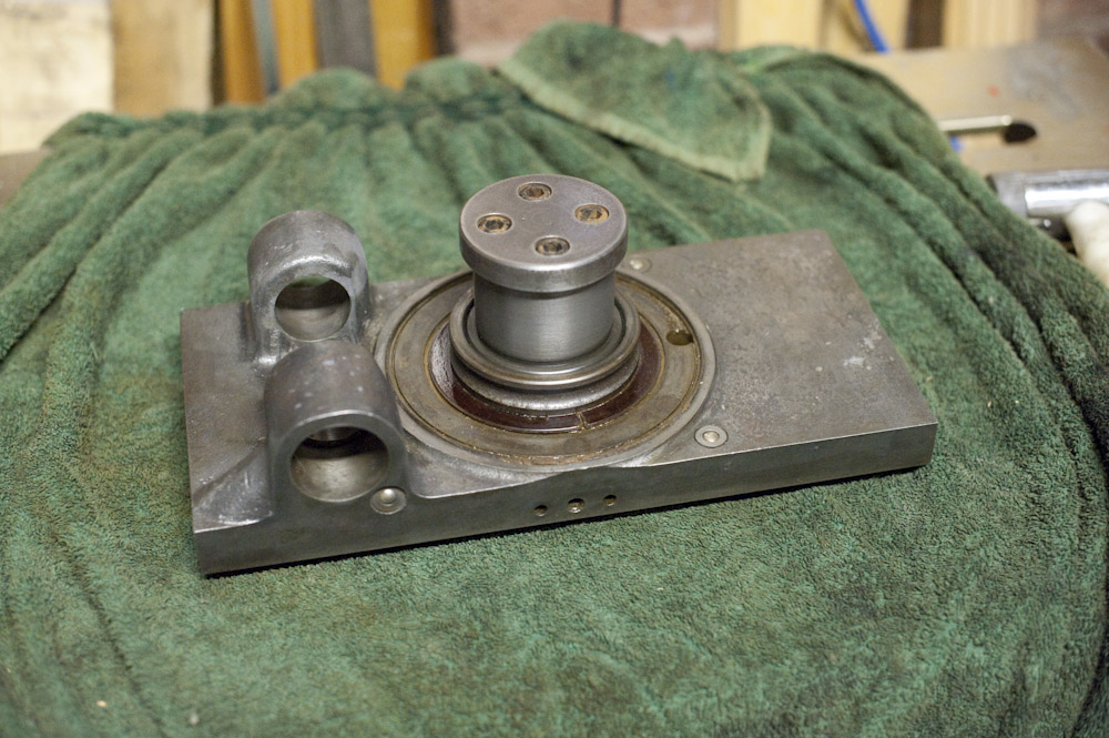

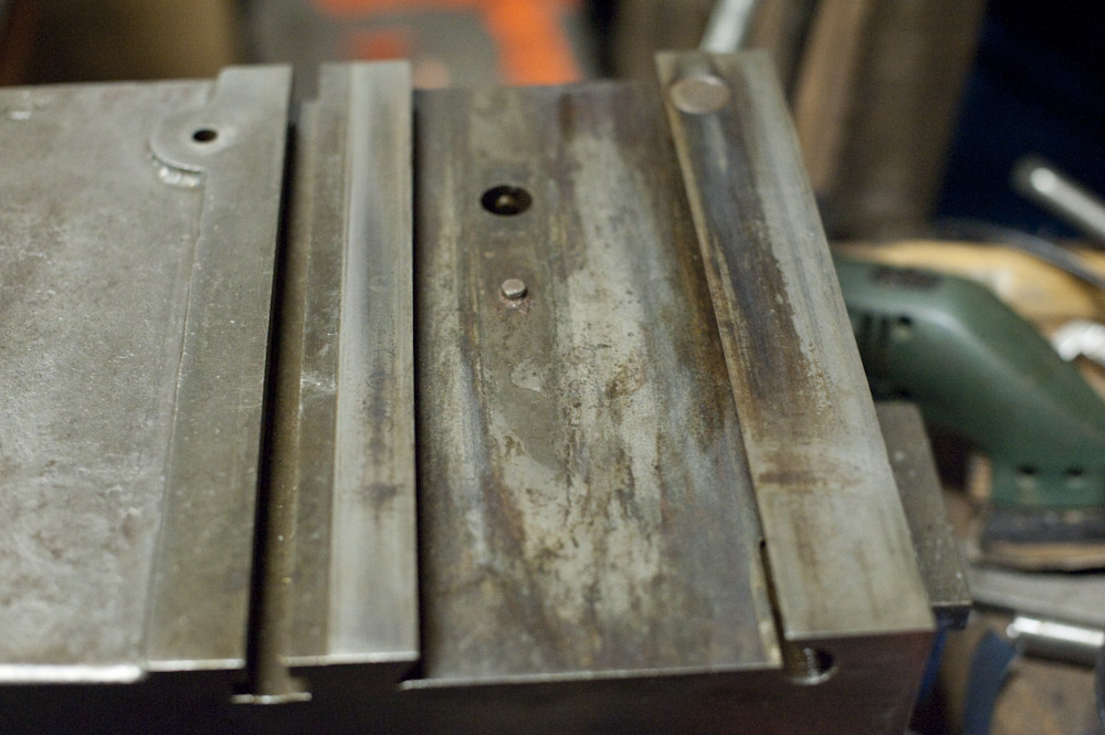

    Got the cross slide & carriage off today, definitely no indexing mechanism.
    The cross slide hand wheel is fixed to cross slide, and travel with it. No power feed to the cross slide either, not that I'm that bothered about having power feed to the cross slide, at least if there isn't one it can't be broken!
    All the painted surfaces have been stripped ready to be repainted.
    Tomorrow I'll have a closer look at the slide surfaces, they appear ok, but better to be sure.

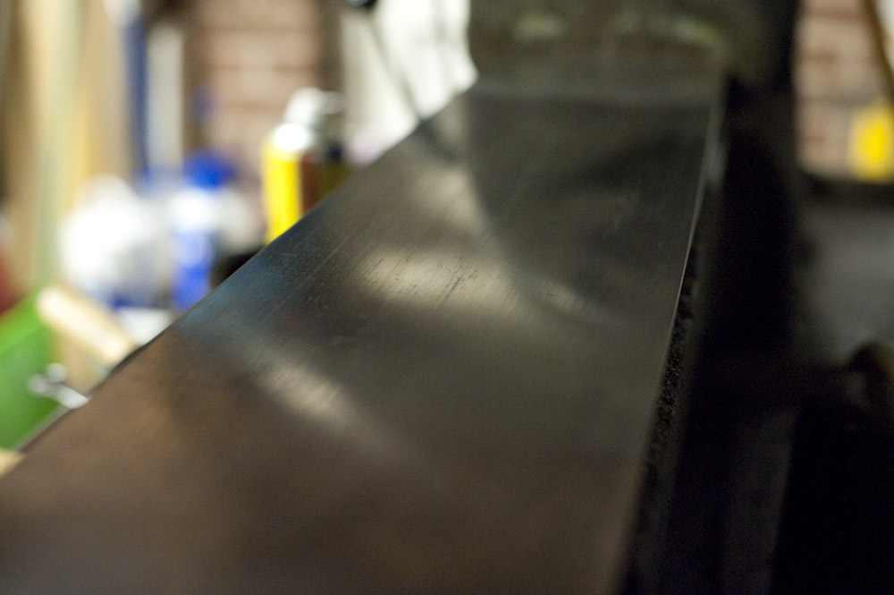

    Checked the ways with a straight edge, everything seems to by ok.
    The surface of the cross slide stop, had a few dings in them, so I hand scraped them flat so the stops can move freely.
    I haven't done any hand scraping for years, my arms are aching now, I'm glad I don't feel I need to the ways.
    Just repainting the painted surfaces on the carriage & cross slide
