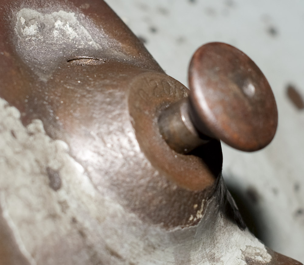

    The turret is not an automatic indexer, you have to turn the turret by hand then lock it in place with the handle.
    The serial number is on the flat around the spindle lock, and is 1020/1 if I have it correct it may be from the early half of the 1930's
    The machine was originally owned by Flight Refuelling Ltd, which make air to air refuelling equipment for military aircraft, I wonder which parts this machine made.

  3. The serial number is on the flat around the spindle lock, and is 1020/1 if I have it correct it may be from the early half of the 1930's
    I doubt it's that old. HLV's that had a similar hand-wheel speed control and bed-design date from the late 1940's to 1960 when the HLV-H was introduced. I'd guess yours is not older than the mid 1950's and maybe as late as the 1960's.
    It looks in pretty good condition for an HC; they tend to have a hard life - I repaired a couple of handles on a pair of late 70's vintage HC's a week or two ago that looked far worse. (The plastic carriage handles had worn right through their spindle - How many time must the carriage been up and down to do that???)
    The turret should spin to the next index as the lever is opened - There's a lever and ratchet system under the turret that is either worn, broken or, most likely, gummed-up with congealed coolant.

    I am inclined to agree with you, regards the age of the machine... BUT
    There are too many "hang on a minute" moments, firstly they're is no ratchet for the turret I have taken plenty of pics and I will upload them as soon as they transferred from the camera.
    The two bearings for the turret are ball races, as per later versions if I recall correctly, but the friction surface upon which it rotates, looks to me like bakelite
    The Brake is as you say, solenoid actuated lever with a cork, and it looks like both solenoid & cork are buggered.
    The powerfeed is I believe just the motor, I have had a look in the control box and everything in there looks OK, biggest pot I have ever seen, didn't know they made that big

  9. I thought all Hardinge turrets were self indexing, these were made for fast production (I could be wrong) so perhaps there are parts missing???
    [edit - having seen your pictures] Oh yes, that looks like it just has a ball-bearing detent
