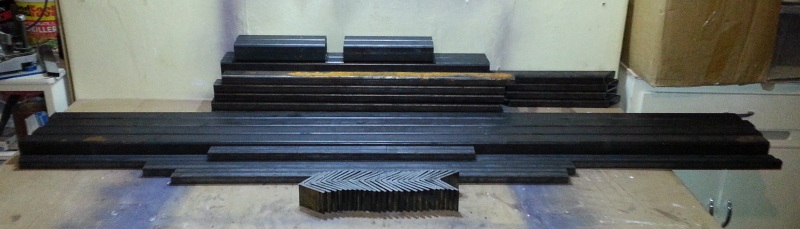

    Some bits turned up today......
Name:	Wobblys steel.jpg
    Neil...

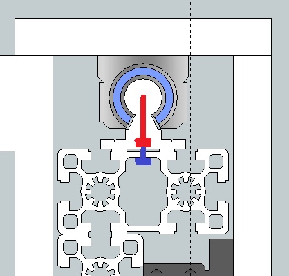

    I haven't tried this but I've been thinking about it. The supported rail (at least the stuff I got from chai) has a series of machine screws(red) that bolt the rail to the support from below. Maybe these could be replaced with slight longer ones(blue) and bolt through the extrusion, support and into the rail.
Name:	another super accurate diagram.jpg

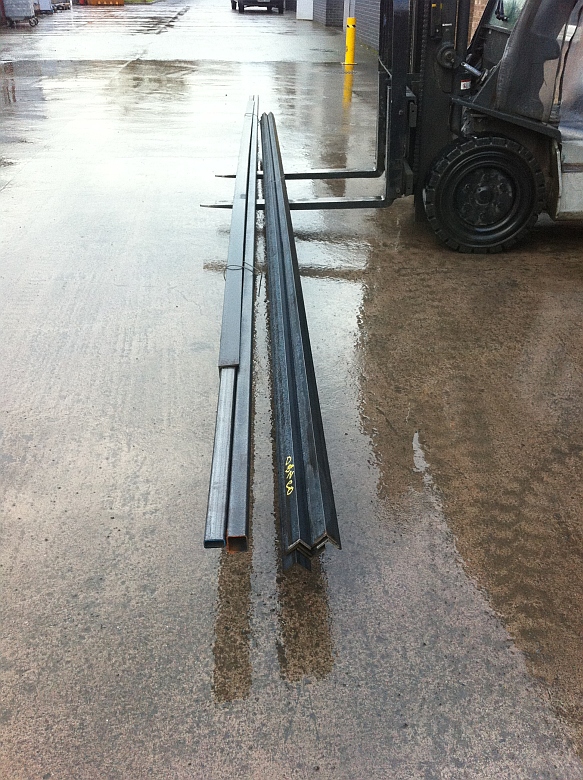

    Oooh steel, the build begins today . I'm hoping that's not all mine, I've already got more angle brackets than I know what to do with! Good to see it supporting it's own weight on what it probably about a 3m over hang though, I think this frame might just be strong enough :-). Cheers for to the update.
    That's a cunning idea with the bolts asbo (and I like the drawing). Some careful planning would be required to get the bolts in as well as a long socket wrench and some careful hole cutting on the opposite side of the extrusion where it looks fairly weak already.
    No yours is only the bundle on the left, in fact there are 2 lengths missing (20x20) which should be here tomorrow.
    Will start the cutting tomorrow morning :)
    Neil...
    It doesn't really tell you anything. With a CNC machine we're not worried about the material failing/passing it's elastic limit, we're instead concerned about making sure it doesn't deflect by a few tens of micrometers. In the image that will probably be bending at least a milimeter.

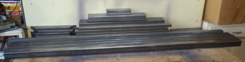

    Been busy this morning...
Name:	Wobbly's cut steel.JPG

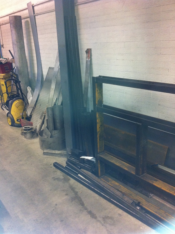

    Last weekend, in the pouring rain, I collected the steel for the base from Neil who very kindly sourced it for me and cut it all to length.
Name:	2012-11-30 18.26.56.jpg
    It was all covered in a good coating of oil which has been doing it's best to get every where this week so I turned it in to a somewhat cleaner pile of steel by rubbing it down with a degreaser.

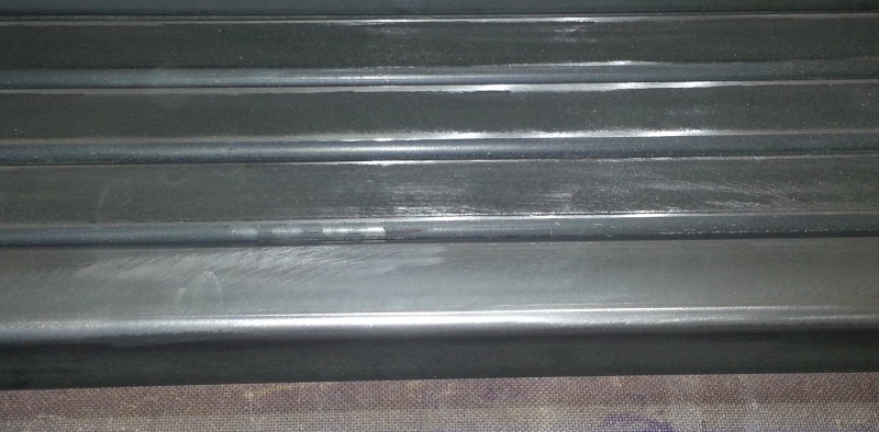

    After spending an hour or so cleaning it I decided to get a couple of rust spots off with a wire wheel which is when I discovered that I'd actually only managed to get a light surface layer of oil off, there's a much heavier oil still on the steel. My question therefore is this: how clean do I need to get the steel in order to paint it?
Name:	2012-12-01 14.43.18.jpg
    The image above shows a very clean piece at the bottom and a pieces that have just been degreased above. I'm sure the bottom piece is clean enough for paint but are the other pieces? If I've got to get all the oil off what is the quickest method as wire wheeling it all will take ages.
    Some good news though. I've tested a couple of the long rail pieces of steel with a reference straight edge and they are fairly close to straight <0.5mm in 600mm.
    Cheers :-D
