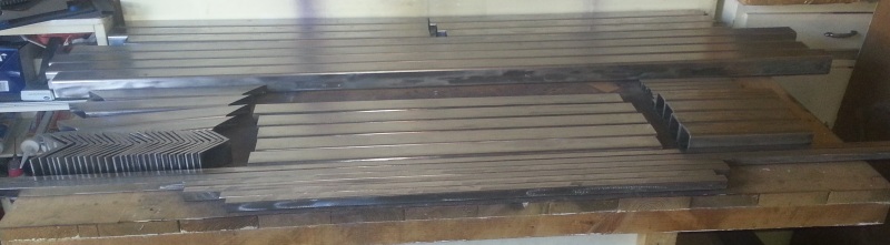

  4. #64
    After trying every solvent and cleaner I could get my hands on I gave up and attacked it with a flap wheel and wire wheel. I'd only used a grinder once before to chase out a couple of electrical sockets and it was so messy I never tried again. I can't believe how much I've been missing out though, everything is going to get a good grinding from now on :-)
    The angle brackets were probably the worst and they were awkward because as were small. Here's a before and after shot.
ID:	7532Click image for larger version.
    So after a few hours with the grinder I'd turned a pile of oily steel into a pile of clean steel ready for the next step.
    From reading around on welding forms it seems the next step is to pickle with phosphoric acid rust remover and then undercoat. Does this sound right? I want to get an undercoat on before starting construction as I think this build will take a while and I don't want all this work being undone. If I decide to get a welder it should be fairly easy to wire wheel off the undercoat in a few places. Any recommendations for undercoat? I was just going to pop down Halfords and get some car spray undercoat.

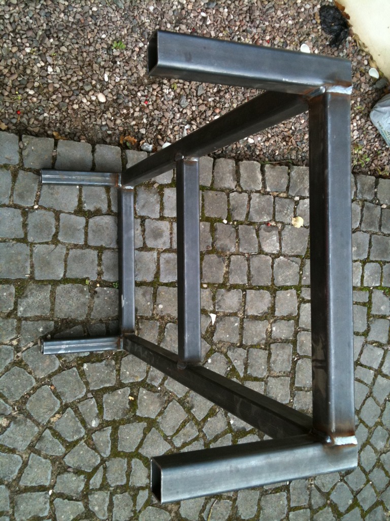

    I've just twigged what you were trying to remove...it's the protective layer that stops it from rusting too badly if you're going to leave it anywhere for a while :( my frame has been sat in a damp garage for nearly 2 years and only has a small bit of surface rust in a few places, and nothing a quick tickle with the grinder and flap disc won't sort before painting ;)
    As Jonathan says powder coating is good but only on the finished frame as you can't touch it up like you can sprayed paint.
    Halfords primer would be ok, though for the amount of steel you have it will cost an arm and a leg!!!
    If you get stuck I have a friendly local (to me) painter who could probably do it quite cheaply. Or there is one place near Mitcheldean I think we have started to use at work for painting.
