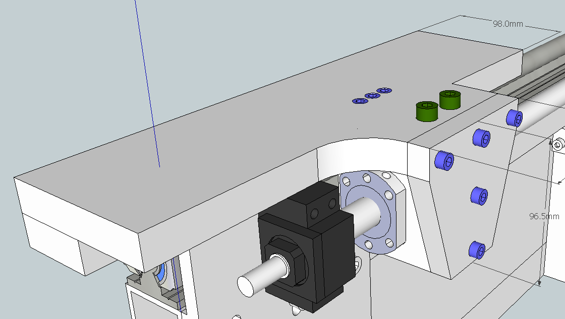

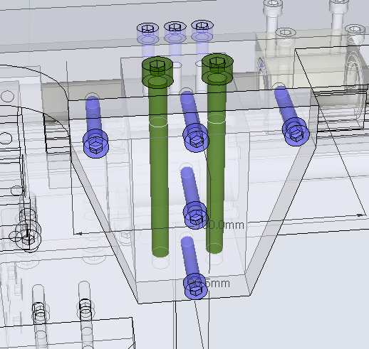

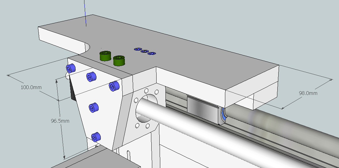

First off we have the gantry connection to the rails and x-screws. I noticed a lot of people were advised to make this connection stronger so hopefully this will be strong enough.
Name:	Wobblycogs CNC v4 - Gantry Connection 1.png
ID:	7404Click image for larger version.
Name:	Wobblycogs CNC v4 - Gantry Connection 2.png
ID:	7405Click image for larger version.
Name:	Wobblycogs CNC v4 - Gantry Connection 3.png
The block that attaches to the ball nut is a 50mm lump of aluminium. The green bolts are M8x90 and go most of the way through. The blue bolts are M6x30 and screw in to the block between 15 and 20mm. After seeing someone else's build I've gone for a two plate gantry design as I think it'll be simpler in the long run. There will be slotted screws holding the two plates together so fingers crossed I should be able to get the screw and gantry connections aligned. I'm not keen on the three M6 bolts close together on the top plate but I think they've got to stay. They are there to counter any torque applied by the green bolts and face plate if things aren't 100% square.

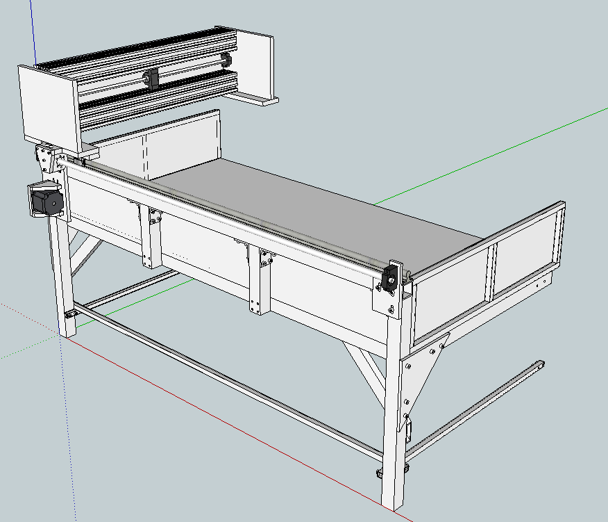

I've slightly redesigned the bed to make it simpler to build and to move the legs to be directly under the x-rail. It's shown bolted together but I've decided to weld at least some of the joints so that I get it done this century.

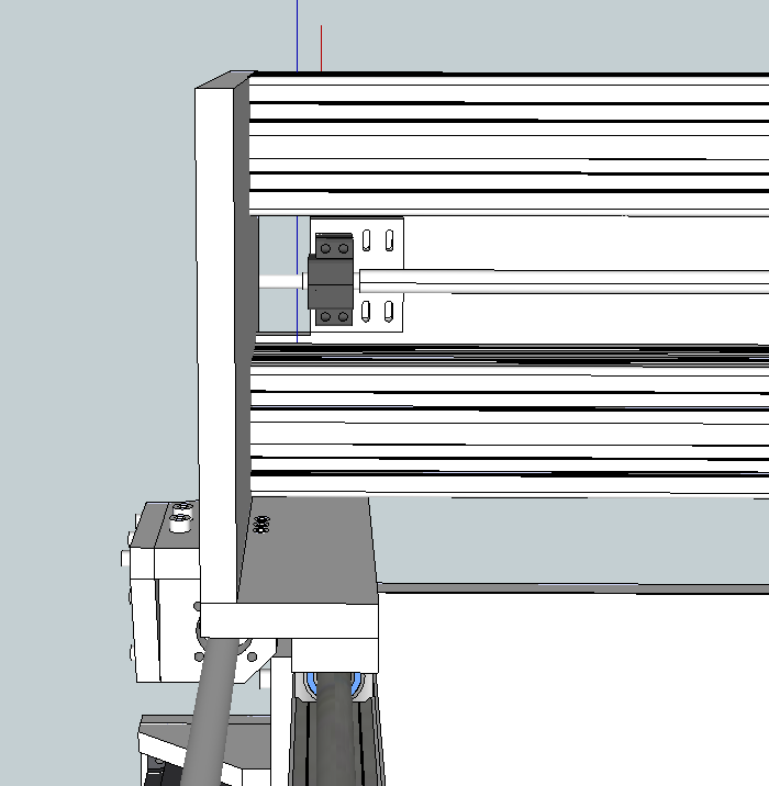

Now here's where I'm going a little off-piste with the gantry I think. I read the recent thread discussing gantry designs and liked the L shaped solution made from 45x90 extrusion. I also liked the C shaped designs so I thought why not try and combine the best of both worlds and use some 90x90 heavy extrusion (this is now in the sketchup library if anyone else wants it). I'm guessing this will give me both vertical and horizontal strength and the extra bit of mass should help damp any vibrations a bit.
I'm currently pondering running the y-rails along the front of the gantry rather than top and bottom as most people do. Although this will cause the Z-axis to stick out about 50mm more than the top and bottom rail design it will also allow me to maximize my y-cutting distance and have a slightly wider y-bearing spacing. The gantry side plate will be braced front and back and reduced in size to only what is required as the design progresses.
