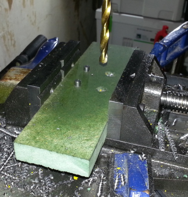

    I made this jig for drilling the brackets which came in really useful:
Name:	2012-12-23 16.42.51.jpg
    The studs are pieces of 7mm shank from an old drill bit. I slipped the bracket over the two studs to ensure it was perfectly aligned for the other two holes. I now have 26 brackets with identical hole patterns.

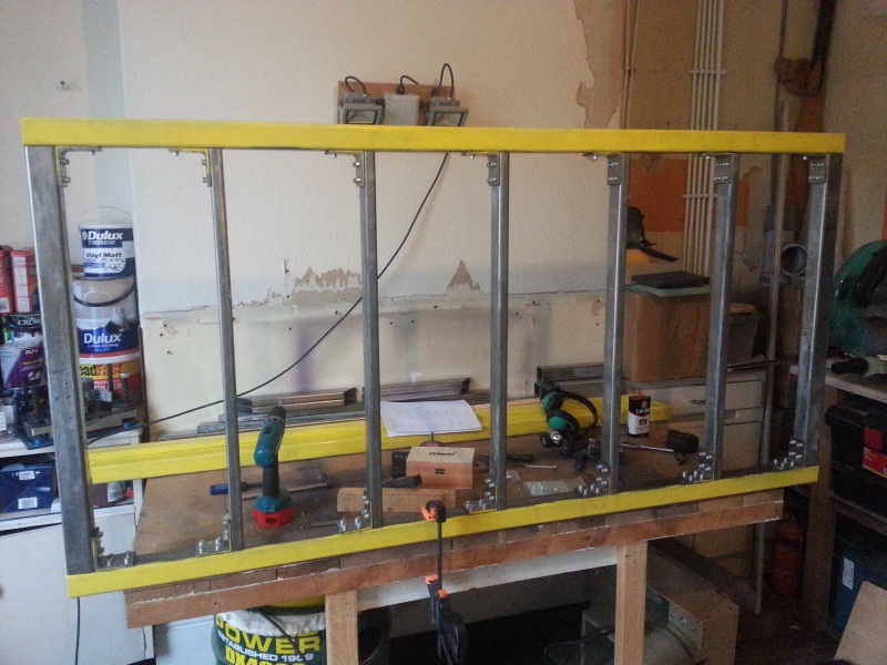

    So far I've put together the bed and part of one of the sides. I'm going to try and get a leg or two fitted tonight.

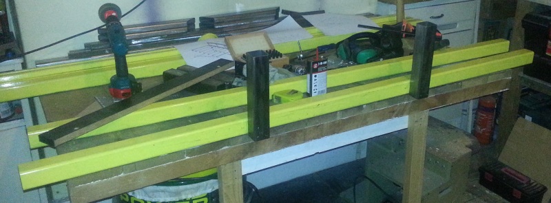

    I'm completely fed up with drilling an tapping holes :-). There's 112 tapped holes in the bed alone which is less than half what the machine will have when complete. I'm also going to have to add some more bracing to hold the frame square I think. The bed as shown is stiff enough that I can't noticeably cause deflection by hand but individual members are easy to move so I think it needs more. A few bits of angled bracing should stiffen it up tremendously though I think and give me an easy way to make sure it's perfectly square. I've got a ton of angle section left so I might use that rather than get more steel.
    Quote Originally Posted by Wobblycogs View Post
    Drilling and tapping lots of holes is the most Mind numbing exercise known to man and there isn't a curse or swear word that does justice to the feeling of snapping a Tap in hole 99 out of 100. . . . . . . . Great incentive to learn to weld. .Lol
    Unless it going down a Rabbit hole surely it could have been made modular from welded parts.?
