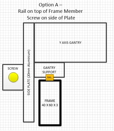

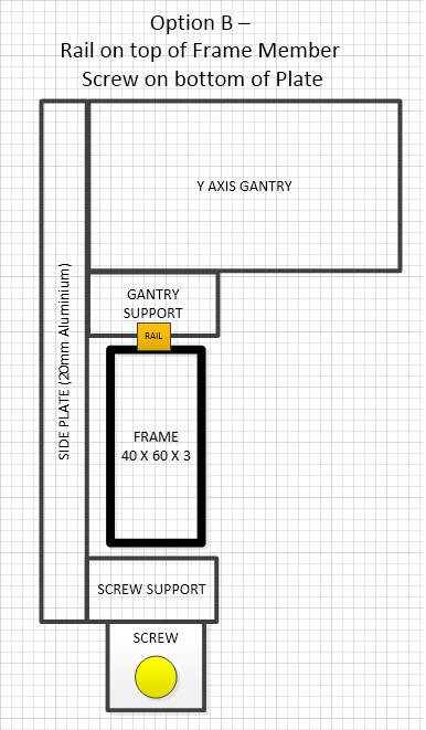

  10. #9
    Quote Originally Posted by TonyD View Post
    Only concern is that the block is 260mm in length right now and thats a fair amount of X Axis travel I'm eating up.
    The deflection due to the bearings on each axis is inversely proportional to the linear bearing spacing squared (which is obvious from the formulas in the Hiwin linear guide datasheet), so increasing the spacing by a relatively small amount can make a big difference. That's why it's important to space the bearings out as much as you can afford to, assuming the part they are mounted on is strong - which currently isn't the case as it's just a plate which would benefit a lot from a triangular/trapezoidal piece on the side. 260mm is not bad...probably not much point going above 300mm as other parts of the design will have a greater effect on the overall stiffness.

    Folks. I've been wondering about some more design concepts and I thought I'd ask for some advice. I should start out by saying that my goal is to orient the machine at a relatively steep angle but as I've played around with frame concepts I have no idea how to approach that yet. I've found that one step at a time suits this pursuit in my mind…So I'm hoping for some vertical but may go for regular horizontal. The basic parameters are a 1500mm X, 1100mm Y and currently a Z with a conservative 150mm, plenty scope for changing the Z once I can make some parts.
    So. I have considered three basic options and presented them from a front view and my basic question is how to place the rails and screw so that the Y Axis gantry is best supported with minimal adverse forces being introduced?
    Option A is the most conventional I think? Option B has the virtue that the screws are under the machine, need to take more care over a frame that allows this. Option C seems to put a lot of force on one side of the linear bearing block. Any suggestions, comments welcome. Sorry it’s not in CAD but I'll flesh out the winner into a more detailed model later. Thanks. Tony.
