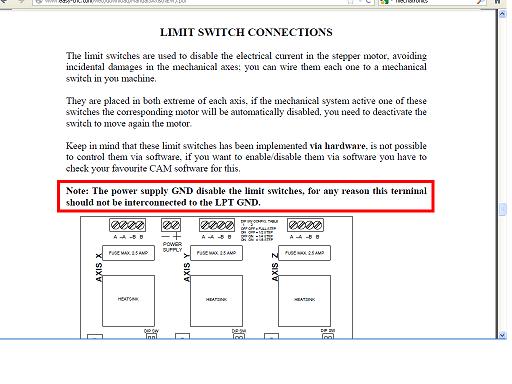

    Ok I suspect the limits are tied to Enable signal of the individual drives but the Only way to fully know what's going on is to trace the wires back and see if they go to the drives or the BOB. It could also be a feature on the BOB but without knowing the BOB then can't say.
    Turning the drives off using the enable signal is Ok has it keeps the drives powered up and holding torque applied to motors but really you want mach to know about it and stop the code running. This is easy enough to do by passing the same wire thru an input on the BOB then telling Mach to watch it.

    http://www.easy-cnc.com/web/download...s%28NEW%29.pdf
    My motor driver is the one above (3 axis micro stepper motor driver )

    I have tried re-installing mach3. Didn't make any difference. If I use Pin 15 (toggled negative) for the Estop, the reset works for 8 seconds, and then falls back into a flashing Reset again. This happens every time. So I have disabled it.
    I have checked all wiring...all good. The Driver has its own PSU that the previous owner has set up. The Driver circuit is new.

    Can't find any break out board. Unless you just mean the screw down contacts on the driver board. This is the only connections between the PC and the motors that is accessible .
