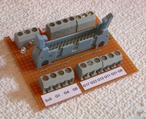

    I've had mine for a while now and looked into this and the problems i have seen so far is limited number of I/O pins (10), The need to build a new kernal to support the Arm processor for realtime use. I am still sure though somebody clever will iron these out at some point to have a basic controller of sorts?
    Interestingly enough Mike Cook has recently done a little BOB for the raspberry pi:
    He hasn’t had his long, however looking at his “portfolio” he has also done a CNC Conversion converting a Proxxon MF70 machine to cnc and then building his own version of the RepRap controller, a unit also based on the Arduino:
