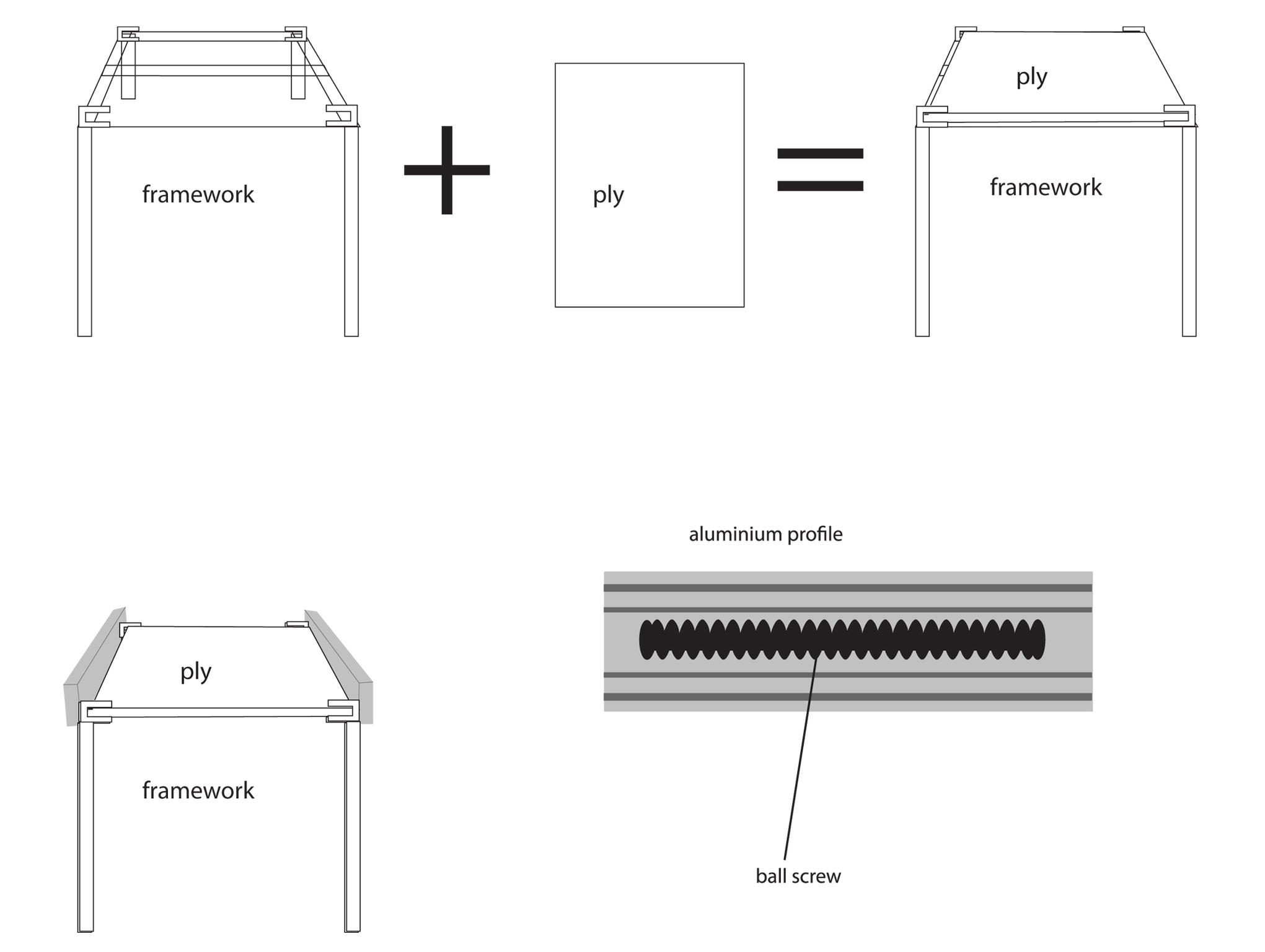

    Hi all,
    I have attached the beginning steps to building my cnc machine. I hope to make it approximately 4x3 or 5x3 foot
    Attached is the image of the metal fabricated framework, with brackets on each corner which will house the plyboard bed. There will be no top and bottom framework but only on the sides, in order to allow full sheets of boards to be cut continuously hopefully if this can be achieved). If there was framework on all four sides I am limited to that bed space. Is that right?
    Also Can anybody give any clues about what stepper motors, ball screws, router, belts if i need any? bearings, tracks, brackets and drivers I would need?
    How long would it take to make? and how difficult will it be?
    I do think the best way would be to get someone to build it for me.

    If you're going with a frame that big you'll need supporting beams under the bed otherwise you'll get deflection and vibration, cross bracing etc. I'm presuming that you're making it out of steel? Box section would be best in terms of strength, something around 50 x 50 x 4. I'd suggest having a look at Jonathan's build thread to give you some ideas http://www.mycncuk.com/forums/router...-building.html or Bruce's (motoxy) http://www.mycncuk.com/forums/router...challenge.html or one that's just starting is wobblycogs http://www.mycncuk.com/forums/router...s-cnc-mk1.html plenty to chose from ;)
    As a rough guide without knowing too much else (especially your budget) the norm seems to be 3Nm NEMA 23 steppers and something like the M752 drivers (from Zapp), ideally Profiled rail and linear bearings (expensive) or alternatively 25mm supported rail (cheaper) and bearings. Ballscrews 1610 with anti-backlash ball nuts as you're going up to about 1500mm, anything over this and you'll need to . Ball screws (2 on the X axis because of the length you want) driven by belts and reduced 2:1 to the stepper.
    How long depends on how deep your pockets are, how much time you have to put into the project, how skilled you are, what tools you have available to use...etc. etc. i.e. how long is a piece of string lol How difficult is it....again depends on your skill level with tools, ability to learn new things, willingness to learn etc.

    My budget is about a £1000 and i would like it to be a stable machine dont really want too many problems in the long run as i would be using it for work.
    With only £1000 it will be tight - you certainly will have to make it yourself to achieve that.
    The electrical parts, i.e. 4*3Nm stepper motors, DQ860MA drivers, PSU, breakout-board will be about £300
    2.2kW spindle + VFD, which is the only one worth getting for this size machine since you want it to last and cuts lots of different things, about £240
    Water pump for spindle, £15
    Steel for frame, about £50
    You'll need something like this for the ballscrews and rails:
    RM1610-1500mm, *2
    RM1610-1200mm, *2
    RM1605-250mm, *1
    Bearing blocks for ballscrews, *4
    SBR25-1500mm rails
    SBR20-1200mm rails
    SBR20-300mm rails
    That's about £520 (bit of a guess but should be within 10%).
    Pulleys and belts, maybe £35
    Total: 300+240+15+50+520+35=£1160
    So actually it looks like £1000 isn't realistic for this size machine. There will be other small parts I've not included in that list which all add up, like fasteners, material for bed. Plus I've not included the metal to make the Z-axis and maybe Y, so easily another £100 there - more if you can't cut it yourself. So a realistic budget for this size machine, capable of cutting the materials you suggest, is nearer £1500.
    Just to be clear, the above is not intended to be a shopping list - get the design done first before buying anything otherwise you'll have no chance of making it cheaply.

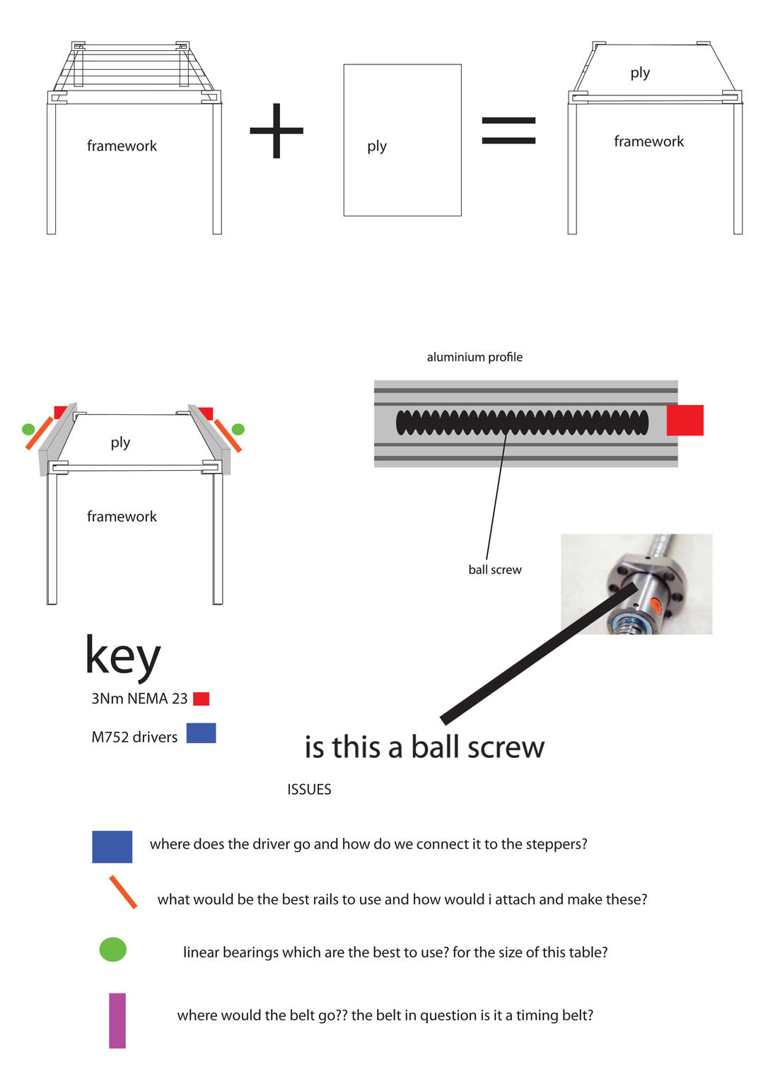

    Thank you for all your replies, I have looked at all the feedback and redesigned the cnc. Please let me know what you think. If it goes over my budget then its not too much of an issue. just a few issues which I dont understand :
    (As mentioned and illustrated on the design attached)
    1) where does the driver go and how do we connect it to the steppers?
    2) what would be the best rails to use and how would I attach and make these?
    3) linear bearings which are the best to use? for the size of this table?
    4) where would the belt go?? the belt in question is it a timing belt?
    5) Also Im thinking of making the frame stand out of mild steel and the cnc bed frame out of aluminium box section. Would this be okay?
    Thank you all!
    A lot of people use an old computer case for the electronics so the Power supply, drivers, bob & any control relays would all go in the box. Connected to the motors usually with shielded cable.
    Profile rails would be the best but because they tend to be expensive a lot of people use supported rail, the rail is fitted to the machine frame with cap screws or something similar.
    I'm new to all this myself but from what I have read 25mm on the longest axis & 20mm supported rail on the other two.
    Yes they are timing belts, pulley fitted to each of the motors & ballscrews< the belt fits between the motor & ballscrew to turn the ballscrew.
    Yes that would be OK but if you are making the stand from steel why not just make the whole frame from steel. Would be more ridged & probably cheaper to construct.
    Oh & yes that picture is of a ballscrew & nut

    How hard would it be to do the electronics, is it a difficult job for someone who has no knowledge in electronics?? I should be able to get help but can this be learnt?
    also ive seen a pic of the rail so im assuming the stepper motor is attached to the ballscrew via a coupling and this resides in a box with the profile rails either side. Is that right?? something like below.
