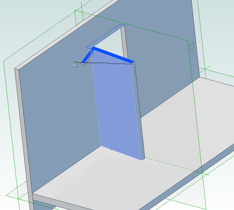

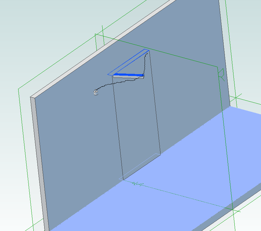

    How about this for a Heath Robinson solution...
    Door is closed by a standard door closer.
    Door is opened by string wound around a bobbin on an electric motor.
    I haven't had time to look at interference between opener and closer but it should be possible to work around it.
    Apologies for the dreadful drawings...
ID:	14482   Click image for larger version.
  4. lol, don't think my wife would accept a heath-robinson approach! having said that, I did look at a cable pull design, but the door closers don't give a positive closure against the draft proofing for the multipoint locking to engage, so needs to be an active pull closure as well. also needs a clutch/freewheel to allow manual opening of the door.
