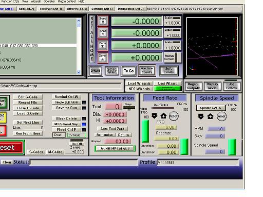

    I am learning to use Mach3 for my CNC/router machine. I have the demo version.
    I load the wizard inside Mach and pick one of the tabs. Why am I getting the X,Y and Z axis under the visual table in the display window ? as the file executes, in the display the tool starts at the bottom and works its way up towards the table. Obviously I have something set wrong, but I have changed almost everything I can think of but no luck.

    assuming i know what your saying...
    off the top of my head i can only think you have your Z going + on the plunge instead of -
    go to motor setup and select or un select active low for your Z axis (i think)

    I think i have sust it. In the "Homing/limits" tab, I just put a minus in front of the Z axis "Soft min" table height. That seems to of fixed it
