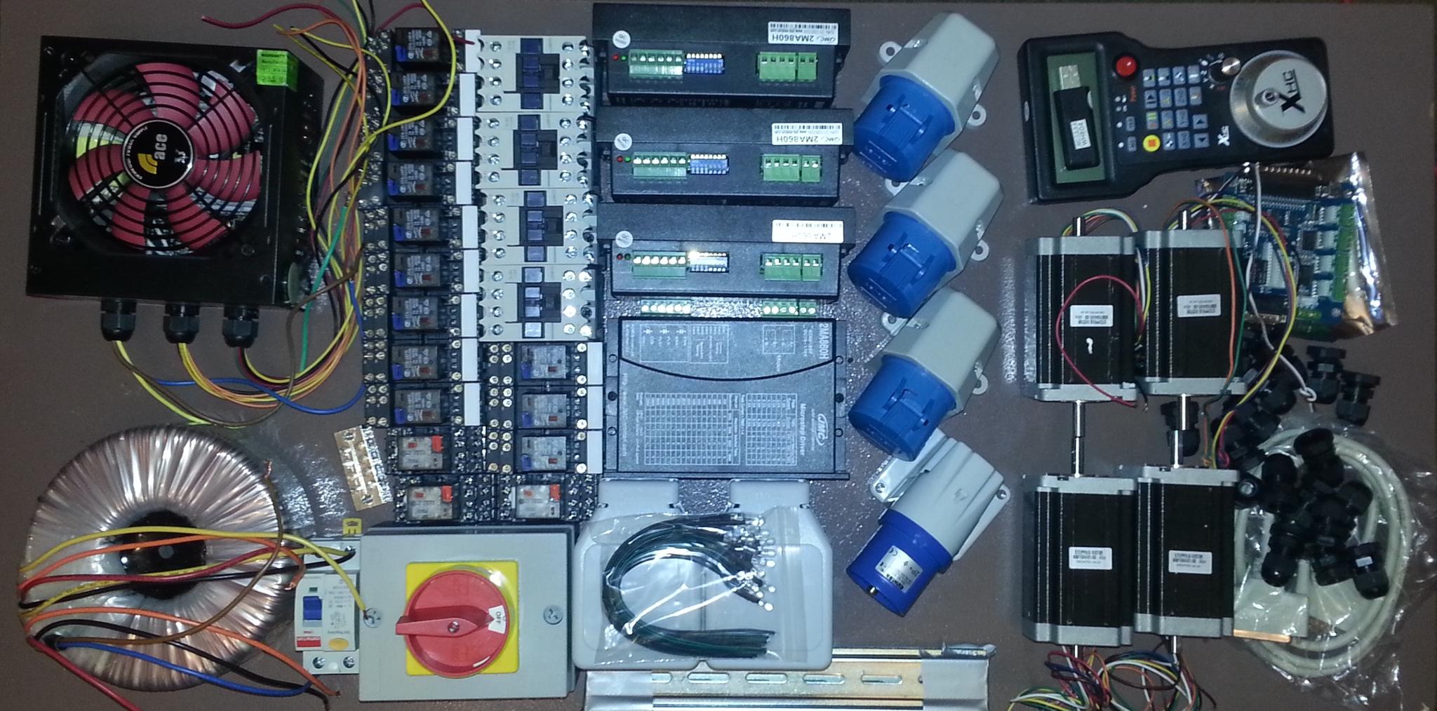

    Ok, Ive recieved My toroidal which is 4x24 1200VA so using a series arrangement i will have the 50-80vac I require for the Drivers/steppers i will also have 1 or 2 free windings at approx 24vac which is what the contactors require, I will be using an ATX power supply for the smaller relays and the indicator 3v LED's and 5v for the bob as i have one and its easy, im still waiting for the Enclosure which should be here in the week sometime, and the caps im sure i have beneath a few cob webs somewhere.
Name:	new Stuff.jpg
    Looks Like she will be getting that bigger coffee table she has been asking for. cos there wont be room on this one for the rest of the stuff by the end of the week...
    Rick
