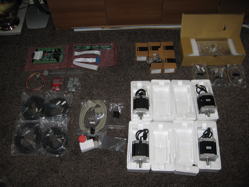

    Hi All, Stupid question alert.
    I've got hold of a load of bits for my control box,
    Pictured Here

    (Yes I know the stepper drives are missing)
    I'm told the various bits need 14awg, and 22AWG wires.
    Now the question comes ,do I need single core, or multistrand , shielded or unsheilded, CY? SY? WTF! the more I look at the "Oh so many types of Wire", the more I'm baffled.

    For the stepper motors you need 4-core CY cable, which is shielded. If the cables are quite short then 1mm^2 is fine, but for a big machine I'd use 1.5mm^2 to reduce the voltage dropped across the cables.
    CY Cable - 4 Core 1.0mm2
    For the signal wires in the control box any thin wire would do and shielding whilst not necessary might prevent problems.
    You need fairly thick cable for the power to the drivers - similar thickness to the motor wires, so you could just use that if it saves buying more cable. Use separate wires to each driver - don't connect the power from one driver to the next to the next...

    @Jonathon Stepper cables are sorted, Thems the ones in the bags in the pic (lower left x 4) , Its more signal and power wire in the box joining the PMDX126 and bits together. So I take it, it doesn't matter too much whether or not soild core or multistrand for either Signal or power? if not Ace! less headaches.
    I have a PMDX126, a 134 MOBO, and a 107 speed control board, so the wiring on those is pretty much plug and play with the 134 Mobo connecting the 126 BOB via ribbon cable, and the 107 is a daughter board mounted on the 126, so the wires in question would be any other wire from the BOB to power supply, etc.
    Them thar's 940 oz nema 34's and the machine is going to be a 4x4 bed when its born.
