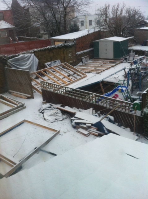

    Yet again, the snow slows (not stops) the build. Rain forecast this afternoon, and its back to it tomorrow.

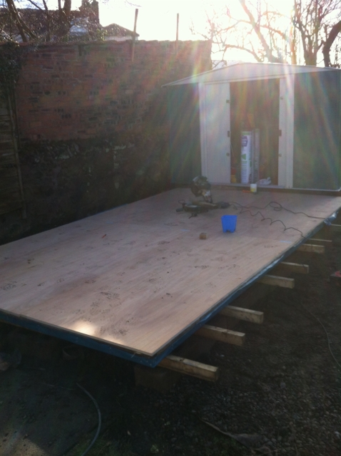

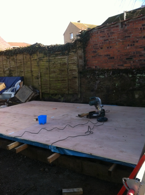

    More progress today with the workshop.
    the floor in place with the membrane on the underside to stop dampness.
Name:	IMG_0920 (478x640).jpg

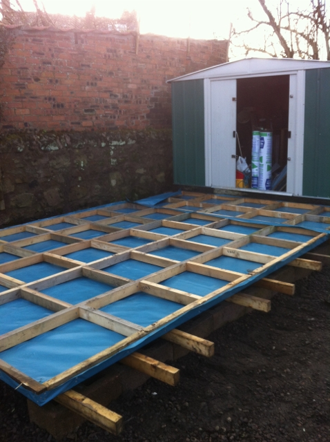

    18mm ply fitted to floor
Name:	IMG_0922 (478x640).jpg

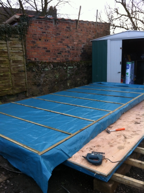

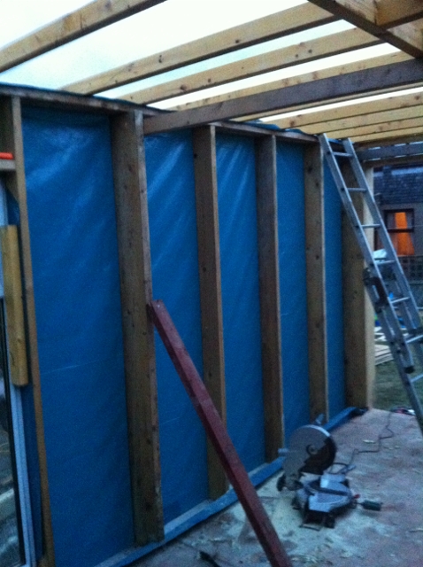

    left hand side with membrane to stop drafts and damp
Name:	IMG_0923 (478x640).jpg

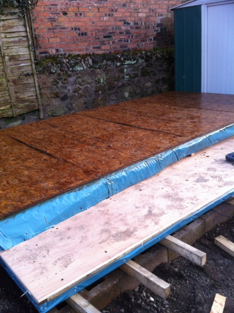

    osb fitted creosote and old engine oil appleid
Name:	IMG_0924 (478x640).jpg

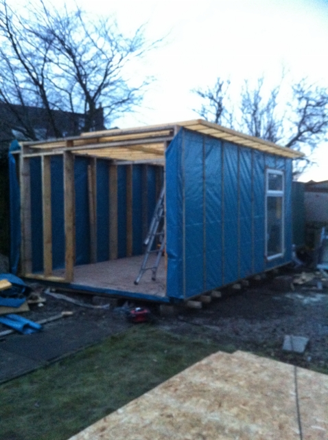

    Another day closer to completion
    window in, side up.
Name:	IMG_0928 (478x640).jpg

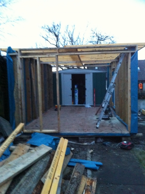

    roof ready to be fitted tomoro
Name:	IMG_0930 (478x640).jpg
    Tomorrow should see the back broken, and get all the wee bits done, then its all systems go. Oh and i,ll need to fit doors lol lol
