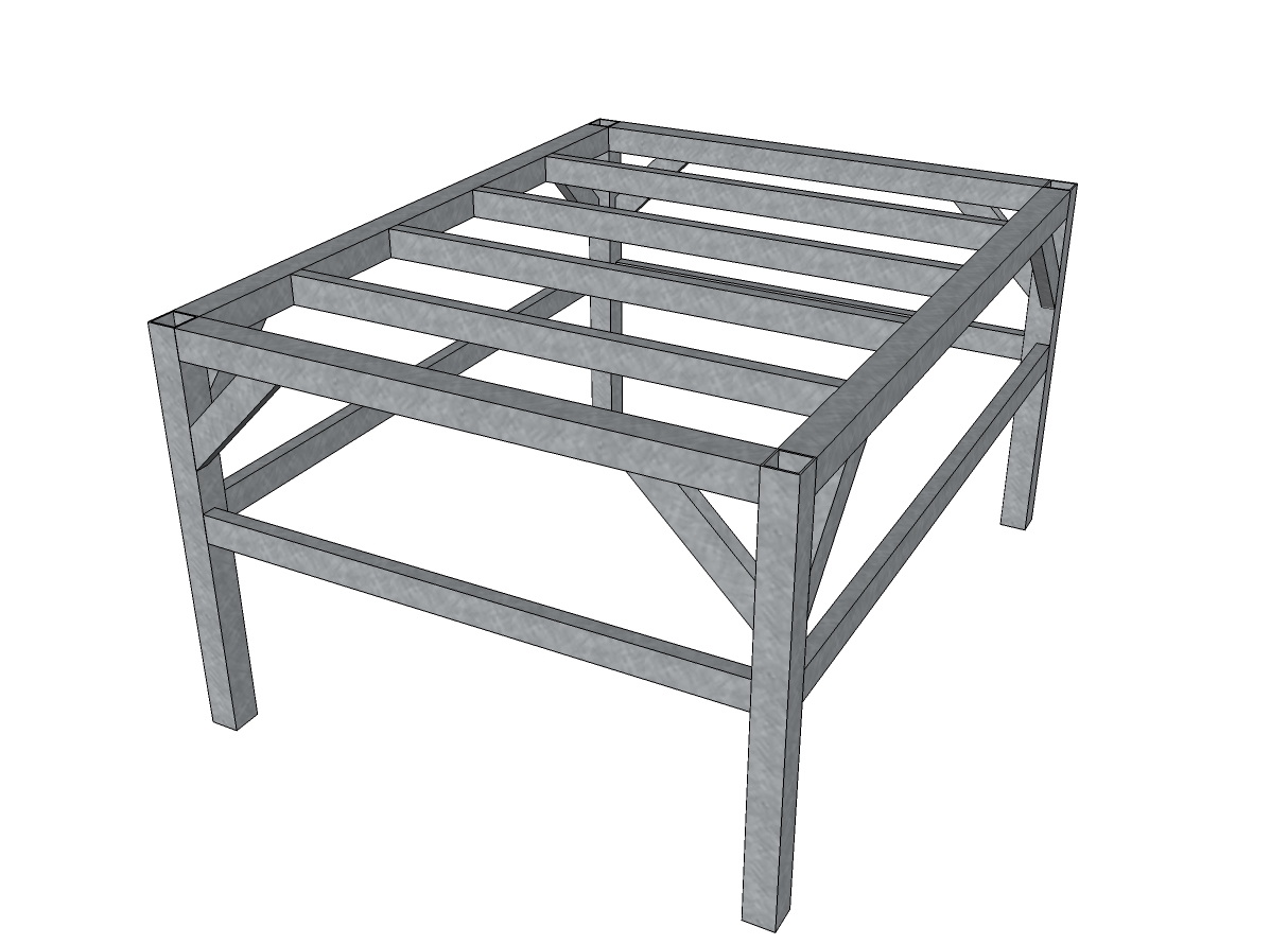

    Hi all,
    I have attached the beginning steps to building my cnc machine. I hope to make it approximately 4x3 or 5x3 foot
    Attached is the image of the metal fabricated framework, with brackets on each corner which will house the plyboard bed. There will be no top and bottom framework but only on the sides, in order to allow full sheets of boards to be cut continuously hopefully if this can be achieved). If there was framework on all four sides I am limited to that bed space. Is that right?
    Also Can anybody give any clues about what stepper motors, ball screws, router, belts if i need any? bearings, tracks, brackets and drivers I would need?
    How long would it take to make? and how difficult will it be?
    I do think the best way would be to get someone to build it for me.

    If you're going with a frame that big you'll need supporting beams under the bed otherwise you'll get deflection and vibration, cross bracing etc. I'm presuming that you're making it out of steel? Box section would be best in terms of strength, something around 50 x 50 x 4. I'd suggest having a look at Jonathan's build thread to give you some ideas http://www.mycncuk.com/forums/router...-building.html or Bruce's (motoxy) http://www.mycncuk.com/forums/router...challenge.html or one that's just starting is wobblycogs http://www.mycncuk.com/forums/router...s-cnc-mk1.html plenty to chose from ;)

    Thank you for all your replies, I have looked at all the feedback and redesigned the cnc. Please let me know what you think. If it goes over my budget then its not too much of an issue. just a few issues which I dont understand :
    (As mentioned and illustrated on the design attached)
    1) where does the driver go and how do we connect it to the steppers?
    2) what would be the best rails to use and how would I attach and make these?
    3) linear bearings which are the best to use? for the size of this table?
    4) where would the belt go?? the belt in question is it a timing belt?
    5) Also Im thinking of making the frame stand out of mild steel and the cnc bed frame out of aluminium box section. Would this be okay?
    Thank you all!
    A lot of people use an old computer case for the electronics so the Power supply, drivers, bob & any control relays would all go in the box. Connected to the motors usually with shielded cable.
    Profile rails would be the best but because they tend to be expensive a lot of people use supported rail, the rail is fitted to the machine frame with cap screws or something similar.
    I'm new to all this myself but from what I have read 25mm on the longest axis & 20mm supported rail on the other two.
    Yes they are timing belts, pulley fitted to each of the motors & ballscrews< the belt fits between the motor & ballscrew to turn the ballscrew.
    Yes that would be OK but if you are making the stand from steel why not just make the whole frame from steel. Would be more ridged & probably cheaper to construct.
