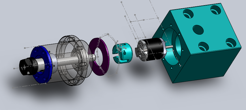

    finally recieved all the parts to start designing the spindle, pretty much whats been seen on the forum. Click image for larger version.
ID:	8129. the motor is a NTM Prodrive 35-42 1000kv unit from HK. Im targeting 12k RPM as its my bearings upper limit, on a yet to be converted ATX PSU.

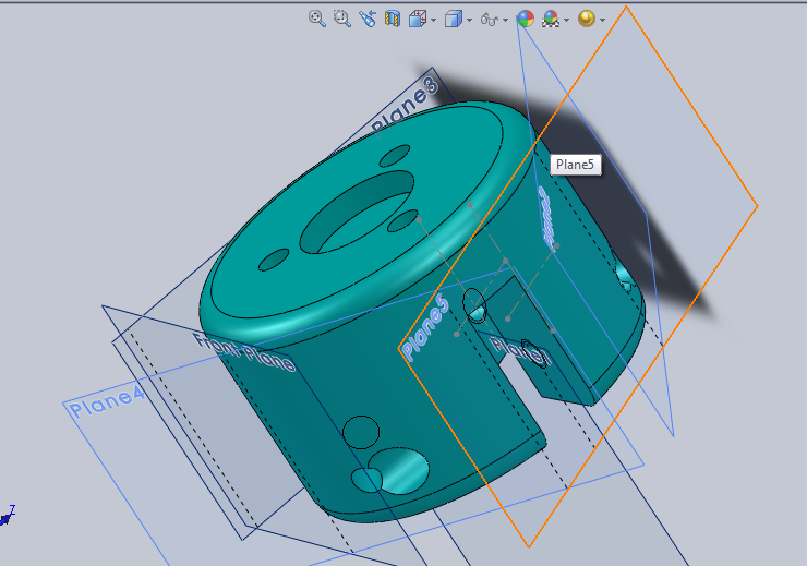

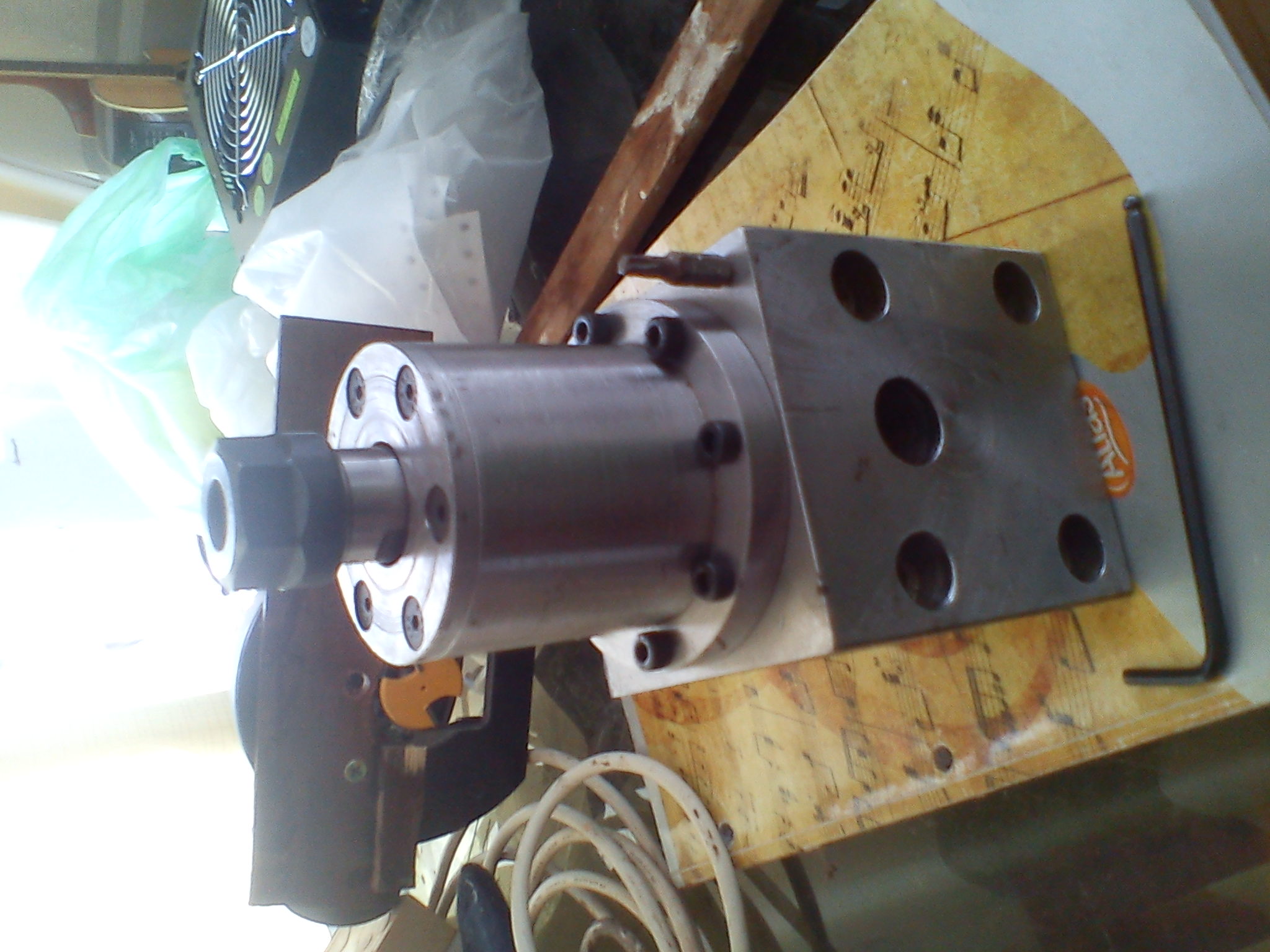

    well, i got the spindle done!.. Click image for larger version.

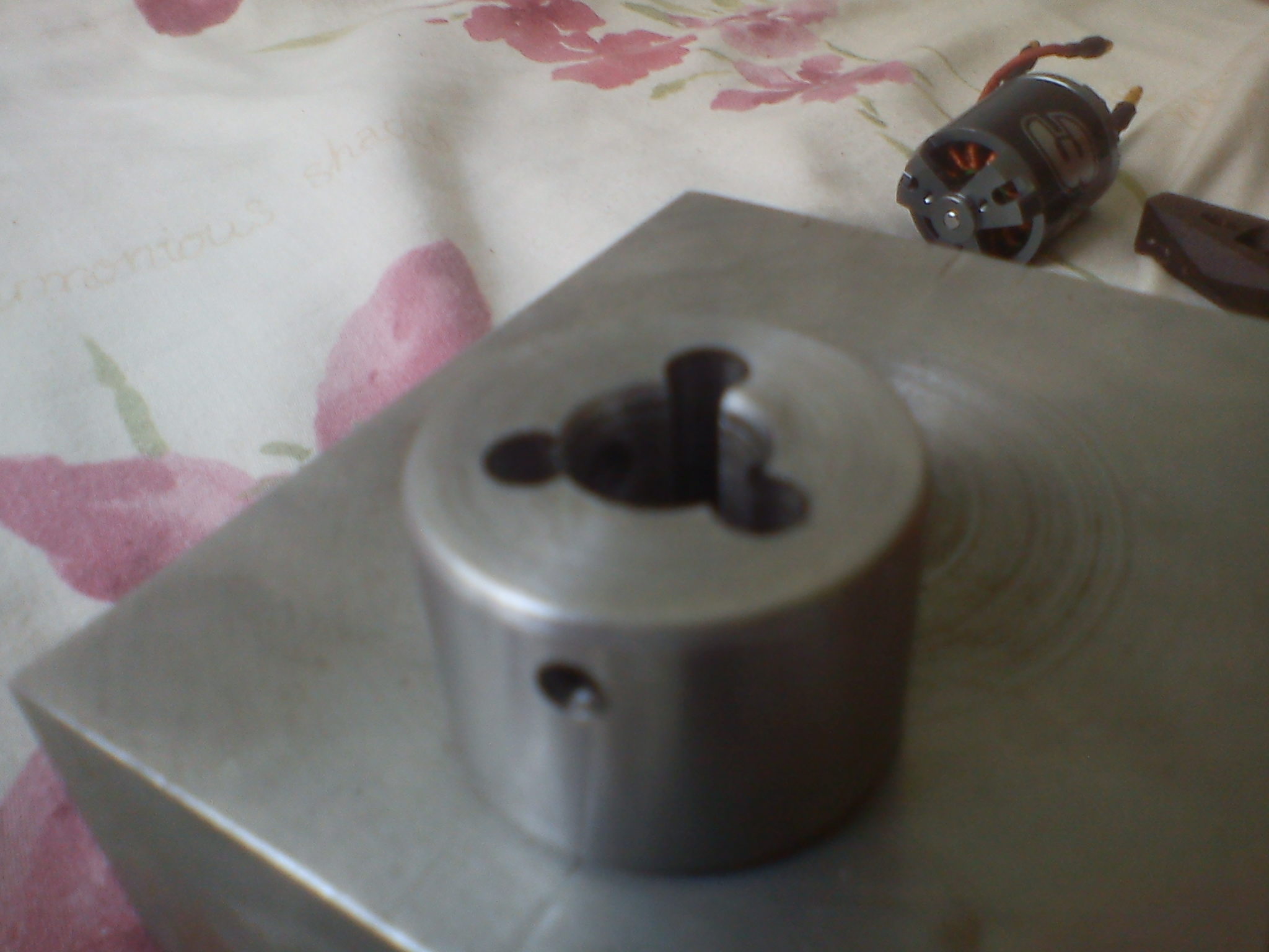

  11. #10
    a shot of the coupler, i had to redesign it to clamp the shaft using grub-screws. the entire construction is using EN19.
