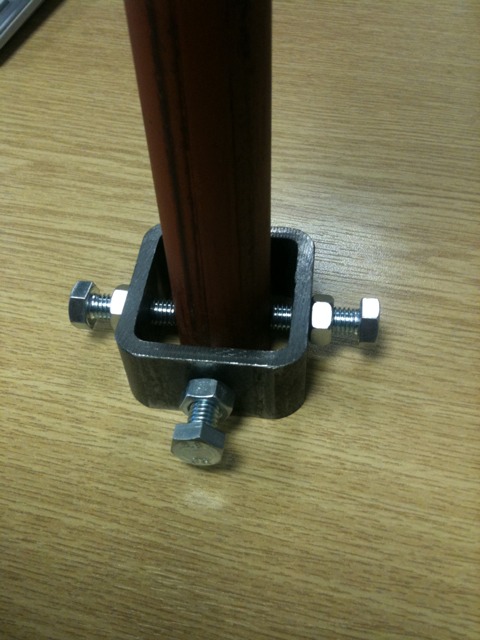

    No idea about the spiral tap, I'd guess tho that it's mostly for drilling with a hand drill. I put my tap in a cordless drill when I had 48 M8 holes to tap when I was doing some bits for my early design (which has since been scrapped)
    Neil...
