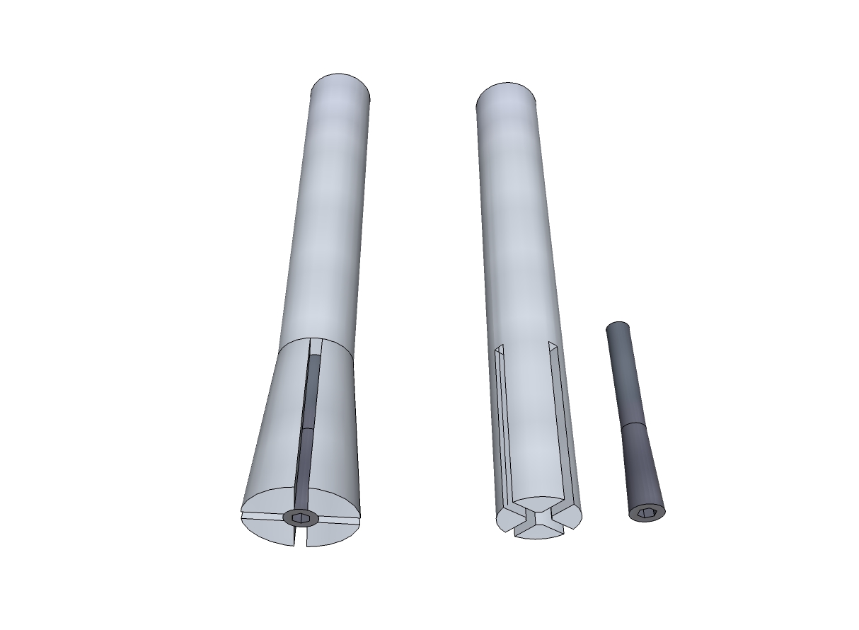

    thank you for your suggestions. I'd rather move away from the press method, as I'm a bit worried it might not be sufficient enough. I was actually thinking of something Jonathan mentioned with the parallel expansion, here's a quick sketch:
    Is it hard to machine such a thing? it should slide inside the shaft and then lock when the bolt is put it. The dia at the bottom could be 13.5-13.6mm with the 'D' shaped elements bent slightly to the inside so that it fits on the part. Putting a bolt in would push the sides out and press against the part. Main question is how strong will it hold it.
    Would it be easier to do it like this or simple cut a 'D' shaped keyway in the off-the-shelf part ?
    Regards,
    dsc.

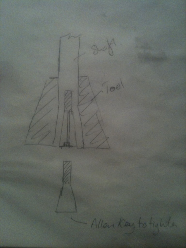

    This was what I was thinking...ish :) only a quick rough sketch...
    Neil...
    Build log...here

    Even nicer that way:) I reckon machining the shaft to be thicker on the bottom, threading and putting two cuts to form the cross should be easy enough. Or am I missing something?

    The way I saw it was to machine the shaft parallel and then the piece you thread into the shaft has a slight taper and forces out the sides to grip the piece. The shaft will need a shoulder for the piece to sit against so it doesnt just slide up the shaft. If that makes sense?
