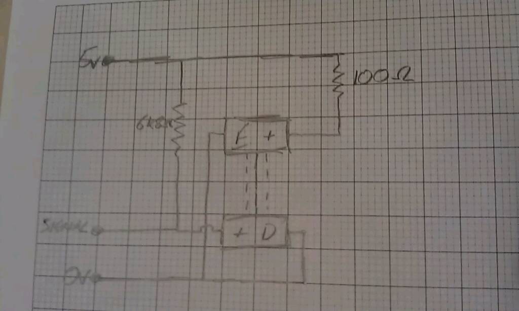

    I'm in a world of hurt trying to wire up some form of spindle speed detection for a lathe.
    I've got some Darlington photointerruptors (KTIR0121DS) which I think are the right thing for the job. I want to power them from a 5V supply, and sense the outputs on inputs to a parallel port (the PCPPS breakout board from DIYCNC).
    Can anyone suggest the right circuit and resistor values for this?
    I've made 3 versions now, and all of them seemed to work OK (swing from 0.6V to 5V when interrupted) until connected to the parallel port inputs. Once connected though the voltages were different, and only moved around 0.2V when interrupted, which is not enough to change the inputs.
    I'm clearly doing something wrong, but after 3 attempts to start from scratch and recalculate, I haven't got things running...
    Can anyone help?
    Tom's Avatar
    Here's the circuit I've arrived at. The resistance values are 100 ohm for the led, and 6800 ohm for the sensor. The signal gets connected to the parallel port.
    What am I doing wrong?:thumbup:

    i2i's Avatar
    have a look here.

    Tom's Avatar
    Thanks for that. I've bitten the bullet and ordered some Optek OPB916B. It seems the processing circuitry is included, so should make life easier...

    i2i's Avatar
    i've used his board and it works well, but all you need is the sensor and the correct limiting resistor.
    Tom's Avatar

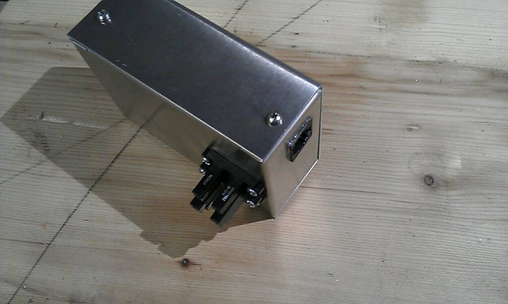

    Well, that was remarkably easy! 3 resistors, 3 sensors, a case, and an ethernet socket to carry the signals back to the control box. All working happily.
    The only problem is I fried 2 inputs on the bob during my misadventures. Are there any options out there other than the diycnc bobs?
