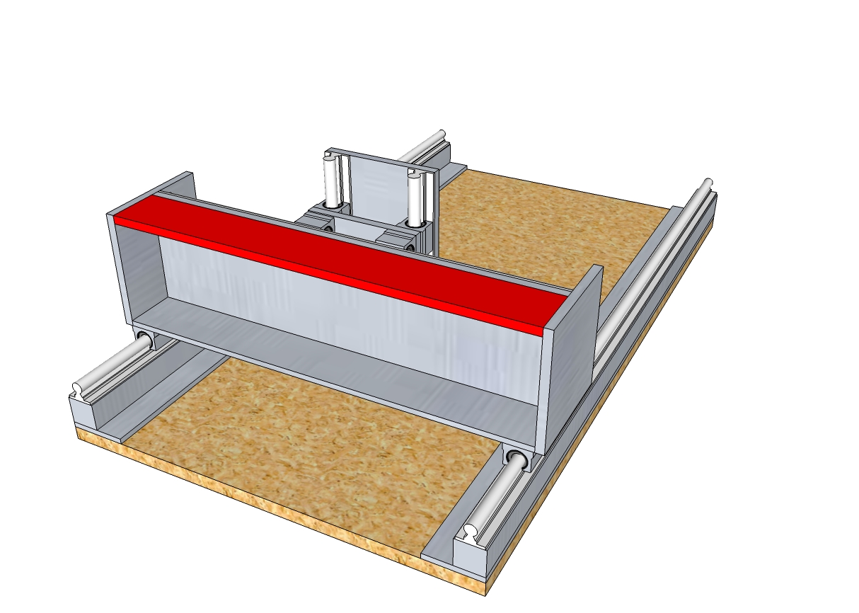

    So, here are my ideas so far:
    This clip shows how I propose to build the main gantry:
    In order of appearance:
    1. The first plate will act as a mount for the linear bearings riding on 20mm supported rails (TBR20 from Zapp) mounted to 80mm aluminium extrusion and will also act as a brace for the...
    2. ...vertical cross piece, which also has 20mm supported rails mounted to its front to accommodate the z-carriage. The hole in the arm that drops to either side will accommodate the ball-nuts. There will be a ball-screw on either side of the bed driven by one motor via a belt/pulleys to move the gantry on it's X. The ball-screw for Y motion will run in between the two supported rails and be directly driven by the motor which will be mounted to the...
    3. ...side-plate which, when bolted to the other 2 pieces, will hopefully add to the overall rigidity of the structure.

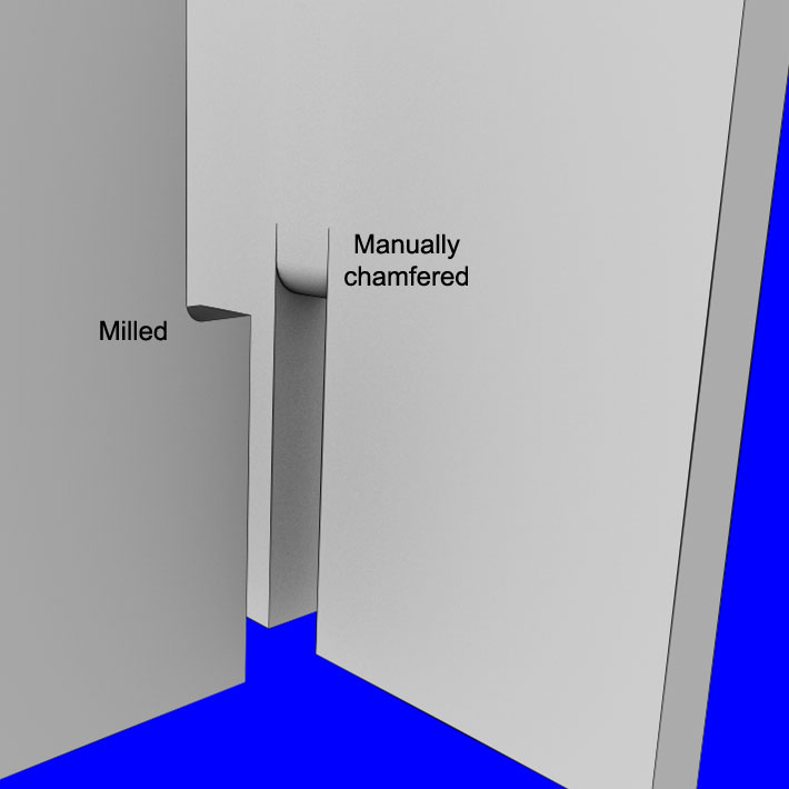

    Where there are slots cut for plate to pass through (the arm which passes through the side-plate, for example) - rather than cut this slot to be exactly 15mm wide, should I make it slightly wider (say 15.25mm) to ensure that the plate passes through okay? .25mm too much?
    Obviously there won't be any internal right-angles because the end mill will have a radius. Where there's a square edge that fouls a radius, I'll manually chamfer off the corner to make it fit (see pic below).

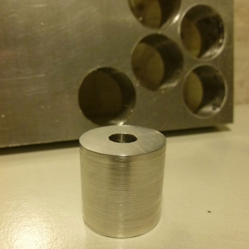

    4. 25mm x 25.4mm aluminium spacers. Hole-sawing them at the mo - Pff, long and dirty job...

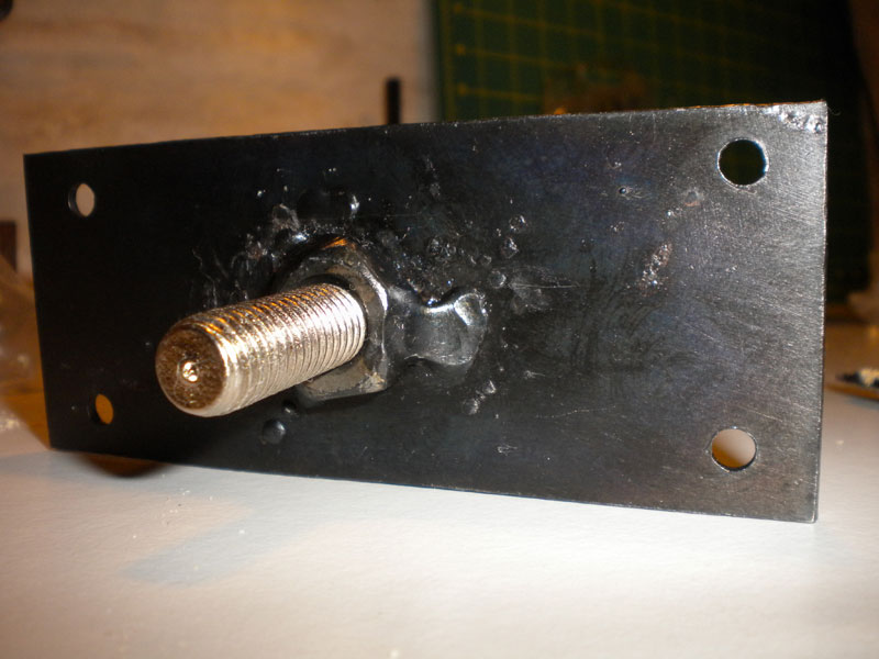

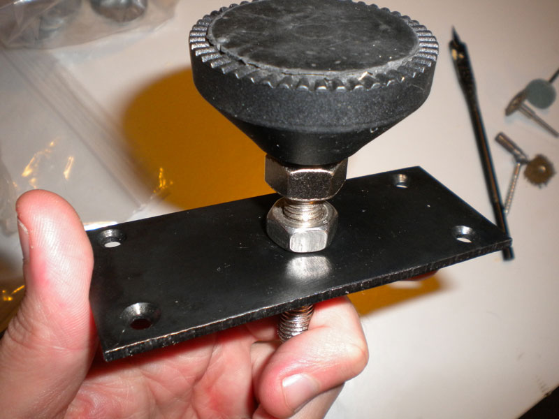

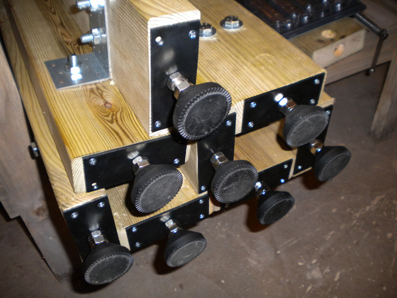

    I have some ideas about how this is all going to connect to the frame, but I'll leave that for now and get a diagram together in the near future... Same goes for the Z-carriage. Meanwhile here are some pics of the adjustable feet I made... First time welding and also had a go a bluing the mild steel plate, didn't come out too bad...

    Is there anything here that represents an alarmingly bad design decision? Or could this actually work?
    (Bear with me on the wooden legs, all will be explained...)

    Hi Wal, the single 15mm Y axis (or I think you call it the X axis) plate could do with stiffening as I don't think it will resist twisting very well, especially if the Z axis is at max travel.
    Wouldn't an easier solution to your 25mm dia Ali bits you're painfully cutting out if plate have been to buy 25mm round Ali, cut to length, mark the centre and drill?
    Maybe, but I don't have a metal saw - at least this way I can be sure that each spacer is an identical height - buying stock cut to length is always a bit hit and miss... The guide bit drills the centre hole too! Bonus.
    Yep, it's a pain - but on the next batch I'm going to try drilling a guide hole straight through, cut from one side, flip, re-align and from the other side. It's the swarf not rising cleanly out of the cut after 15mm or so of depth that's making this job a pain - flipping the piece should solve the problem. I can only hope!

    I've got a B&Q hand mitre saw which cuts Ali ok and set a stop so the lengths are identical. I'm ok as I'd use the works lathe if i was doing it but cutting my Ali for my cheap router gantry was done in this way.
    Cutting from both sides.....ooooooo good luck with that, I can never get cuts to meet in the middle doing that lol
    Do you not think that the plate that it's bolted to (which sits horizontally behind it) would be enough? When the Z is at max this is the part that's going to be taking the brunt of the forces - hmm... Will have a think.
