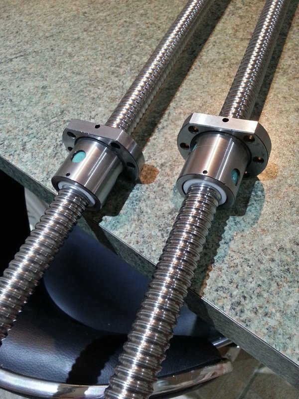

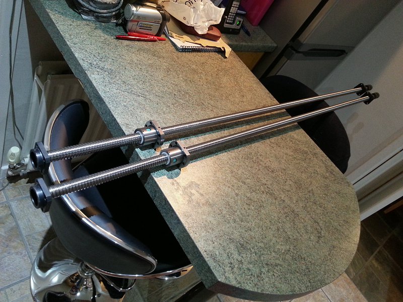

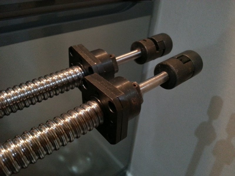

    2x RM2005 C7 Ballscrew 1450mm length and SFU2005 ballnut complete with FK (including the lock nut) and FF mounts. Also includes a flexible motor coupler with 8mm dia bore to fit standard nema 23 shaft.
    You can consider these new as although they were fitted to my machine its never cut anything. Ideal for a 4ft axis.
    Delivery is an option but will be expensive because of the weight and length. Would prefer collection if possible.
    Bargain at £60 each or £110 for the pair. You'd normally pay £200+ for these from China not to mention the chance of VAT and import duty on top of that.

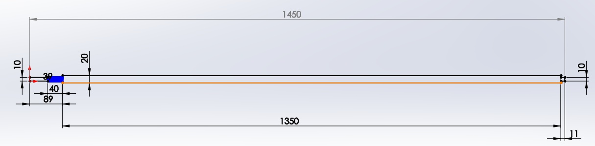

    Here's a sketch showing the exact dimensions

    And a couple of images
