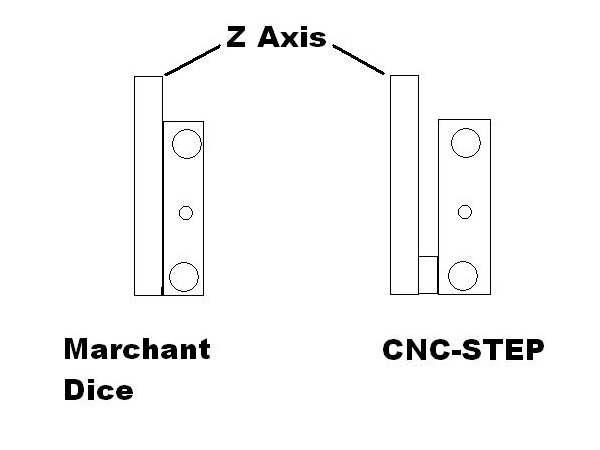

    I'm looking into buying a machine, and have narrowed my choices to these:
    Marchant Dice MDL-2-TR (This is hardware, motors, controller, software, etc.)
    http://cgi.ebay.co.uk/ws/eBayISAPI.d...m=220347108333
    (They will supply with 100mm Z-axis, extended rails, and a 4th axis, with motor, for extra)
    or CNC-Step High-Z S-400
    http://cgi.ebay.co.uk/ws/eBayISAPI.d...m=260279773244
    What I'm after doing with it is modelling in plywood, making PCBs, panel cutting/engraving, and possibly doing some work in aluminium.
    The CNC-step works out about GBP1000 more expensive when a router is added, but it looks to me like it might not be as rigid -
    Examination of the photos shows the High-Z S-400 Z axis is only attached to the Y axis at the bottom - kind of letting looks override function.
    Any advice?

    No, that's the right rail, but the z axis isn't attached directly to it. The panel that says "High-Z S-400" is in the way. The connection is by the bottom rail.
    You sure the ali block dosnt go up behind the plate and onto the other rail? how would they stop the whole thing falling forward if it wasnt on both rails.
    That's my point...
    Quote Originally Posted by No1_sonuk View Post
    The bottom runs straight to the rail, but the top doesn't. There is nothing to stop it falling forward but the strength of the fixings and material at the bottom. Under load, surely that's going to deflect.
    See attached to see what I mean.
    Now i get what you mean !, there is some talk that there is too much z axis flex after cutting past 1mm alloy on the machine.
    I think the confusion came when you edited "Heiz Z axis" to the machine name. The capital Z should have stayed. ;)
    Yup, Sorry !
