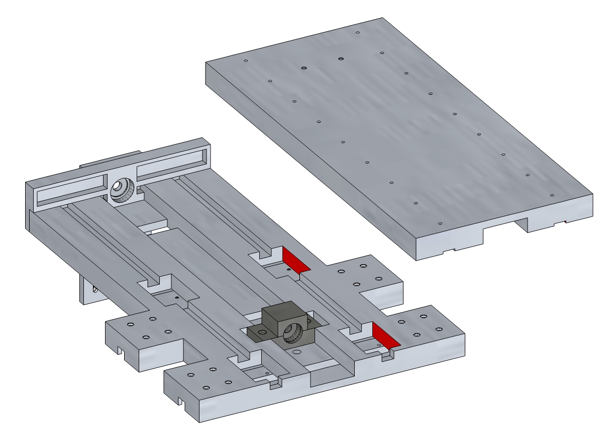

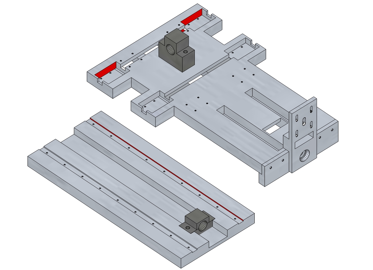

  5. #35
    Ok Ive altered the design to put in some registers (In Red) and opened the channel to allow for a standard 1605 ballnut bearing seats are all now standard as well Im going to transfer this lot to V0Carve and run the simulation to see if i get any surprises. All the bearing and ballnut mounts are now seperate and adjustable, there is ample access for Lubrication as well
Name:	backplate rev5b.jpg
ID:	7865Click image for larger version.
    You can only see one side of the registers but take my word for it they are there..
    Rick
  6. #36
    Rick simple thing but worth doing is putting the register on the first pic at the top not bottom it makes setup easier has the register sits on the bearings machined edge while bolting up.
  7. #37
    Ahhhh cheers Jazz, I had to read that twice LOL yeh makes sence now, Thats wont take two ticks as the bearings are 46 wide and the pockets were 48 so ive just moved 1 wall in 1 mm so ill move that back out and the other one in, that will still give me 1 mm free play in the pocket.
    Rick

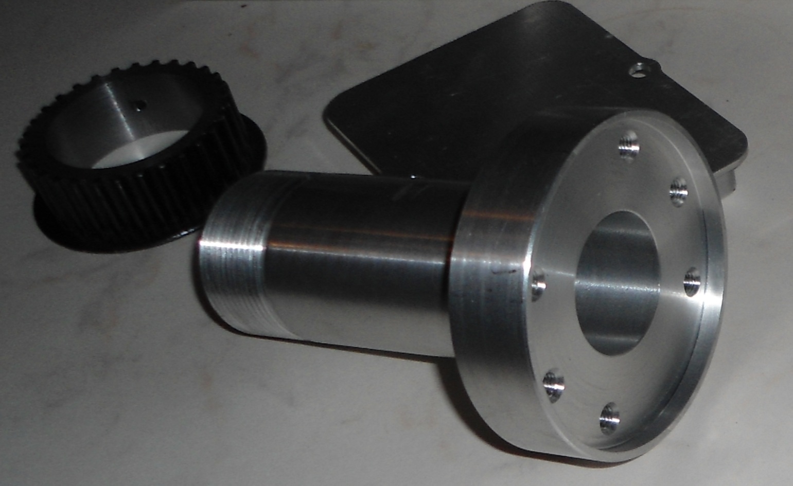

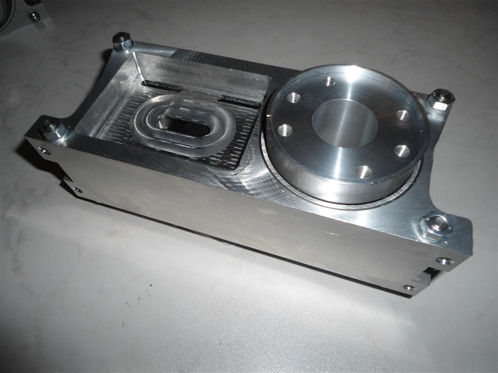

  8. #38
    Rotating nut assemblies for your X axis ballscrews are ready:
Name:	DSC00453 (Medium).JPG
ID:	7867Click image for larger version.
Name:	DSC00454 (Medium).JPG
ID:	7868Click image for larger version.

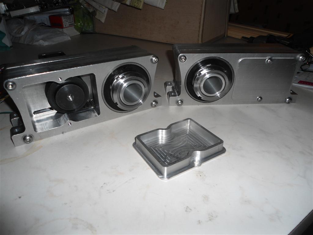

  10. #40
    Just a quick snap to add to the collection!! X axis bits.
    Rick
