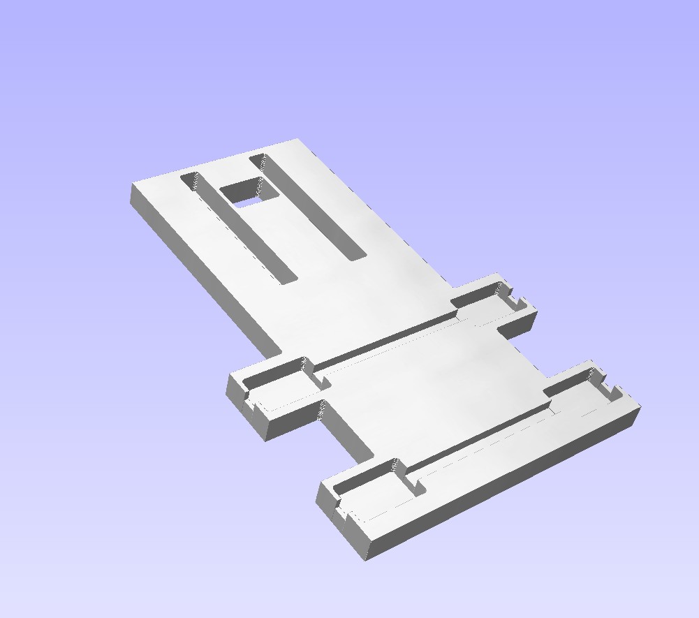

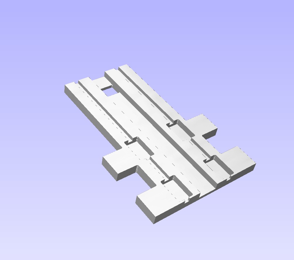

    First V-Carve Output Simulation, using 8mm Endmill, It looks so simple when you look at this picture.... Well its not.. This is just the backplate from the Y-side.
Name:	Jazz Backplate Y.jpg
    I Used the Sketchup model just for dimensions, and re-drew the lot in V-Carve, none of this fancy importing stuff, it never goes right for me..
    Rick
  2. #42
    Rick the trick is to import the 3D model then extract the edges, dump the model and the lines not required and use these for the toolpaths. . .. . . . Simplizzz
    Edit: This happens all the time. Folks ask me to make stuff and send me 3D models taking ages over making them only for me to just explode them for the 2D lines/arcs.!! . . . . .If they just asked in first place could have saved them hours. . Lol

    Jazz if you dont mind me asking, What cam software do you use to output to mach?

    I use BobCad Cam V24

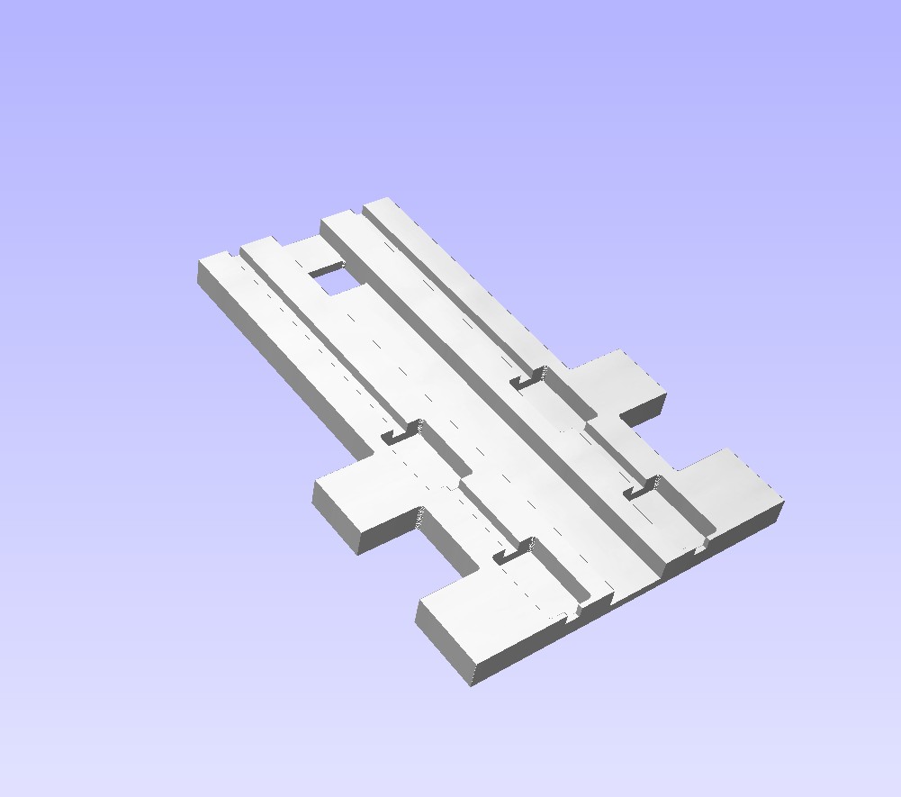

    And the front of the backplate.
Name:	Jazz Backplate Z.jpg
    Just the mounts and the motor/Screw mount now.
    Rick

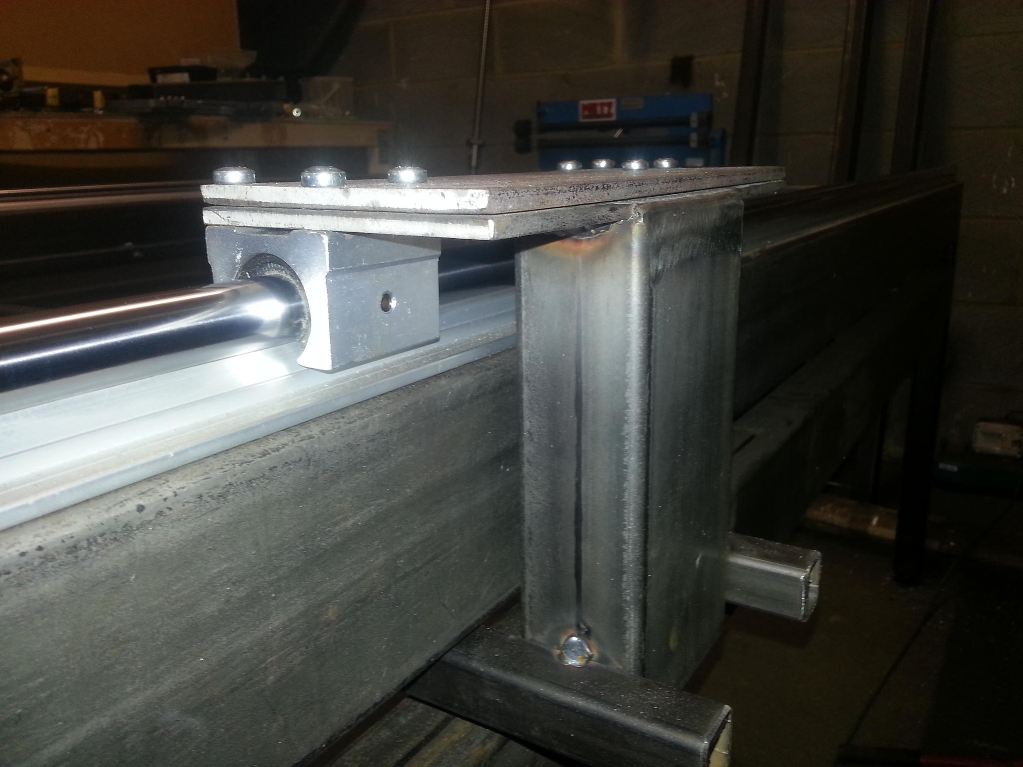

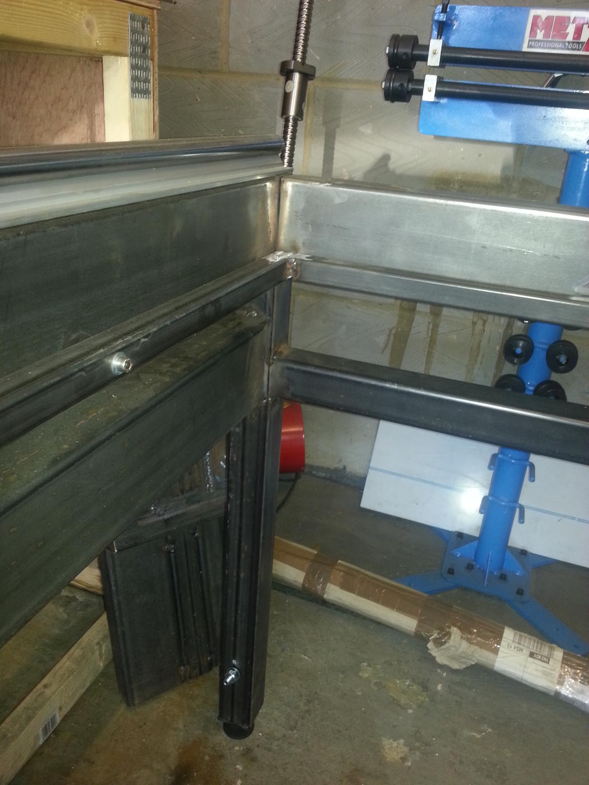

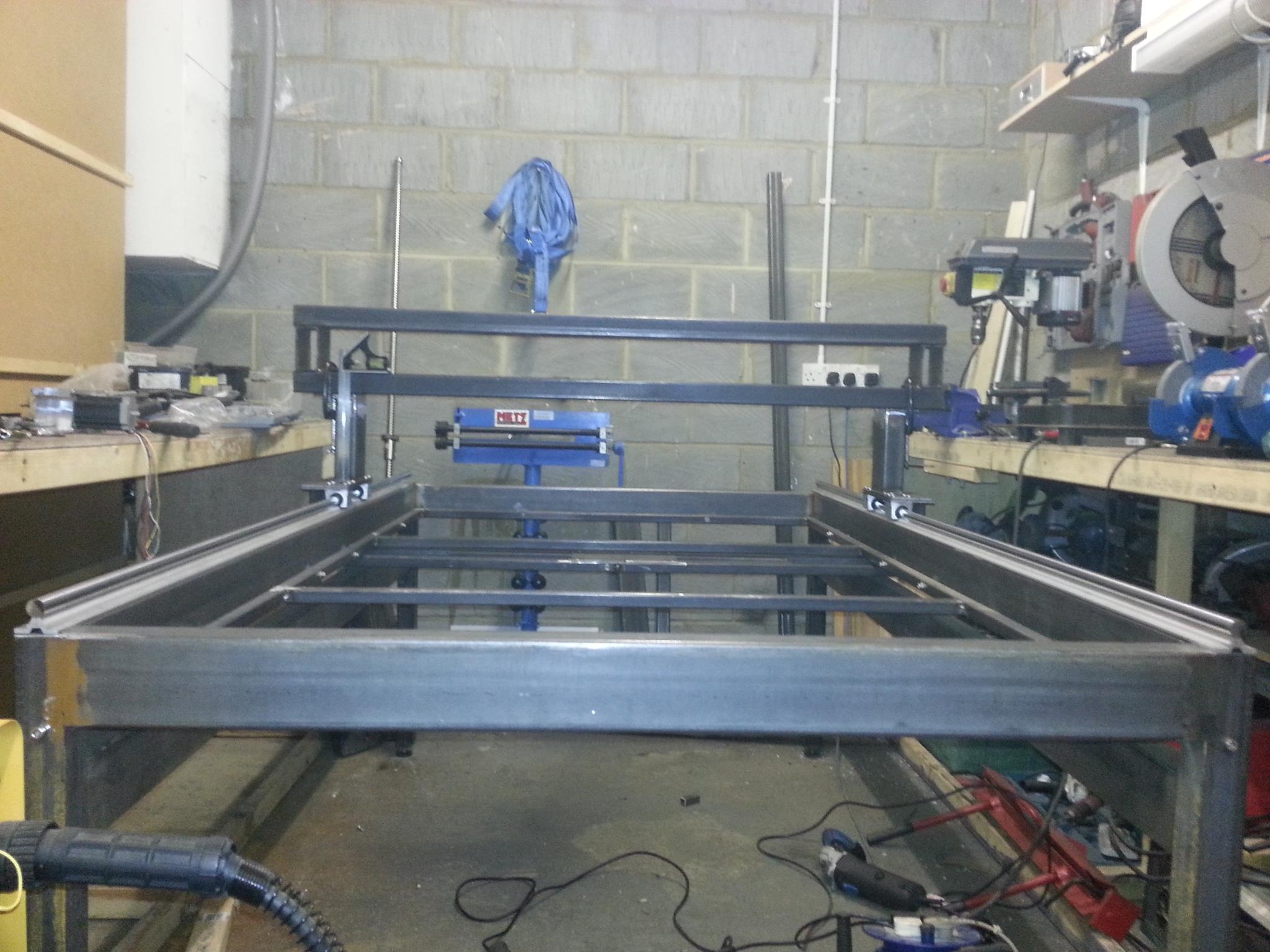

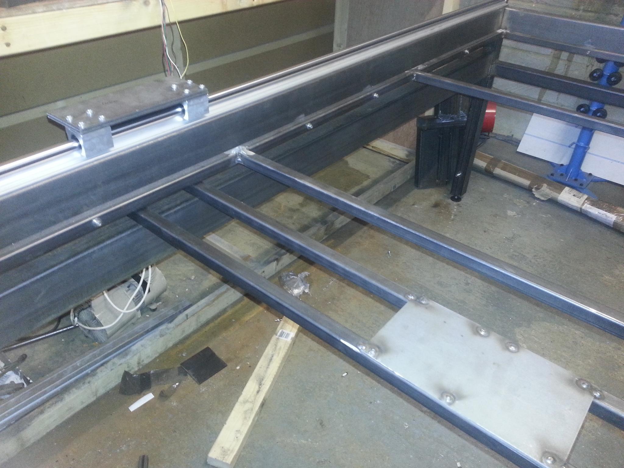

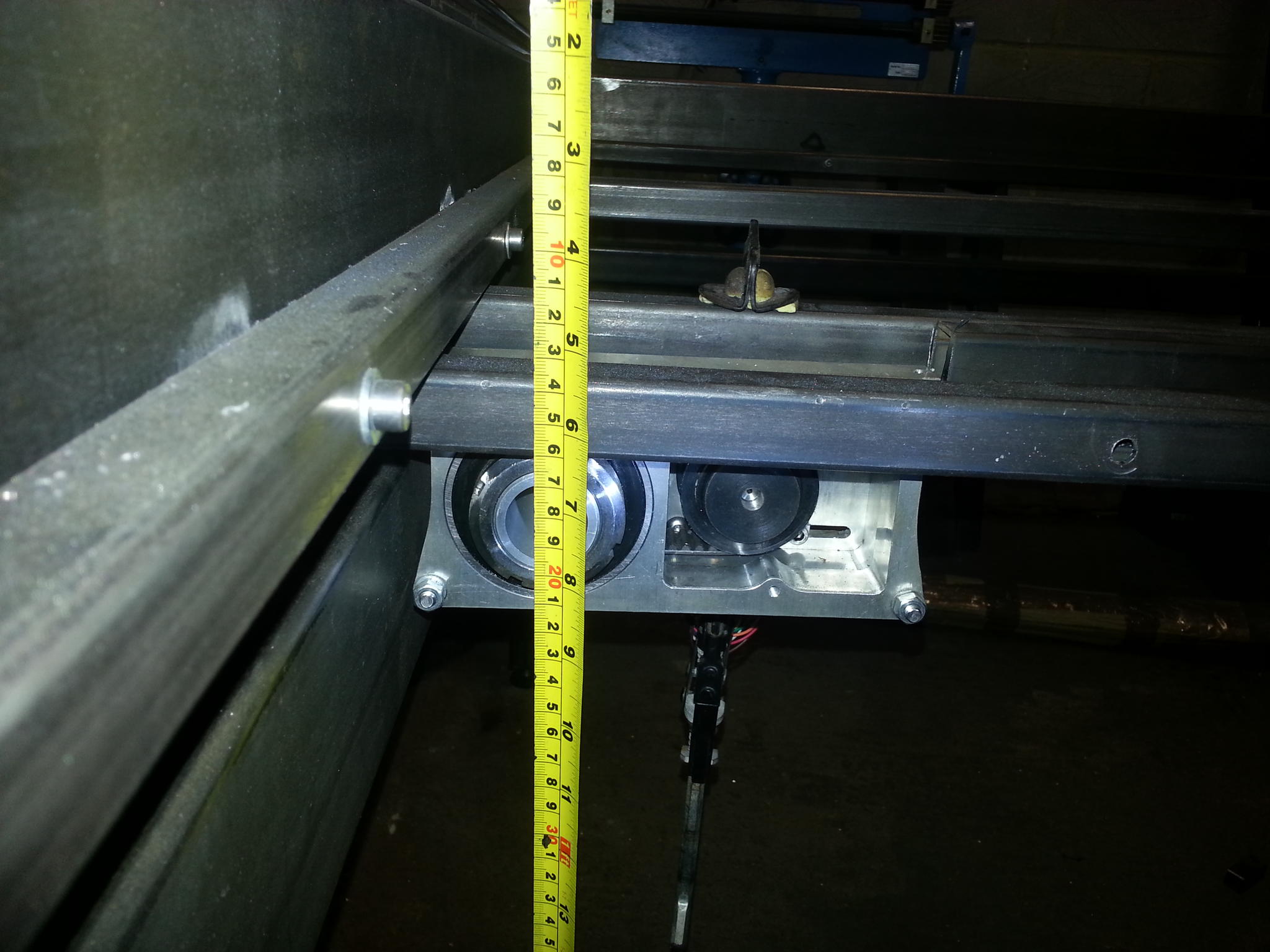

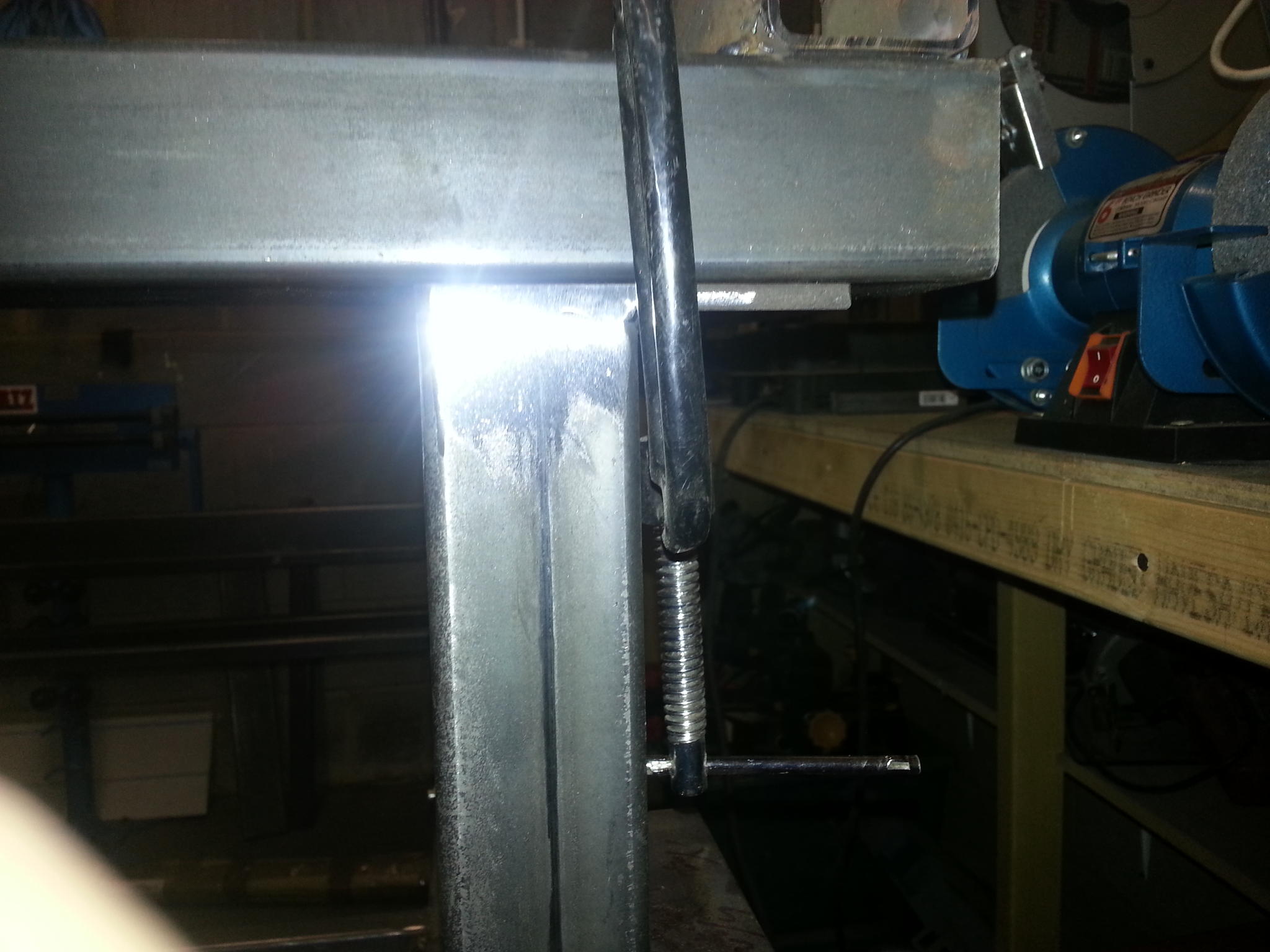

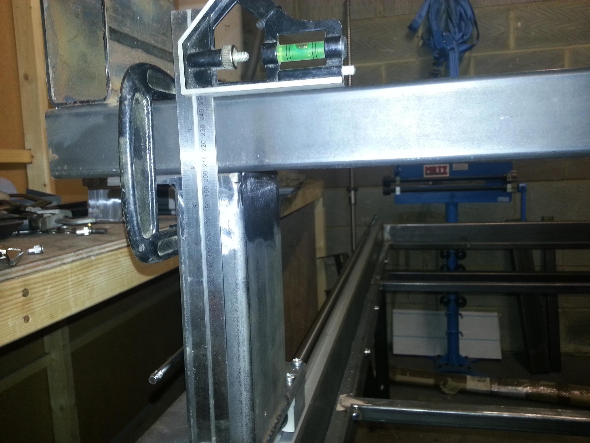

    Ok took a few pictures of the progress.
ID:	8267Click image for larger version.
ID:	8263Click image for larger version.
ID:	8264Click image for larger version.
ID:	8265Click image for larger version.
ID:	8266Click image for larger version.
ID:	8268Click image for larger version.
    Now comes the fitting of the motor assembly and X Twin Ballscrews...Hmmm Im sure that will be fun, it took me long enough to get the frame parallel..
    Rick

  8. #48
    Rick If those pieces that look like 1" box are for the bed support then it's not going to strong enough with big chance you'll get bed dipping.
    The forces when plunging and ramping etc can be high.! Even my 50mm box with 16mm Ali bed can flex when plunging into hard materials. Honestly don't under estimate the forces.!!
  9. #49
    Hi Jazz, that 1" box is going to be supporting the water bed for the plasma only. The milling bed is going to be much tougher and stiffer. There is a 50x50x3mm box section frame topped by 40x40 profile for the Router/Mill bed that is still in production, you should see that appear about mid march.
    Rick
