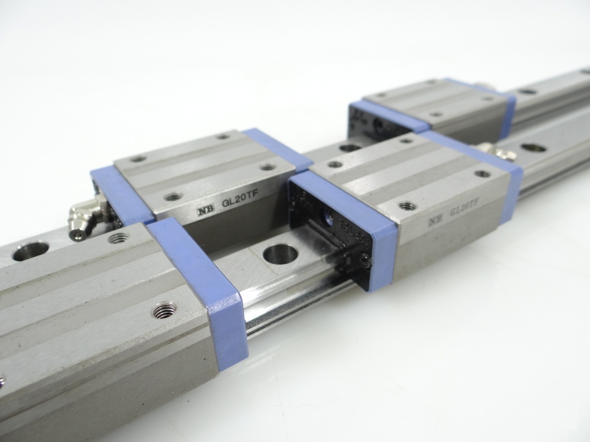

    Ok finaly Purchased the Rails for the Y Axis.

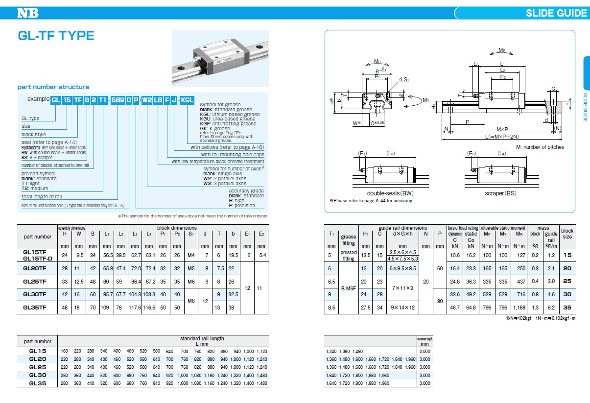

    Ive got 2x GL20TF + Rails at 1300mm, (when they arrive that is)
    Rick
    Rick
    Well this just goes to show how fast things can arrive. The rails arrived this morning thats 4 days including the weekend, and this is the second time this has happened with this seller and all the way from Korea. Well hats off to them thats all i can say, they are listed as used on the add and to be fair they are immaculate. Magic
    less than £200 and free postage as well.
    GL20TF+1300mm Used Linear Bearing NB-Nippon Bearing SR20W THK NSK LM Guide CNC | eBay
    Rick
