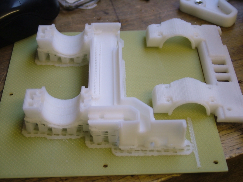

    Yes, I forgot about the heated bed. Also what goes on the heated bed! Mine came with perf board, bulldog clips and a scraper thing so you can get it back to flat for the next job. Other options seem to be paint and tape. Apparently it has to get a good grip on the bed or things go to hell in a handbasket PDQ. I haven't had any problems, yet.
    Close up pics. It seemed a bit unkind to point digi-microscope at it before I had it all figured out, but I'm not selling 3D printers so what do I care.
    3d1.jpg shows the printed item still attached to the perf board with the "support raft" still in place.

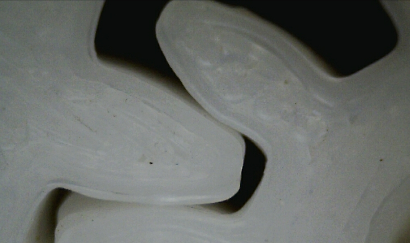

    3d1a.jpg is a close up of a gear tooth top.

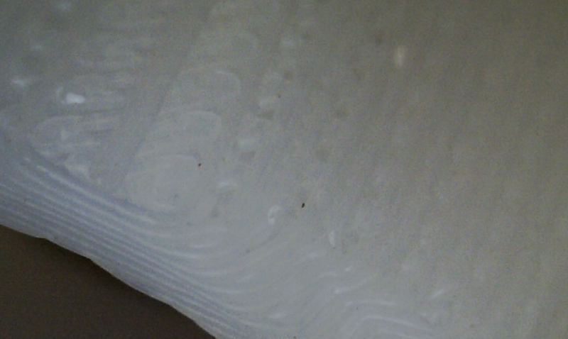

    3d1b.jpg shows a gear tooth from the side

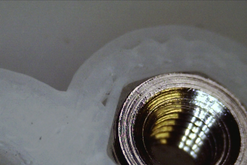

    3d1c.jpg shows an M4 spacer pushed in to a hex hole. It couldn't quite smear the plastic surface on the thin edge so you can see the internal structure.

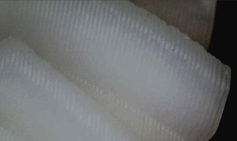

    3d1d.jpg is about as bad as it can get. This is the botttom of a 27.5mm tube resting on the bed so it is all requiring support from below.
    Edit: To be fair I should remind you that I haven't pressed the "Fine" button yet. This slows everything down so it can get more heat into the plastic. These were printed using the default settings which is reasonably quick. The big gear took about an hour 45.
