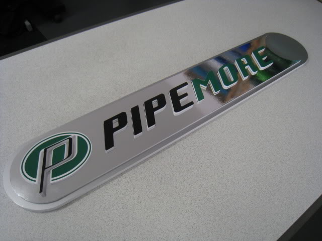

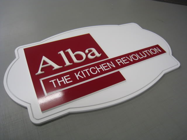

    As has been said foamex is easy to cut on a cnc machine, the images below are all a combination of foam & vinyl produced on an MDF machine by a signmaker I know.
ID:	7556Click image for larger version.
ID:	7557Click image for larger version.
