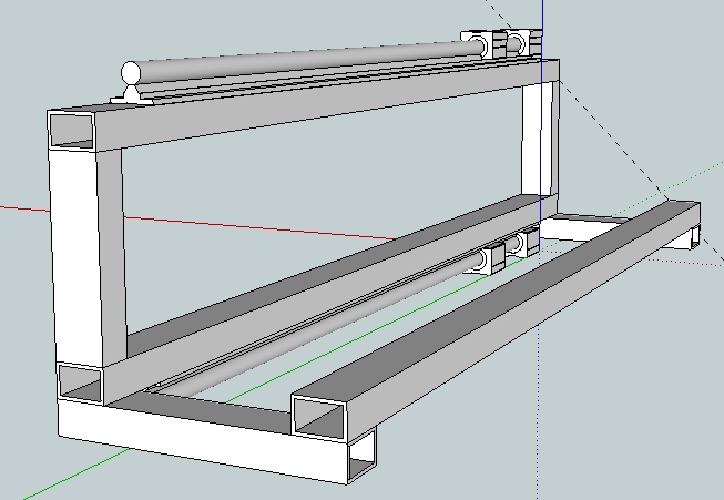

    Bearing in mind I'm neither an engineer or machinist but do have a bit of an epoxy fetish ;) I've been going through some designs of gantry and I'm a bit unsure about the feasibility of constructing something.

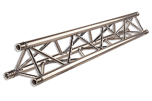

    This is my inspiration and I'm aiming to end up with something similar.

    This is the basic gantry concept without any of the supporting struts in place:
    It is 60x40x4mm steel box, 1.4m long.
    For the struts I can either use solid steel rods or steel angle, the problem I have is that using steel rod will mean welding the struts in place but if I use steel angle I will have to cut and bend the ends of it very precisely to get sufficent surface area for the epoxy joint to hold properly.
    Question 1 - is the basic concept a good design of gantry?
    Question 2 - is welding the steel rods in place really going to distort the steel, (they will only be small welds, not much more heat than a tack)
    Question 3 - Do I have a snowball's chance in hell of bashing bits of angle iron into the right shape using only a few bits of wood and a big hammer?
    Any thoughts?

    Truss is strong with things hanging from it, not so sure about applying pressure other way round.
    D.C.'s Avatar
    If you think about the design of that particular truss, it should deal well with forces in all sorts of directions I was hpoing it should perform better than an unsupported L shape gantry, big hollow box shape or a couple of pieces of extrusion bolted together.
    Or am I missing something blindingly obvious?
    Lighting truss is designed to be like a hollow box with most of the weight taken out, the chords are thin walled typically 2mm, it`s very strong in compression. As shown apex up, lights would be hung below and the forces compress the top chord.
    But as enough recent stage collapses have shown, push it in the middle and lose most of its strength.
    That`s my very basic understanding, which may not be entirely accurate, not a rigger nor do play one on T.V. ;-)

    The legs on self raising stage roof systems are truss on end, even with thin wall its very strong in compression, but tilted off axis , its a thin tube getting bent.
    The saving is in weight, early lighting truss was steel antenna tri truss, its a lot of weight to manhandle and to hoist.
    Mebbe 2D truss shape , as used by Steeldeck staging
    Middlesex University steeldeck 8x4 by Rory - 3D Warehouse
    again its used to reduce weight for a given strength, if weight is less of a concern apart from moving the mass of the gantry and possibly damping resonance?

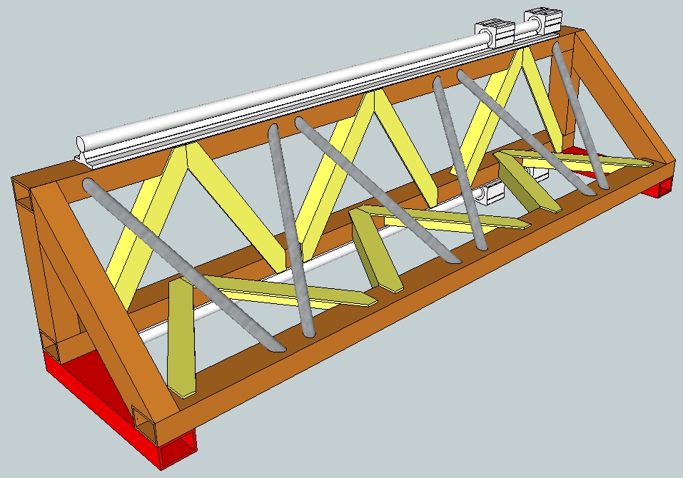

    This is the gantry with the supports added, it makes it a little easier to understand what I'm suggesting (the view is from the rear side):
    The red box section will be mounted to some SBR rails, the orange box section forms the main parts of the gantry, the yellow bits are struts made from steel angle and the grey bits are 10mm steel bar.
    Edit to add, click the piccy for a larger view.
