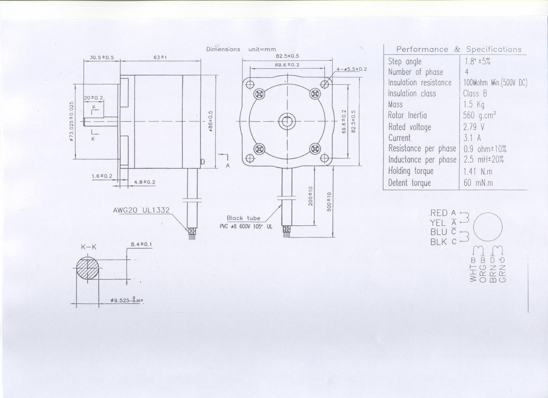

    I make all our prototype speaker cabinets with it, MDF 12 to 25mm and Ply Wood. I also made a special attachment to enable us to dial gauge and mill the flats on the frame that the bed sits on, the Kress cut steal no problem with a carbide cutter and lots of water with quite a fine cut depth obviously! (The exciting video of it is on Kress 1050 Mill cutting steel on a wood router.avi - YouTube, note the special jig i made in the video too ) After doing that i then milled the bed back to flat with the same fitting, its accurate to about 0.15mm now, it was over 2.5mm out when we got it. I changed the X, Y motors to Astrosyn MY257's, David @ Astrosyn was extremely helpful finding me nearly exact equivalent, they are just twice as powerful and take half the current of the old ones, it was a pleasure to do business with them .

    Stuart, those motors are still a little on the small side for me at 1.4 Nm. The nema 23's I've got & will get round to fitting at some point are 3.1Nm. Original motors are 150oz which is just over 1Nm.
