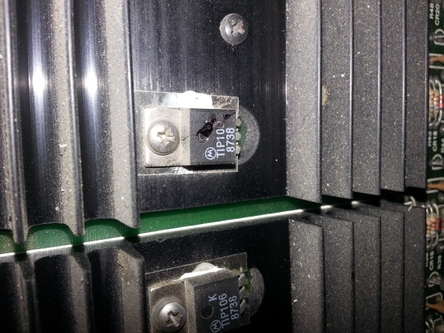

    Well good news, I replaced one of the rectifiers and low an behold the 2 24vdc LEDs lit up but not the mill on one. But I still can't control the X,Y with the control panel. Also I'm probably doing something wrong when I try to push a design to the machine even thou the panel says start ready. But there is some bad news as well there are a couple semiconductors with cracks, would it be worth trying to replace them? Pics below.

    Is there a way to test the contactor?
    Also I figured out what the unconnected wires went to, went to a plug on the side rail under the machine. I'm guessing to plug the power supply in for the control panel. Thou the plug isn't a standard US AC outlet.

    Apply 24v to the coil and see if it slams shut? Contactors are not that expensive these days so maybe worth swapping out anyway. Being the way this thing seems to have popped all over the place, check for any leaking caps.

  11. well the TIP transistors are only a few pence so its only time n effort to swap them out. however that's a pretty catastrophic failure so cant help wondering what else has died... law of diminishing returns applies...
