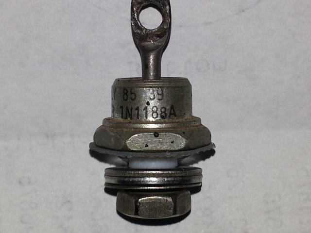

Well I finally got back to the guys shop and removed the rectifier. Ended up going to the next big town and stop at a supply house and picked up two of them for 16$, $8ea. so not to bad. Now all I got to do is get back there tomorrow and resolder them in and replace a couple of the wires and connectors that are corroded.
Then cross my fingers and hope that's all it needed.
Thanks again Martin! I'll let y'all know sometime around noon what if anything happens. Hoping for those other LEDs to light up.

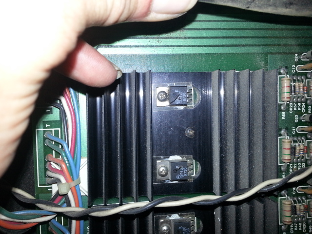

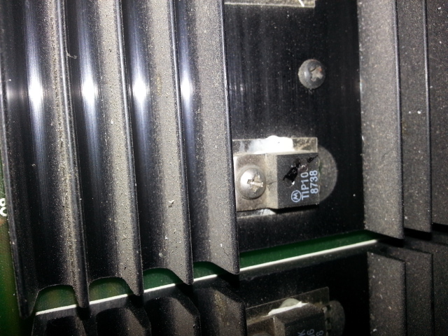

but not the mill on one. But I still can't control the X,Y with the control panel. Also I'm probably doing something wrong when I try to push a design to the machine even thou the panel says start ready. But there is some bad news as well there are a couple semiconductors with cracks, would it be worth trying to replace them? Pics below.

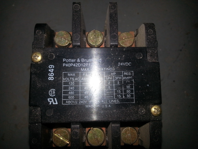

Is there a way to test the contactor?

Apply 24v to the coil and see if it slams shut? Contactors are not that expensive these days so maybe worth swapping out anyway. Being the way this thing seems to have popped all over the place, check for any leaking caps.

I'm not sure on your definition is for inexpensive,but I just checked Allied Elec. and they want $119, which may not be that much but it's been replaced once already. That was a pic of the old one setting off to the side. So now I just need 24v to test it. Thou when I was tracing the wires, the routers power ties into it and well the router should be 115v ac.
I'll be there tomorrow so I'll retrace the wires.
Also I should be able to test the power going to the motors right, the A+,A- etc.

well the TIP transistors are only a few pence so its only time n effort to swap them out. however that's a pretty catastrophic failure so cant help wondering what else has died... law of diminishing returns applies...
