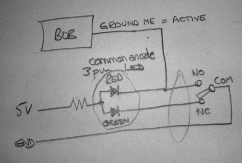

    Does anyone have a circuit diagram to wire Limit switches in parallel with LED indication of actuation?

    Hi
    Thanks for the reply, my apologies for the lack of substance, but in my defence, i am new to this world of CNC.
    I intend, hopefully to install "Maximum Travel" limit switches to the X,Y & Z axis of my Hobbymat Milling machine, which i am currently converting to CNC control.
    The Stepper Drivers are PM 542's and a ZP5A-INT Breakout Board, it looks like there are I/O's for 3 limit switches and a "E" stop on the Breakout board.
    It would be nice to have a separate box containing the LED's and there corresponding resistors, which obviously would give an immediate visual indication as to which switch is made.
    I understand so far that the Switch cables should be shielded, and the switches should be NC, i am not sure of the exact volts and current from the Breakout board, as the paperwork is not very user friendly.
    If possible, it would be nice to have Green LED's that turn Red when the Limits are made.
    Would i need Hard wired Limit Switches for "HOME " positioning, or leave this for Software SETTING?

    Quote Originally Posted by manofgresley View Post
    I'll have a guess then

  9. #8
    Problem here is that really you want limit switches wired Normally closed and active low so if a wire breaks the signal drops, machine stops because it's no longer safe.
    Also to save inputs you'd have them wired in series. Which surely means each LED will need it's own supply to be of any use has an individual switch indicator.?
    In Mach3 Limit Home switch's can be used has home switch's if needed.
    Without limit switch's set has Home switches or individual home switches then the software can't be used to home has it doesn't now where to home too.? Instead the software just zeros out the machine coordinates where ever the gantry or moving table is rested.
    Home switches are very very useful and I'd drop limits before home switch's any day.
    Okay, attempt #2...
