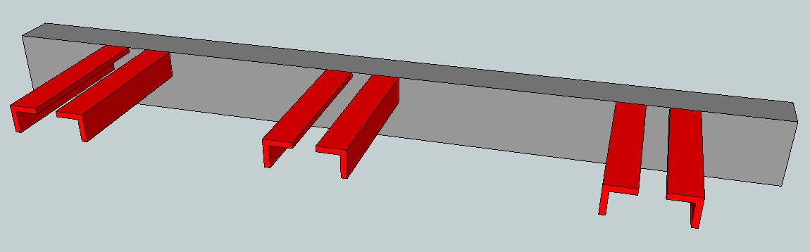

    I was intending to fit some t-tracks/t-slots whatever you call them to my machine but they all seem horribly expensive.
    The cheapest I've found is alu ones from axminster here:
    Buy Axminster Universal T- Track from Axminster, fast delivery for the UK
    But that costs about £8 a metre.
    Is there any reason why two pieces of steel angle welded to the frame like this spanning the width of the frame wouldn't do just as good a job for 1/3 price?
    Surely this would also give the added benefit of a bit of extra bracing to the frame aswell. Is there a 'standard width' for t-slot tracks so that any fancy attachments I might buy in the future will fit?

    Yep will work dandy if supported in middle but the cutters won't to impressed when you cut thru the bed. . Lol
    My slots are 45mm centres.
    It would be convenient to design it so you can use a set of milling clamps:
    RDG Tools - Online Engineering Tools Metric Clamping Kits
    They're exceptionally useful.
    On my router I got hold of some aluminium box section 3/4 inch square and cut a slot 1/4 wide in one side on the bench saw. Works real well

    Thanks Lee that seems quite good but I would still be clamping against 2mm alu instead of 4mmor 5mm steel and the base of the table would still need extra steel to support it.
    Threaded rod is dirt cheap, less than £1 a metre from screwfix (as are a few wingnuts) to make holddown tools from so I'm really struggling to see the advantage of using very expensive t-slot. The only possible advantage I can think is the fact that t-track prevents the hold down thread from droping out the bottom whereas the steel angle allows clamps to fall down through them and need retriving underneath. This can be designed out by making a decent clamping system however so it's not really a big problem.
    I think the big problem is the one that Jazz raised of of knackering bits by driving it in to the steel due to acts of sheer stupidity. I suppose I could rectify this by making sure this amount Z travel is impossible for spindle to accomplish, I'm intending to put 1 1/2 inches of MDF on top for a base so no cutter has any legitimate business traveling down that far, if I make it physically impossibe for the machine to that the problem disappears.
    T slots are meant to speed up the positioning of work.
    Another way to do it would be to make a plate with threaded holes on a grid pattern, you could get your machine to do the drilling and possible the tapping aswell!
    It all depends on what your eventual use will be, as long as a piece of string - as they say!
    Peter

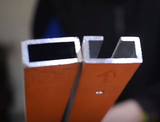

    You might consider using square 3/4 inch aluminum tubing. On your table saw cut through near the middle of stock the flip and run the other side till you have a slot that would accommodate your hold down.Click image for larger version.

    Quote Originally Posted by PoorJohnn View Post
    Good idea John so simple but quite effective I bet, you could use a thicker wall to make some "beefy" ones as well, have you got these installed on your machine?
    Thanks for sharing and welcome to the forum!
    Not yet but I have been working on a frugal means to upgrade my Table saw & router. Found this on You Tube and the idea stuck
